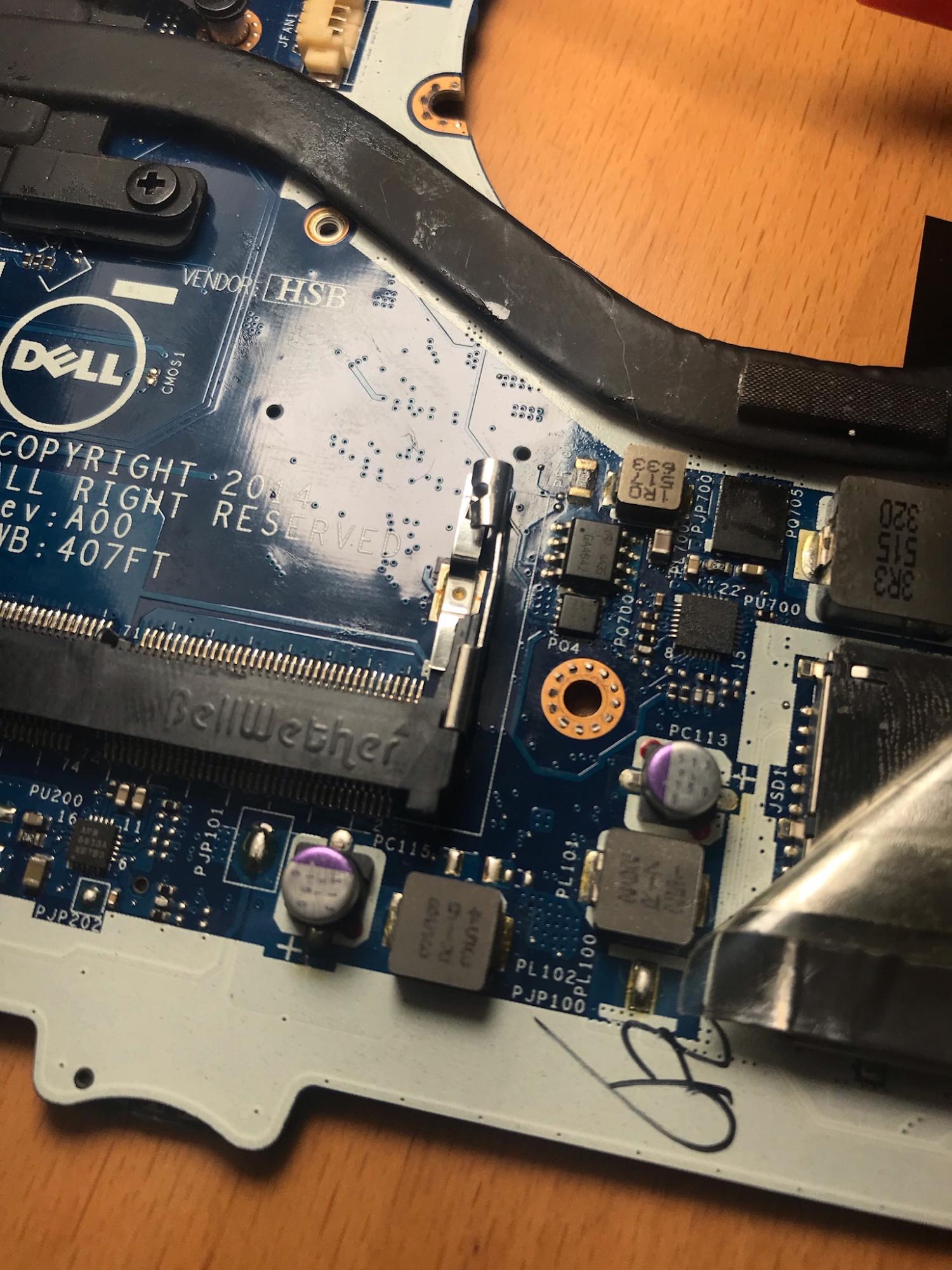

    I just got a pretty nice Dell Lattitude E7450 laptop from a friend to try and fix. When the charger is plugged into the laptop, the light on the adapter immediately goes out. I disassembled it and took the board out. I put 3v to Vin at charge port and found that mosfet AO4435 was getting hot. That was the only component I found to get hot and there are no signs of damage to this chip or any component . There are also several caps that are grounded on both sides when testing for shorts but I can't tell if this could be by design, due to the bad mosfet, or other condition. Question is, how likely is it just this chip or should I be looking for other bad components?

                    These are all the square inductors I found on top of the board. Did not find any on the bottom:
                    • Inductor readings:
                    ○ PL500 = 65.5 Ohms
                    ○ PL700 = 0.2 Ohms
                    ○ PL701 = 4.6 Ohms
                    ○ PL101 = 3.69 Ohms
                    ○ PL102 = (constantly moving, draining from 500k Ohms down and back up again)
                    ○ PL200 = 446 Ohms
                    ○ PL301 = 1.9k Ohms

                                I can't even find PU800 on the board. I'm starting to think the schematic does not match my board. I will try the above again powering for a longer time. But I think I'm going to remove PQ700 which is the AO4435 mosfet.

                                  If you can't find PU800, try looking at the small black IC that has the following label: CD3301 (a quick google search should show you how it looks like).
                                  Post a picture of your motherboard reference so we can crosscheck if its the correct schematic.
                                  Removing PQ700 won't help much since it is just an input protection mosfet. You can try though. I have a feeling it might be the PU800.

                                    I do see PU800 now. It does not seem to be getting hot. Only thing getting hot is PL701 near Pl700 after some time. Not too comfortable with removing PU800 though. I'm going to keep testing.
