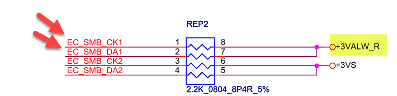

    hi bro I hope someone can help me on this lenovp gr0 45 nm-a281 rev 1.0 mobo, i.e. voltage loss of 3v and 5v on PL 401 and PL 402, this is BQ737 measurement when connected to charger
    ACIN PIN1=18.71v
    ACP PIN2=18.72v
    CMPOUT PIN3=0v
    CMPIN PIN4=0v
    ACOK PIN5=0.36V
    ACDET PIN6=2.44v
    IOUT PIN7=0.3v
    SDA PIN8=0v
    SCL PIN9=0v
    ILIM PIN10=0V
    BM# PIN11= 0v
    SRN PIN12=18.72V
    SRP PIN13=18.71V
    GRD PIN14
    LODRV PIN15=0V
    REGN PIN16= 0.33V
    BTST PIN17=18.37
    HIDRV PIN18=18.71V
    PHASE PIN19=18.74V
    VCC PIN20=19.10V
    Thank you, I hope my colleagues can help me.

    Post all voltage on PU401 and PU402 buck regulators.
    These are intended to be always on regulators.

      This voltages are wrong/low..recheck your measurement
      ACOK PIN5=0.36V
      ACOK PIN5=0.36V
      REGN PIN16= 0.33V
      And post voltages of the 2 first mosfets = drain , gate and source

        His problem doesnt seems related to charging IC. 3V LDO is not generated as SDA/SCL pins are all zero. So the problem is 3V pwm regulator.

          Yup. OP has not replied with the requested voltage checks.
