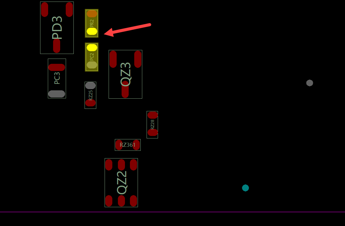

    this board doesn't power up at all. there is a 1 ohm resistance to ground on +rtc_cell. 1v was sent through the rail and the sio (mec5105) got warm. The sio was iremoved and the short was gone. It was replace with a new sio and the short is back

    Re: dell latitude 7490 la-f322p short on +rtc_cell
    See attached.

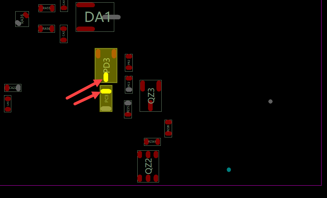

    Locate the PC3 cap that will be mated to the common cathode of the dual diode @ PD3.
    Remove all power. Meter in resistance mode.
    Red meter probe on the location in the attachment.
    Black meter probe to ground.
    What is the resistance to ground ? Is it 1 ohm ? If yes, remove capacitor PC3 off the logic board and measure again.
    Next check the coincell +v location in the next attachment.
    What is the resistance reading to ground for this junction ?
    Is it 1 ohm ? If yes, remove the PC2 capacitor off the logic board and measure again.
      pc3/pd3 with the super iO removed reads open loop. I put the super IO back on and it reads 1 ohm. the resistance of the coincell +v is open loop regardless of the super IO being attached or not. why would a brand new sio cause the +rtc_cell to short
                could it be the dual diode? the super IO seems to have low resistance to ground even on a working board
                  Remove the dual diode and test it out of circuit.
                  In diode mode, should conduct in one direction and block in the other. Test each internal diode.
