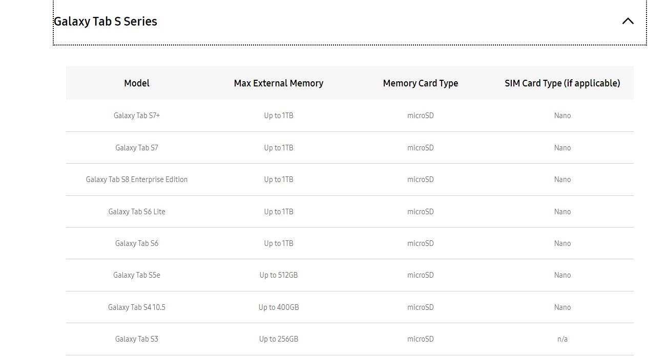

                  R u sure that it should support 128 GB cards out of the box?
                  No clue. You can confirm with Samsung or review their documents.
                  Are you finding that the fault is with the 128 GB cards ?
                  See attached. This is from the Samsung website. Do you have one of these models ?
                  • paparazzo79
                    • Dec 2018
                    • 298
                    • Bosnia
                    Re: microSD card issue with Tab S
                    Nooooo, I'm poor, I have Tab S model SM-T800.

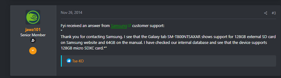

                      • mon2
                        • Dec 2019
                        • 13930
                        See here:
                        https://forum.xda-developers.com/t/m...-10-5.2952054/
