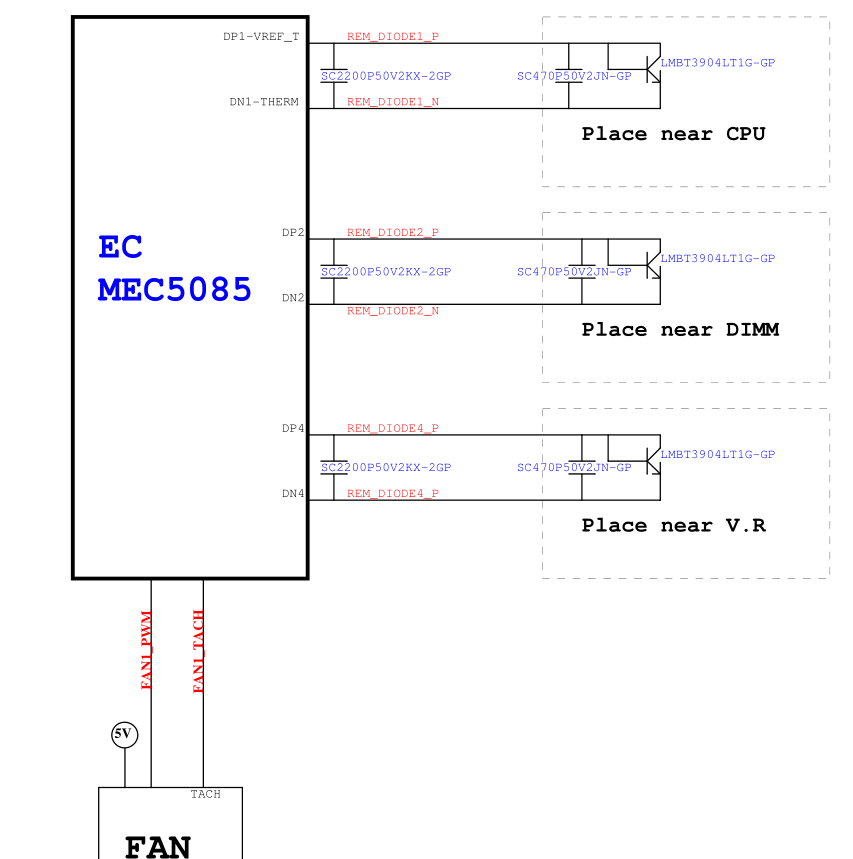

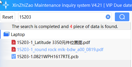

                    Re: Dell Latitude 3350 mb: RoundRock MB 15203-1 JM7HC REV:A00 The fan is not working
                    Ok. Found this cryptic labelled schematic in the database after searching assorted websites.
                    See attached for the hint to locate the same.
                    1) Check your thermal sensors.
                    2) The dual mosfet (2N7002) are acting like a level shifter between the 3v3 and 5V0 fan circuits.
                    3) You may have to reflash the MEC5085 as it is integral to the fan & thermal sensor operations.
                    4) Given that pin # 1 of the dual mosfet (FAN1_PWM) = 0V, the fan will remain OFF.

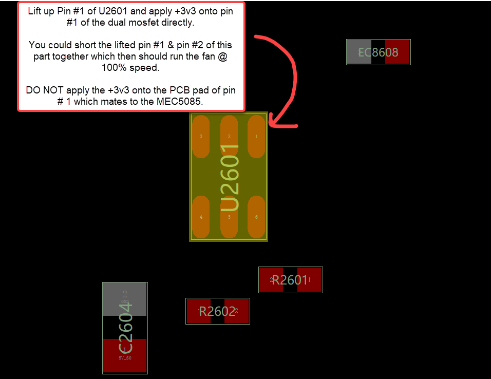

                    If you feel comfortable with the idea, consider to:
                    Lift up the leg of pin #1 of U2601 and apply 3v3 onto pin #1. Do not allow for the PCB pad that is connected to the MEC5085 to receive this manual fed 3v3 rail. The reason being that the MEC5085 pin for the PWM is also an output pin and presently it wants to send out 0V.
                    If you manually apply 3v3 onto pin #1 (only), believe that the fan should run @ 100%. As a test, confirm it and post your results.

                      I have already tested the short circuit of pins 1 and 2. The fan worked 100%
                      But how I desoldered the mosfet (2N7002), and the voltage on pin 1 (U2601) started to jump
