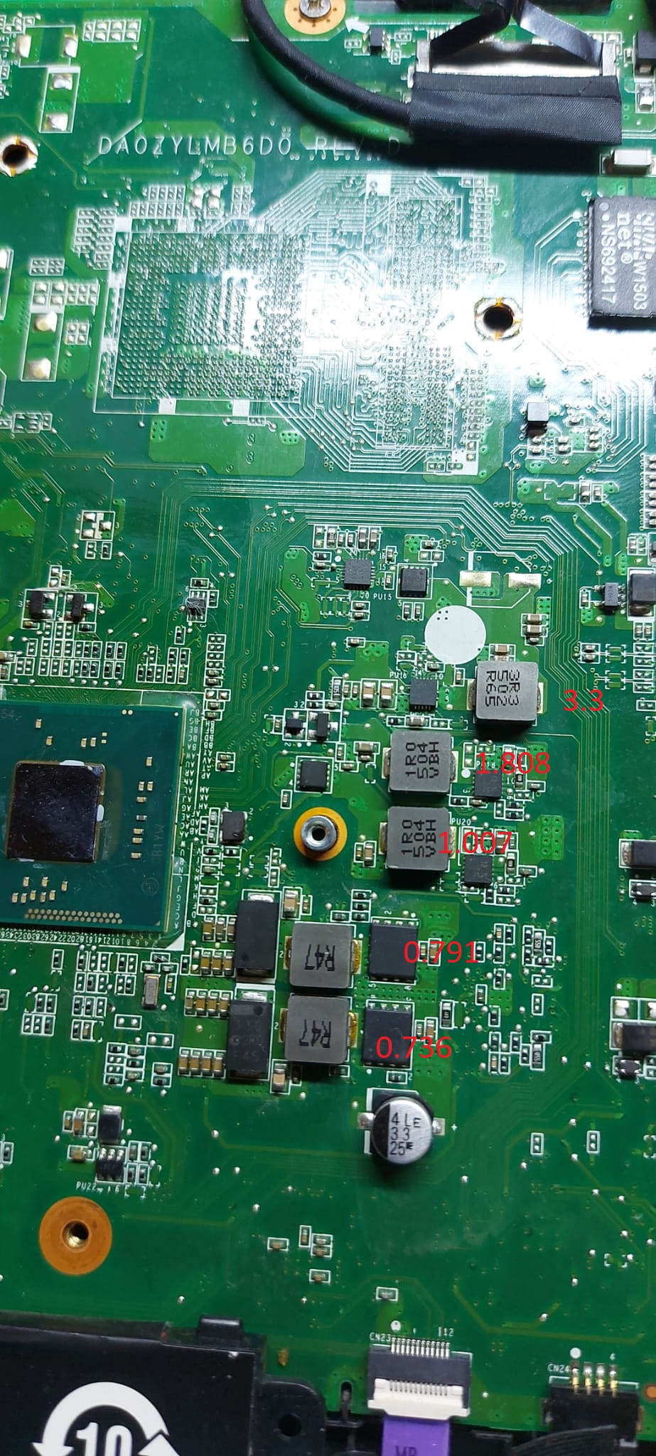

    hello everyone,i have a mentioned laptop with the board DA0ZYLMB6D0 rev: D
    laptop turns on, but no picture,all the voltages present,CPU cold,USB has power,but not blinking the usb stick light, so not reading from usb, fn+esc works, starts to blink power led,but not reading from USB, fan spins up at powerup and doesn't work even if i heat the cpu with hot air...it seems something is missing at powerup,but what... i tried flashing bios a few times, it's 1.8V, and i have the adapter, so everything went fine, but to no avail...could the EC bee the problem? how to flash EC?

    Re: Acer ES1-711
    please advise what to look next...is the cpu dead? it has only cpu with pch...

      Re: Acer ES1-711
      If all voltages are present, cpu cant remain cold. Check voltage on coils near cpu.

        Re: Acer ES1-711
        all present, i will attach a picture and measurments...could one of the crystals be the problem near the cpu? one is metal, other is black/plastic... i desoldered the black one and then no power led, i must try the other one also...but i doubt it the crystal...

          Re: Acer ES1-711
          here is the picture

            Re: Acer ES1-711
            It has nothing to do with crystal.

              Re: Acer ES1-711
              ok,what to look next?
