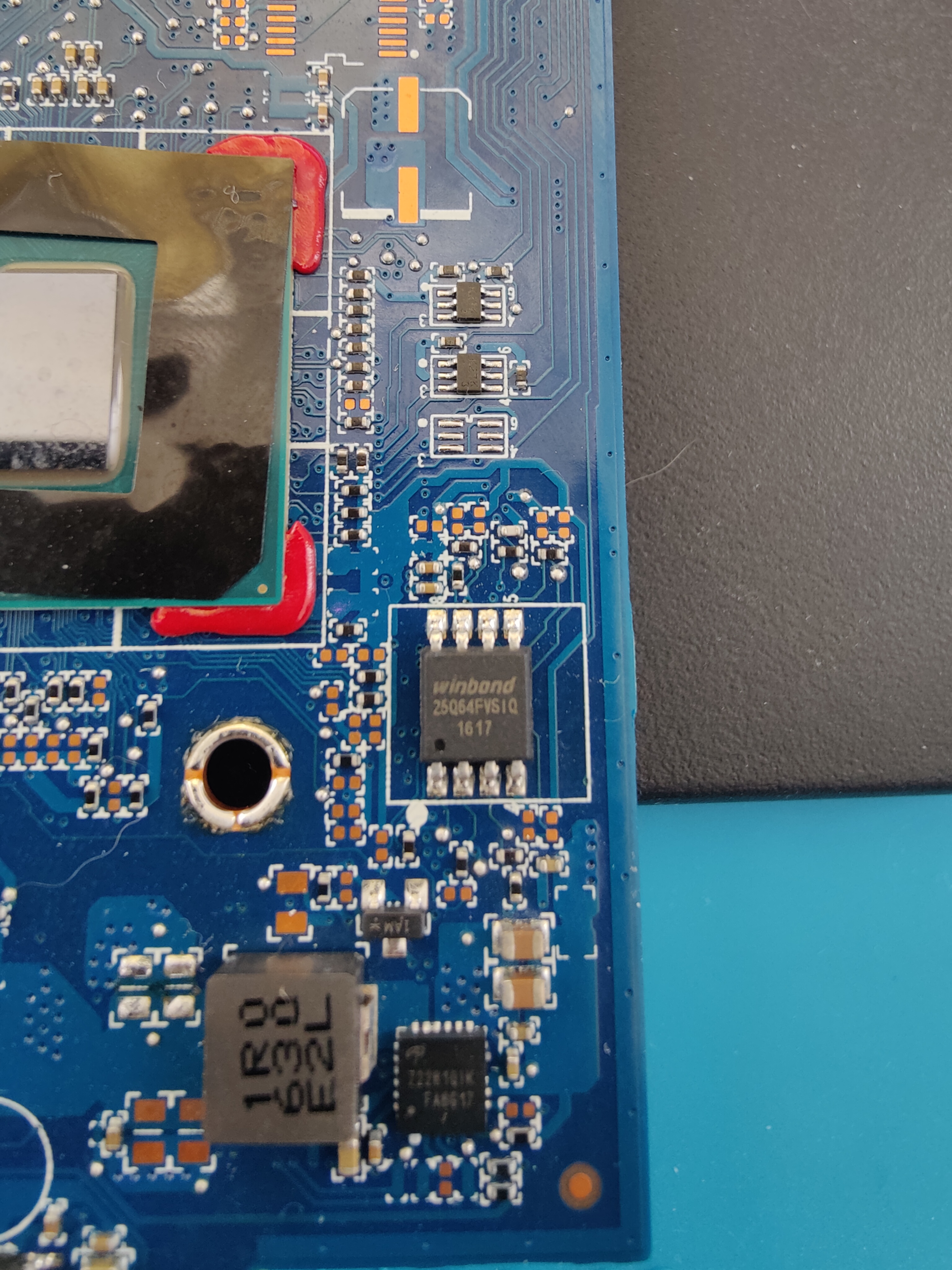

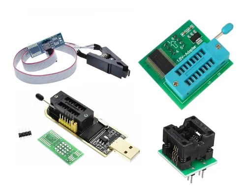

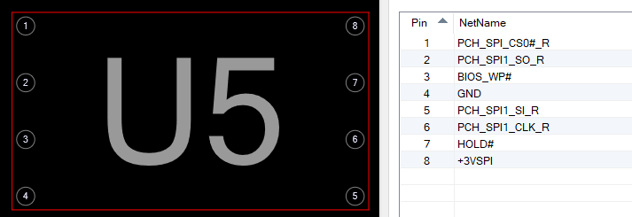

HP Pavilion 17-ab091ms - white charging light, but no power
  • BMCappelletti
    replied
    Re: HP Pavilion 17-ab091ms - white charging light, but no power
    Originally posted by tahc81
    Please note that BIOS chip is 1.8V device, so you'd need 1.8V SPI adapter. And no, incorrect/broken BIOS image can't cause short on power rail. If the EC BIOS is a part of it, it could make some other issues, but at least 3.3V is completely independent of BIOS and EC.
    I think I'm fine.
    Still need to check how to do all that.
    But if a broken BIOS cannot result in a short, so I don't see a point on trying to reflash it. Or did I get it wrong?
    Leave a comment:
  • tahc81
    replied
    Re: HP Pavilion 17-ab091ms - white charging light, but no power
    Please note that BIOS chip is 1.8V device, so you'd need 1.8V SPI adapter. And no, incorrect/broken BIOS image can't cause short on power rail. If the EC BIOS is a part of it, it could make some other issues, but at least 3.3V is completely independent of BIOS and EC.
    Leave a comment:
  • BMCappelletti
    replied
    Re: HP Pavilion 17-ab091ms - white charging light, but no power
    Originally posted by SMDFlea
    Post a picture of U5 on the motherboard
    That reminded me that the board is shorted. So, can a corrupted bios cause this?
    I'm a noob, but I guess it does not. Or does it?
    Last edited by BMCappelletti; 11-10-2021, 11:32 AM.
    Leave a comment:
    replied
    Re: HP Pavilion 17-ab091ms - white charging light, but no power
    Originally posted by BMCappelletti
    Ok. I bought a CH341A and will receive it today.
    I'll watch some Youtube videos to check properly on how to proceed with it.
    I believe the BIOS on this motherboard is this guy
    Winbond 25Q64FVSIQ 1617.
    Post a picture of U5 on the motherboard
    Leave a comment:
  • BMCappelletti
    replied
    Re: HP Pavilion 17-ab091ms - white charging light, but no power
    SIO Pin119 RSMRST# is missing. I'll strongly suggest to flash bios first before proceeding further in diagnosis.
    Ok. I bought a CH341A and will receive it today.
    I'll watch some Youtube videos to check properly on how to proceed with it.
    I believe the BIOS on this motherboard is this guy
    Winbond 25Q64FVSIQ 1617.
    Last edited by BMCappelletti; 11-10-2021, 08:39 AM.
    Leave a comment:
  • mcplslg123
    replied
    Re: HP Pavilion 17-ab091ms - white charging light, but no power
    SIO Pin119 RSMRST# is missing. I'll strongly suggest to flash bios first before proceeding further in diagnosis.
    Leave a comment:
  • BMCappelletti
    replied
    Re: HP Pavilion 17-ab091ms - white charging light, but no power
    Measure THRM_MONITOR1 and THRM_MONITOR2 also.It could be 'coz of thermal protection as well. Hp's often have this failure.
    THRM_MONITOR1 3,4V
    THRM_MONITOR2 I'm not sure, cause the board view I have is slightly different from the board itself.
    Leave a comment:
  • BMCappelletti
    replied
    Re: HP Pavilion 17-ab091ms - white charging light, but no power
    Perhaps you set your meter at 20V and that's why not getting any reading at pin4 which is supposed to be 25V approx. Everything seems fine with charger IC. Now measure the basic requirement of SIO(U5100).
    PIN 11/14/20/21/26/67/68/69/81/97/107/119/123
    Btw, have you flashed bios?? If not make a backup of your bios and start a request at bios section while posting your backup bios dump. When you try to switch it on,does the dc jack light blinks in quick succession?? The adapter used is HP original and rated correctly like 65W/90W??
    U5100
    11 - 3,3V
    13 - 3V
    20 - 0
    21 - 0
    26 - 3,3V
    67 - 1V
    68 - 0
    69 - 2,6V
    81 - 0
    97 - 2,8V
    107 - 3,3V
    119 - 0
    123 - 2,4V
    I didn't flash BIOS. Would need to buy some equipment to remove it and back it up.
    The DC jack light does not blink. It's a solid white.
    Original HP charger 120W.
    Leave a comment:
  • mcplslg123
    replied
    Re: HP Pavilion 17-ab091ms - white charging light, but no power
    Measure THRM_MONITOR1 and THRM_MONITOR2 also.It could be 'coz of thermal protection as well. Hp's often have this failure.
    Leave a comment:
  • mcplslg123
    replied
    Re: HP Pavilion 17-ab091ms - white charging light, but no power
    Perhaps you set your meter at 20V and that's why not getting any reading at pin4 which is supposed to be 25V approx. Everything seems fine with charger IC. Now measure the basic requirement of SIO(U5100).
    PIN 11/14/20/21/26/67/68/69/81/97/107/119/123
    Btw, have you flashed bios?? If not make a backup of your bios and start a request at bios section while posting your backup bios dump. When you try to switch it on,does the dc jack light blinks in quick succession?? The adapter used is HP original and rated correctly like 65W/90W??
    Leave a comment:
  • BMCappelletti
    replied
    Re: HP Pavilion 17-ab091ms - white charging light, but no power
    Measure PIN 1/2/3/4/5 for ACP/ACN/CMSRC/ACDRV/ACOK,Pin16 for REGN & PIN20 FOR vcc. Lets see the measurements, then we can confirm whether charging ic is working correctly or not. Most of the times a non-functional charging ic dont let the +19V rail to pass thru.So its important.
    Pins 1, 2 and 3 - 19,7V
    Pin 5 - 2,8V
    Pin 16 - 5,98V
    Pin 20 - 19,7V
    Could not get a read on pin 4. Multimeter only shows number 1.
    Leave a comment:
  • mcplslg123
    replied
    Re: HP Pavilion 17-ab091ms - white charging light, but no power
    Measure PIN 1/2/3/4/5 for ACP/ACN/CMSRC/ACDRV/ACOK,Pin16 for REGN & PIN20 FOR vcc. Lets see the measurements, then we can confirm whether charging ic is working correctly or not. Most of the times a non-functional charging ic dont let the +19V rail to pass thru.So its important.
    Leave a comment:
  • BMCappelletti
    replied
    Re: HP Pavilion 17-ab091ms - white charging light, but no power
    PU1001 is the charging IC.
    This would be on the back of the board. A chip marked as BQ738H, which is indeed a charging chip.
    I could not find continuity between the three pins on the first mosfet with pins from this one.
    Do you suggest anything else I can check?
    Leave a comment:
  • mcplslg123
    replied
    Re: HP Pavilion 17-ab091ms - white charging light, but no power
    PU1001 is the charging IC.
    Leave a comment:
  • mcplslg123
    replied
    Re: HP Pavilion 17-ab091ms - white charging light, but no power
    Originally posted by BMCappelletti
    Sorry, it says MS6HH.
    Its most liley a 3v PWM IC.(Sylergy code -MS)
    Leave a comment:
  • BMCappelletti
    replied
    Re: HP Pavilion 17-ab091ms - white charging light, but no power
    The one next to the other large coil, above that one, says Z2281QIK.
    Last edited by BMCappelletti; 11-07-2021, 07:48 PM.
    Leave a comment:
  • BMCappelletti
    replied
    Re: HP Pavilion 17-ab091ms - white charging light, but no power
    Sorry, it says MS6HH.
    Leave a comment:
  • mon2
    replied
    Re: HP Pavilion 17-ab091ms - white charging light, but no power
    There are no markings on the IC near the coil ? From the picture, there appears to be something faint on the top surface.
    Try applying some alcohol with a Q-tip that may enhance the text under the right angle of light. There must be some markings on the component - unless the part is burnt out and caused the text to be distorted.
    Since we have no schematics, we can only work with the part values with hope to decipher the workings of the power supply. From tracing the PCB, it appears that the power rail is connected to the IC with the missing markings.
    Leave a comment:
  • BMCappelletti
    replied
    Re: HP Pavilion 17-ab091ms - white charging light, but no power
    Originally posted by mon2
    The mosfet appears to be turning ON since the gate is lower than the threshold value to allow for the source & drain to conduct.
    See attached.
    Remove all power.
    Meter in resistance mode.
    Place one meter lead on the pins 1-2-3 of the same mosfet.
    Probe with the other meter lead near the IC (I think the one near the large coil) till you here a meter beep.
    Found nothing on that IC.
    We are looking for the IC that is linked to this mosfet. That is, the ~20v enters the board and then through the thick traces mates with a switching regulator. Believe it is the one near the large coil. Wish to be sure it reaches the regulator.
    Then the local coil is used to reduce the DCIN voltage to some other value.
    After the above resistance check, configure your meter to DC Volts (20V or higher).
    What is the voltage at the coil (with reference to ground) when the DC adapter is attached ?
    No reading. 0V on the multimeter.
    We are confirming that the DC adapter voltage is reaching the first regulator and that the first regulator is performing its duty to turn on and produce some voltage rail.
    Leave a comment:
  • mon2
    replied
    Re: HP Pavilion 17-ab091ms - white charging light, but no power
    The mosfet appears to be turning ON since the gate is lower than the threshold value to allow for the source & drain to conduct.
    See attached.
    Remove all power.
    Meter in resistance mode.
    Place one meter lead on the pins 1-2-3 of the same mosfet.
    Probe with the other meter lead near the IC (I think the one near the large coil) till you here a meter beep.
    We are looking for the IC that is linked to this mosfet. That is, the ~20v enters the board and then through the thick traces mates with a switching regulator. Believe it is the one near the large coil. Wish to be sure it reaches the regulator.
    Then the local coil is used to reduce the DCIN voltage to some other value.
    After the above resistance check, configure your meter to DC Volts (20V or higher).
    What is the voltage at the coil (with reference to ground) when the DC adapter is attached ?
    We are confirming that the DC adapter voltage is reaching the first regulator and that the first regulator is performing its duty to turn on and produce some voltage rail.
    Leave a comment:
    HP Pavilion Pavilion Desktop - 570-p056 Pavilion 570 i7-7700 Specification for Upgrade or Repair
    This specification for the HP Pavilion Pavilion Desktop - 570-p056 can be useful for upgrading or repairing a desktop PC that is not working. As a community we are working through our specifications to add valuable data like the Pavilion Pavilion Desktop - 570-p056 boardview and Pavilion Pavilion Desktop - 570-p056 schematic. Our users have donated over 1 million documents which are being added to the site. This page will be updated soon with additional information. Alternatively you can request additional help from our users directly on the relevant badcaps forum. Please note that we offer no...
    09-12-2024, 03:44 PM
    HP Pavilion Wave Pavilion Wave Desktop - 600-a030na Pavilion Wave i3-6100T Specification for Upgrade or Repair
    This specification for the HP Pavilion Wave Pavilion Wave Desktop - 600-a030na can be useful for upgrading or repairing a desktop PC that is not working. As a community we are working through our specifications to add valuable data like the Pavilion Wave Pavilion Wave Desktop - 600-a030na boardview and Pavilion Wave Pavilion Wave Desktop - 600-a030na schematic. Our users have donated over 1 million documents which are being added to the site. This page will be updated soon with additional information. Alternatively you can request additional help from our users directly on the relevant badcaps...
    09-12-2024, 03:44 PM
    HP Pavilion Pavilion Wave Desktop - 600-a059na Pavilion i5-6400T Specification for Upgrade or Repair
    This specification for the HP Pavilion Pavilion Wave Desktop - 600-a059na can be useful for upgrading or repairing a desktop PC that is not working. As a community we are working through our specifications to add valuable data like the Pavilion Pavilion Wave Desktop - 600-a059na boardview and Pavilion Pavilion Wave Desktop - 600-a059na schematic. Our users have donated over 1 million documents which are being added to the site. This page will be updated soon with additional information. Alternatively you can request additional help from our users directly on the relevant badcaps forum. Please...
    09-12-2024, 03:44 PM
    HP Pavilion Pavilion Desktop - 550-257na (ENERGY STAR) Pavilion 550 i5-6400 Specification for Upgrade or Repair
    This specification for the HP Pavilion Pavilion Desktop - 550-257na (ENERGY STAR) can be useful for upgrading or repairing a desktop PC that is not working. As a community we are working through our specifications to add valuable data like the Pavilion Pavilion Desktop - 550-257na (ENERGY STAR) boardview and Pavilion Pavilion Desktop - 550-257na (ENERGY STAR) schematic. Our users have donated over 1 million documents which are being added to the site. This page will be updated soon with additional information. Alternatively you can request additional help from our users directly on the relevant...
    09-12-2024, 03:44 PM
    HP Pavilion Pavilion Desktop - 570-a079w Pavilion 570 J4205 Specification for Upgrade or Repair
    This specification for the HP Pavilion Pavilion Desktop - 570-a079w can be useful for upgrading or repairing a desktop PC that is not working. As a community we are working through our specifications to add valuable data like the Pavilion Pavilion Desktop - 570-a079w boardview and Pavilion Pavilion Desktop - 570-a079w schematic. Our users have donated over 1 million documents which are being added to the site. This page will be updated soon with additional information. Alternatively you can request additional help from our users directly on the relevant badcaps forum. Please note that we offer...
    09-12-2024, 03:44 PM
