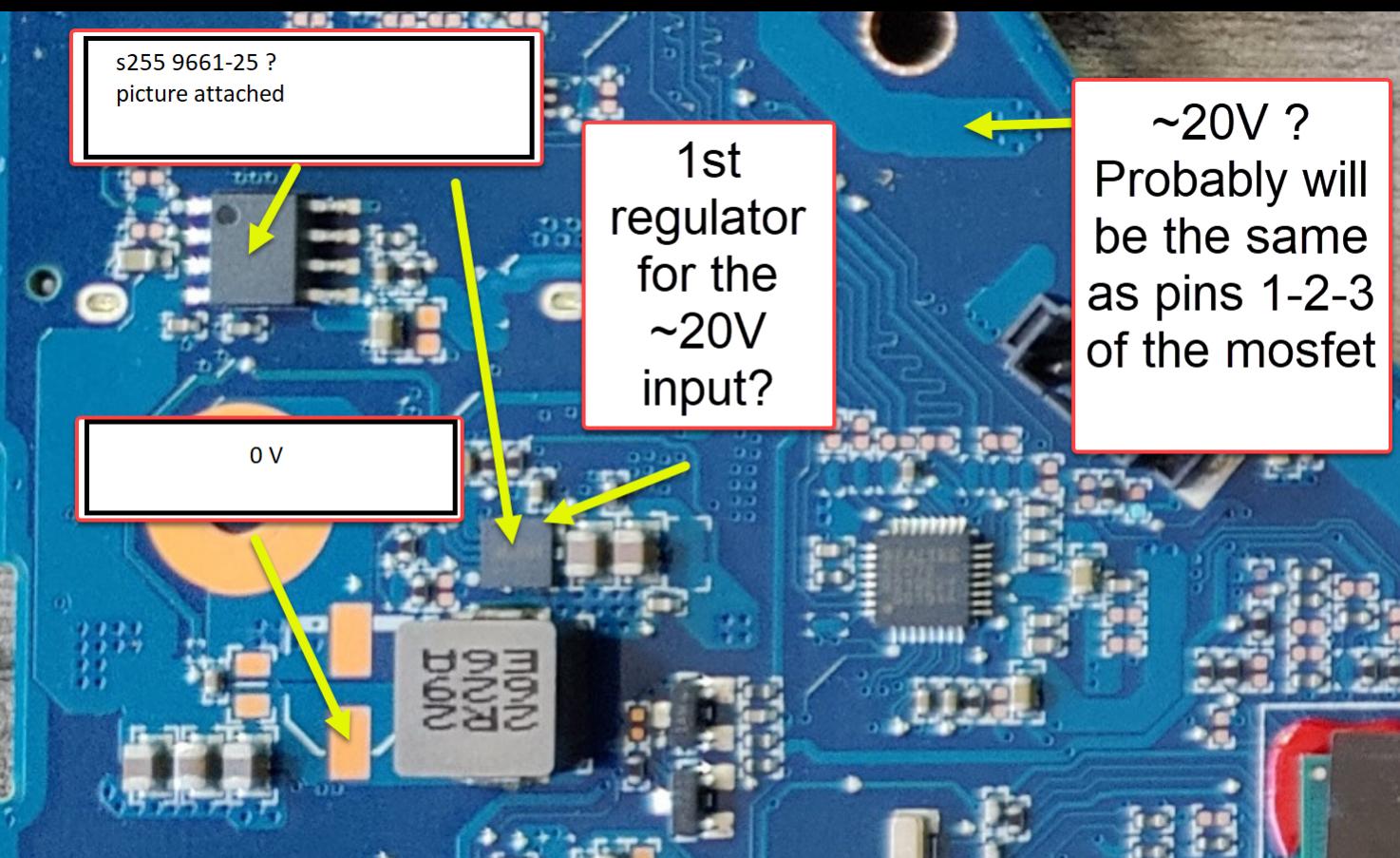

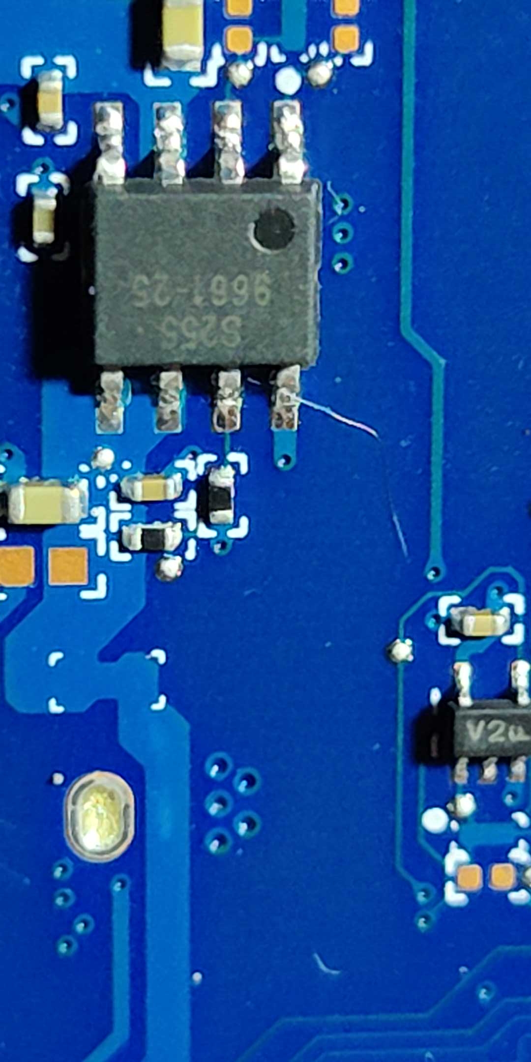

Found nothing on that IC.
No reading. 0V on the multimeter.
We are confirming that the DC adapter voltage is reaching the first regulator and that the first regulator is performing its duty to turn on and produce some voltage rail.
				We are looking for the IC that is linked to this mosfet. That is, the ~20v enters the board and then through the thick traces mates with a switching regulator. Believe it is the one near the large coil. Wish to be sure it reaches the regulator.
Then the local coil is used to reduce the DCIN voltage to some other value.
After the above resistance check, configure your meter to DC Volts (20V or higher).
What is the voltage at the coil (with reference to ground) when the DC adapter is attached ?
