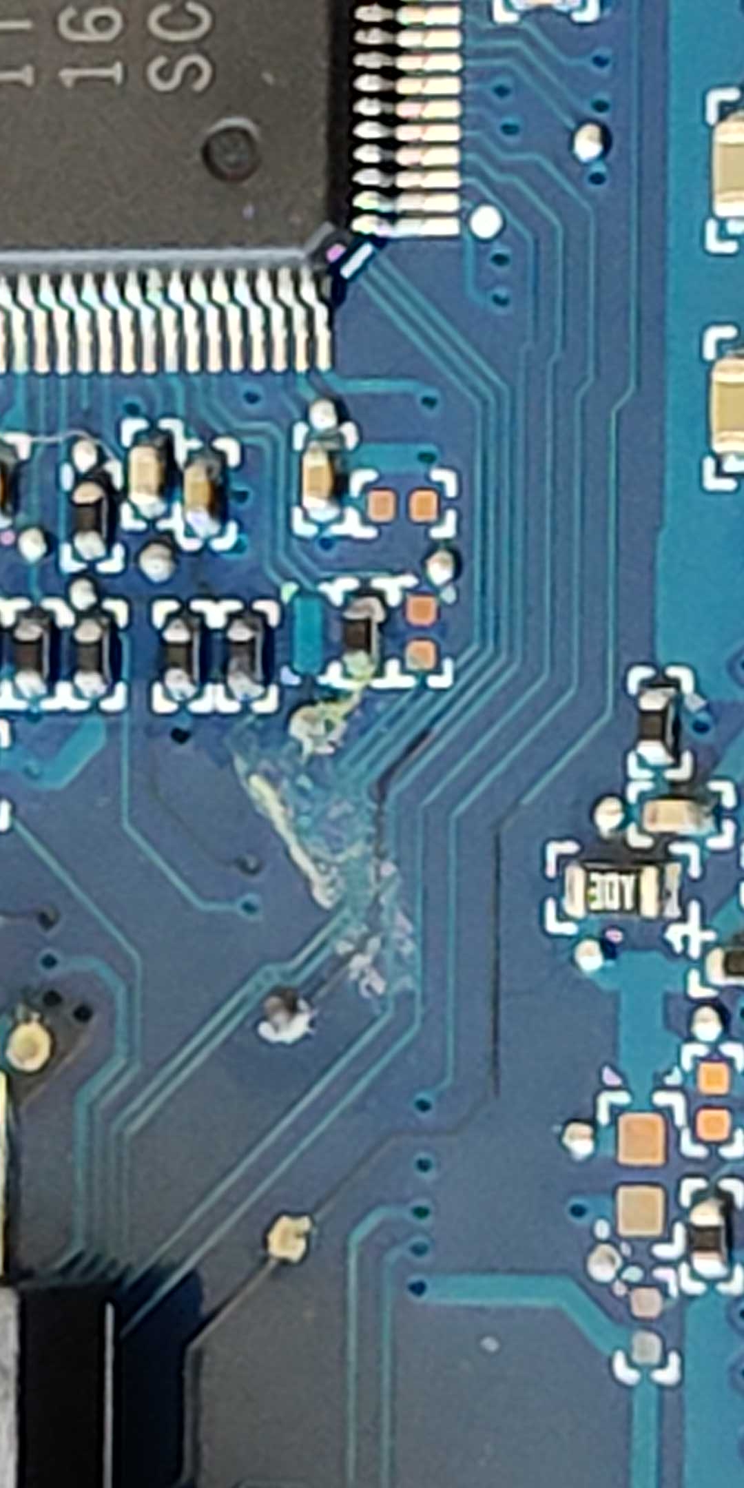

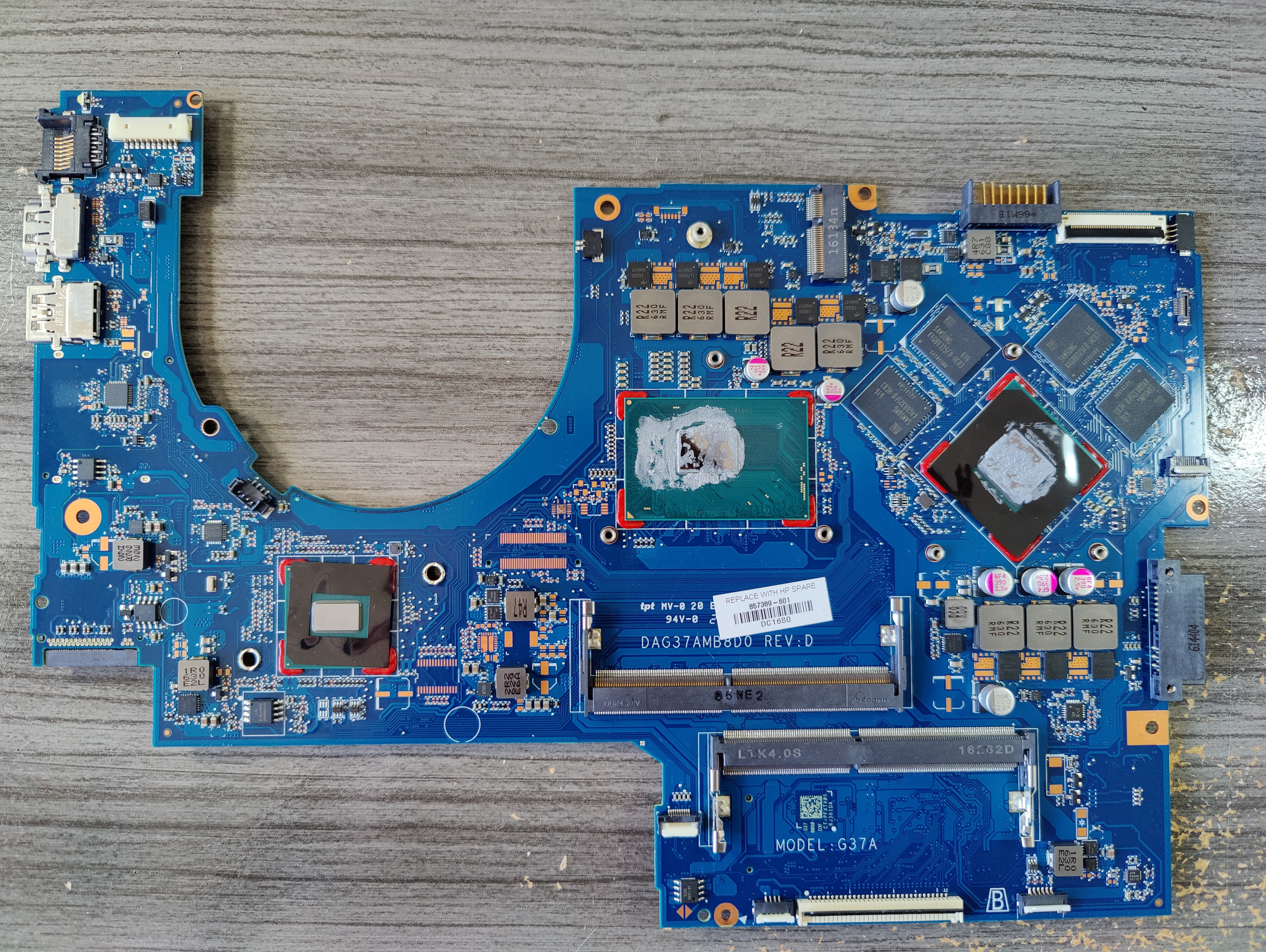

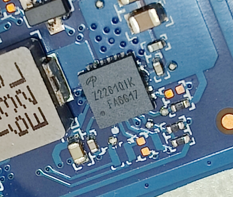

    Hello, everyone.
    Got a HP Pavilion 17-ab091ms laptop that has the white light besides the charging connector but does not power on.
    No liquid damage, no bumps, nothing. It was working one day and dead on the other.
    Charger is fine, outputting 19,5V. 19,5V is also present on the red connector ping on the motherboard.
    Power button seems to be fine, as I tested continuity with a multimeter.
    It's an Intel Core i7 6700HQ with a GTX960M 4GB model, all on a DAG37AMB8D0 rev. D motherboard, as following pictures.

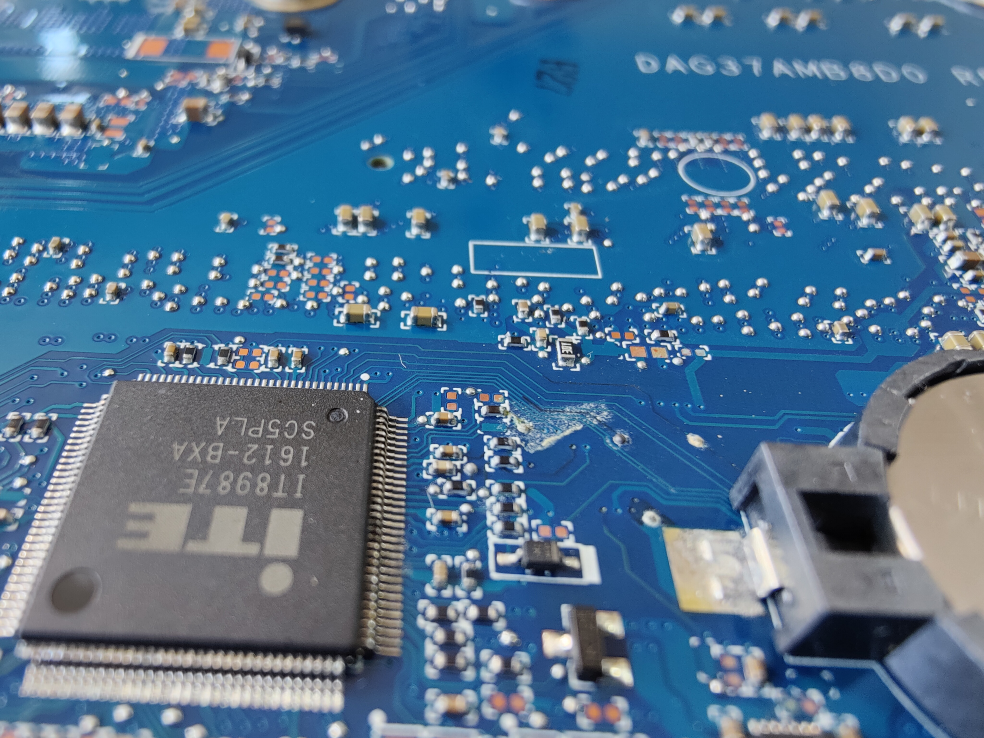

    On a visual inspection there seems to have a blown capacitor (???) on the back side.
    I tried to find a board view of this one to at least have an idea of what is that component, but the one posted on another thread here does not seem to be the same model.
    So... does anyone know what that component would be?
    And, should I try to remove it and power the laptop on to see if it acts differently?
    Thanx alot.

    Use a dabbed Q-tip in alcohol and clean up that spill showing in your last picture. Looks like a bit of corrosion but that is a start.
      Actualy I have done it, but taking care not to damage anything.
      Now I did it again, and use a thin twizzer to remove more.
      The caps marked on the image were shorting to ground before. Now the ones in red are fine. The ones in green are still shorting to ground.
      Not much. But something differente.

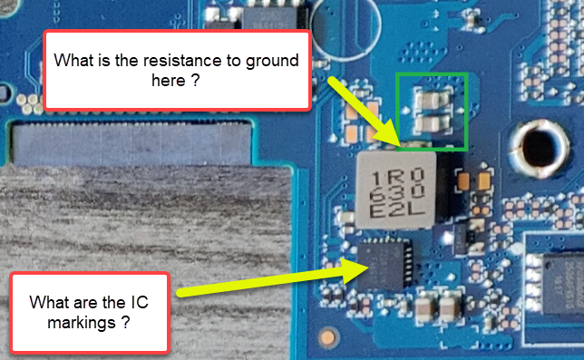

        Remove the ones in green off the logic board and check if the pads are still shorting across their pads on the PCB.
        Check if the caps show a short after they are removed from the PCB.
        Meter in resistance mode. Check and post the resistance to ground on the caps you are referencing.
          Removed it and the pads are shorted.
          No shorts testing the caps. But for some reason I can't get a good read on the resistance. Crappy multimeter leads, I guess.
          But they don't seem to be shorted and the pads are.

              Re: HP Pavilion 17-ab091ms - white charging light, but no power
              hi.
              See attached. Meter in resistance mode. All power removed.

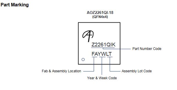

                Multimeter on 2K scale, it shows 0.026. Varying to 0.030.
                The IC seems to be a Z2261QIK FA6617 (not sure about the 66).
                  • 21394
                  Z2261QIK https://cdn.badcaps-static.com/pdfs/...22ef41d6d9.pdf

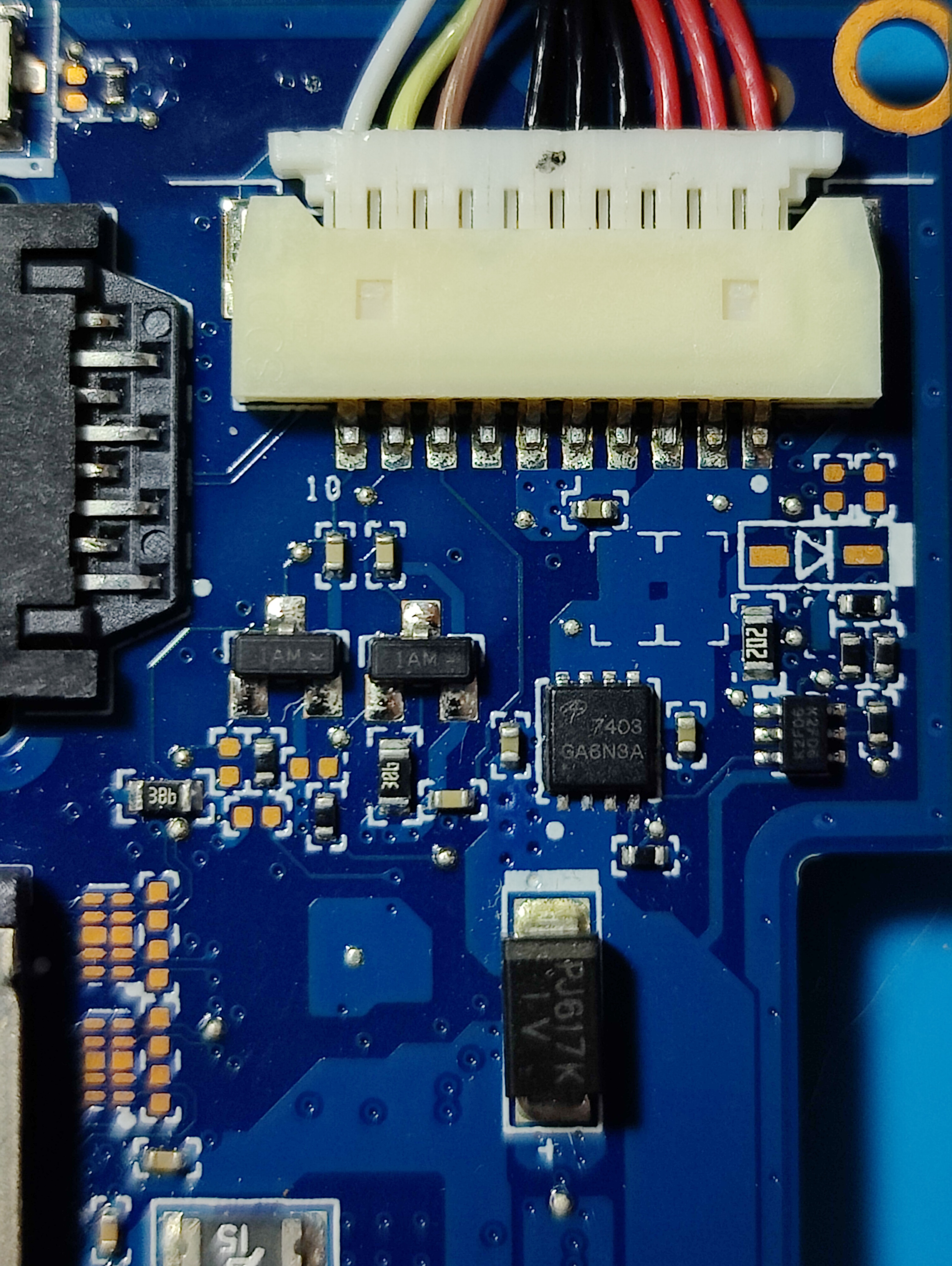

                            1) Meter in resistance mode (200 ohm scale is ok).
                            Check all large coils (grey in color) for their resistance to ground. Red meter lead on either side of the inductor; Black meter lead to a known ground connection on the logic board.
                            Interested to locate any very low resistance to ground coils (<10 ohms, etc.). Post the location of such a coil if one is found.
                            2) Meter still in resistance mode (200 ohms). Locate where the DC adapter enters the logic board. Near this area will be likely 2 * mosfets. Post clear pictures of them and also the markings on their top surface.
                            Next, check if the mosfets are shorted by checking their resistance as follows:
                            a) SOURCE & DRAIN
                            b) SOURCE & GATE
                            c) GATE & DRAIN
                            Looking for any really low resistance values which may confirm that the mosfet is shorted and needs to be replaced. If one is found, desolder it off the logic board and check their resistance again. If the resistance remains to be very low then that mosfet should be replaced.

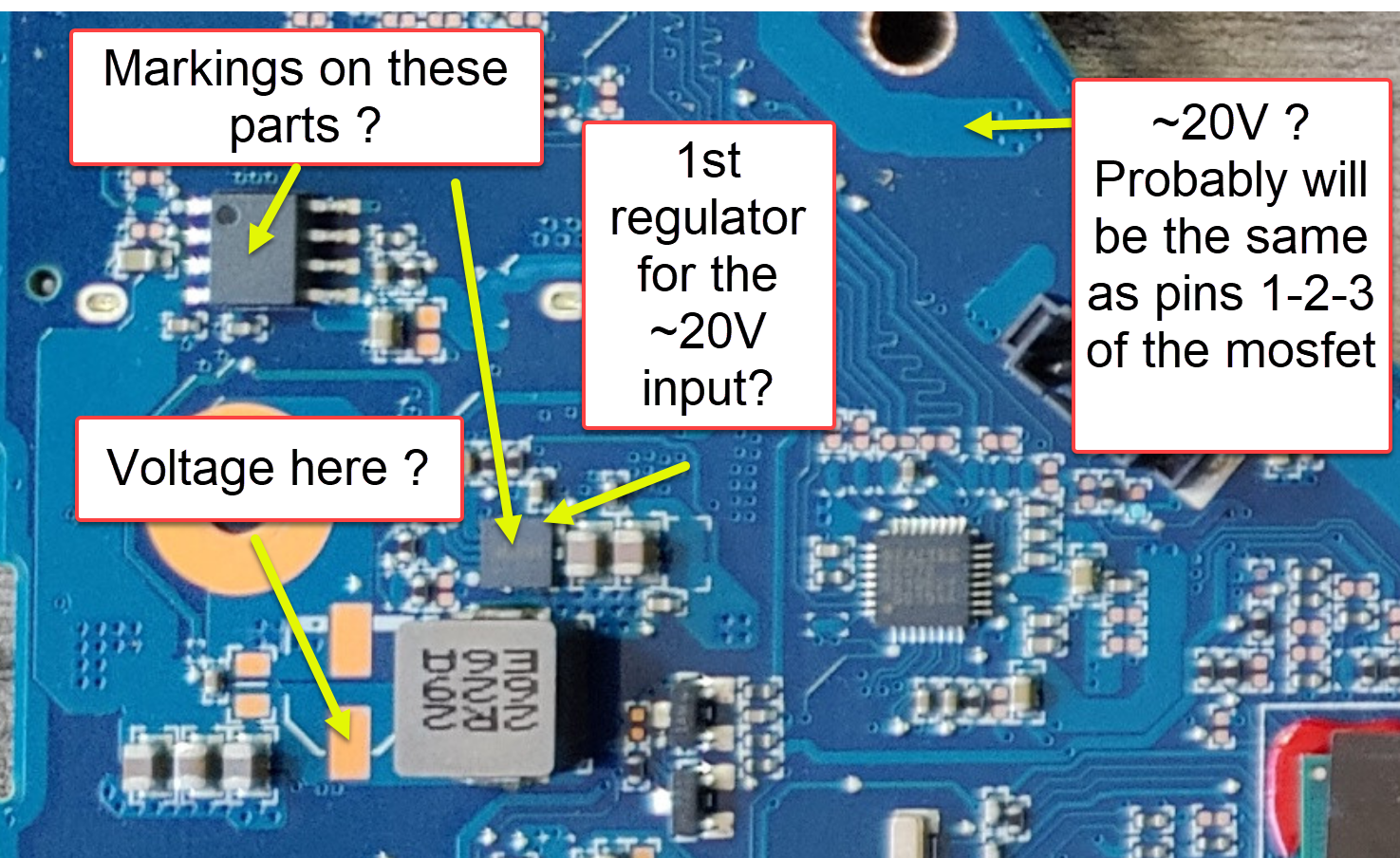

                              First, the mosfet.
                              I can see only one near to the power input.
                              Probably this guy, or some sort: https://datasheetspdf.com/pdf/706795...tors/AON7403/1
                              I have 19,5V on the first 3 pins on the upper side (considering the photo orientation) and 0 on the last one.
                              19,5V on the first three pins and 16,5V on the last one, on the bottom.
                              No shorts on it.

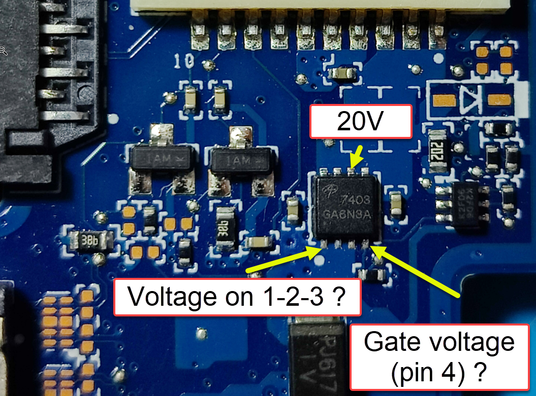

                                    Ok. Measure and post the voltage readings on this mosfet.
                                    • BMCappelletti
                                      • Nov 2021
                                      • 151
                                      • Brasil
                                      19,7V on all.
                                      16,8V on gate.
                                      • mon2
                                        • Dec 2019
                                        • 14476
                                        The mosfet appears to be turning ON since the gate is lower than the threshold value to allow for the source & drain to conduct.
                                        See attached.
                                        Remove all power.
                                        Place one meter lead on the pins 1-2-3 of the same mosfet.
                                        Probe with the other meter lead near the IC (I think the one near the large coil) till you here a meter beep.
                                        We are looking for the IC that is linked to this mosfet. That is, the ~20v enters the board and then through the thick traces mates with a switching regulator. Believe it is the one near the large coil. Wish to be sure it reaches the regulator.
                                        Then the local coil is used to reduce the DCIN voltage to some other value.
                                        After the above resistance check, configure your meter to DC Volts (20V or higher).
                                        What is the voltage at the coil (with reference to ground) when the DC adapter is attached ?
                                        We are confirming that the DC adapter voltage is reaching the first regulator and that the first regulator is performing its duty to turn on and produce some voltage rail.
