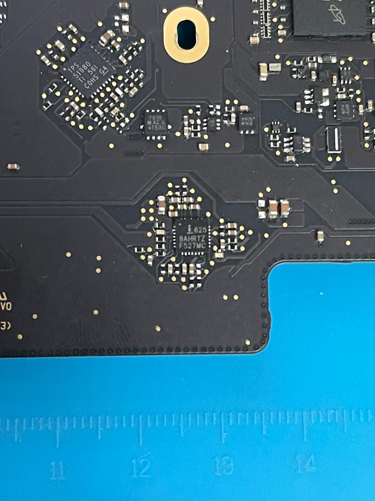

                          ISL6259 area looks OK but photo attached
                          I'm still suspicious of the 0.3V BATLOW signal. makes sense given the 10k pullup and 1k I measure to ground but is 1k a typical measurement?

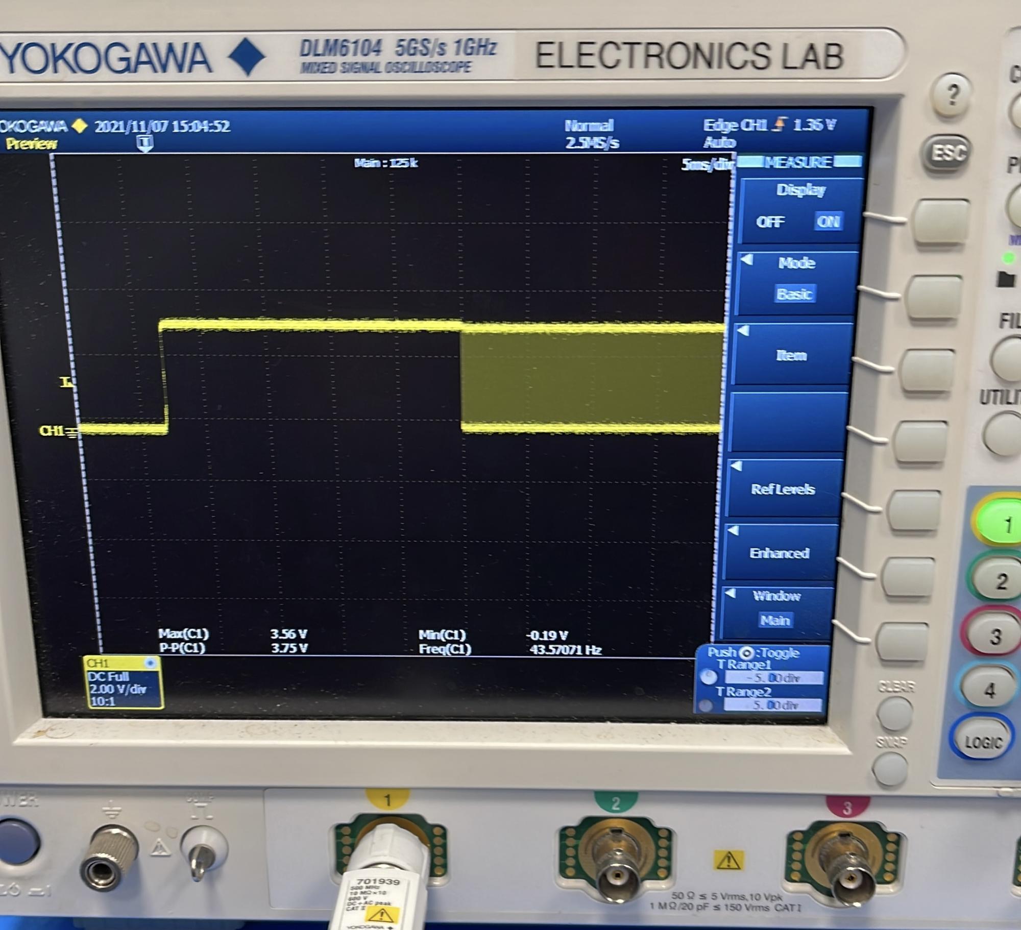

                            SMC 32khz clock is indeed 32khz
                            Goes high on power up, approx 22mS delay then starts clocking at 32khz
                            Pic attached. Seems like normal behaviour.

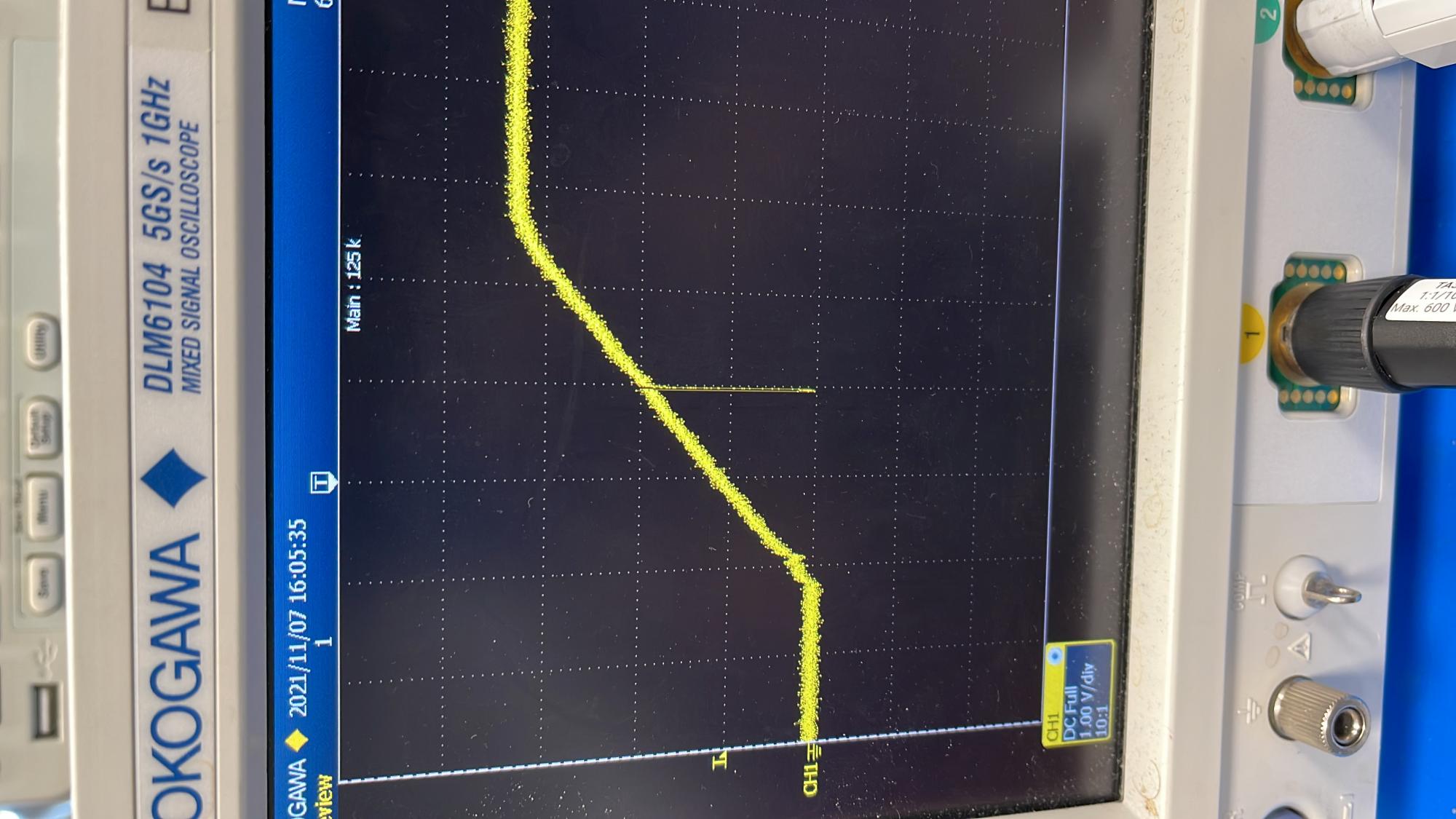

                            Bat low signal starts to climb for approx 300uS and is quickly grounded. Not sure what signals are used in that logic so unsure what else to put on the other channels for timing etc.

                                For info I've attached the rising batlow voltage. You can still see the dip which I assume is where the SMC checks or something but it “passes” and voltage rises.
