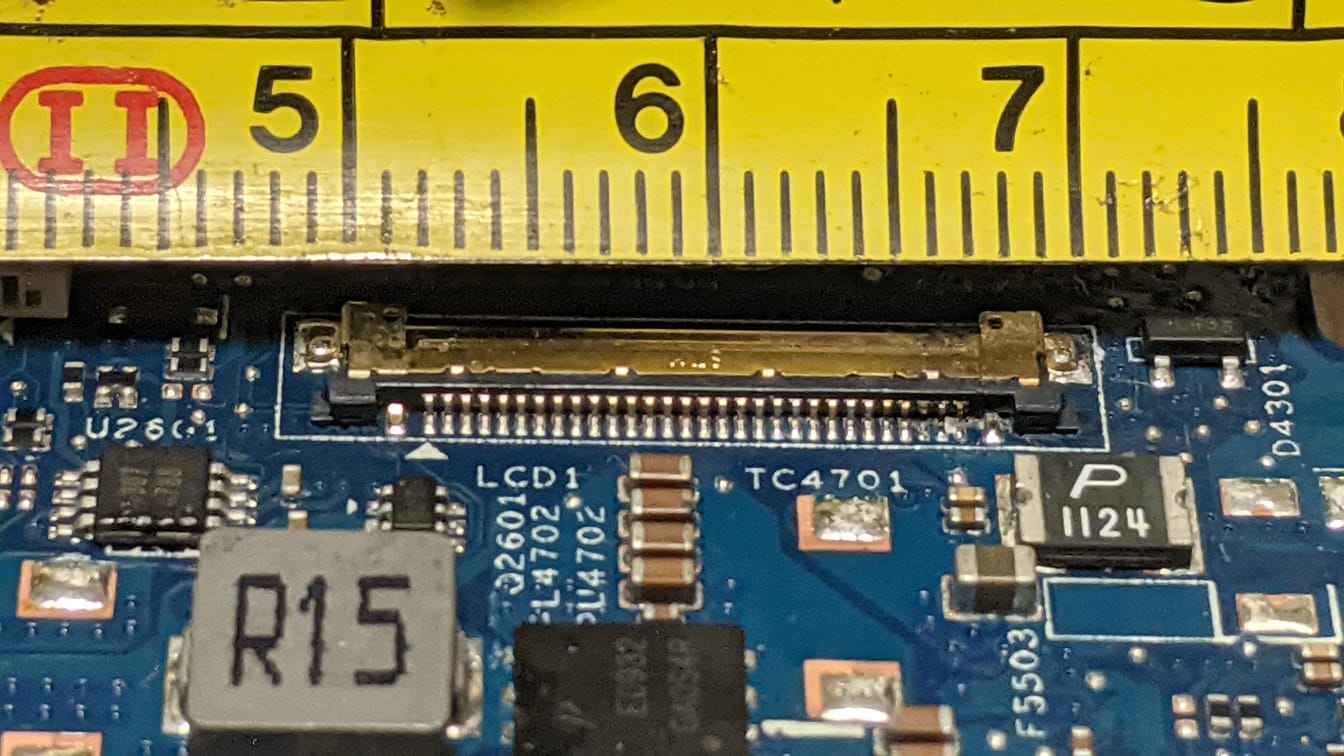

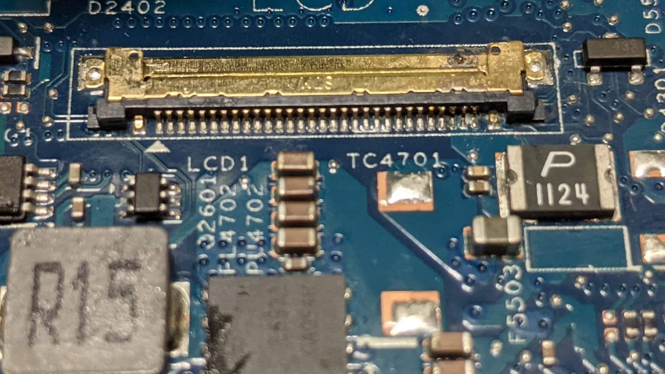

    Working on this machine which has a few issues including a short in the lcd connector. Anyone where I can get a replacement? Its 30 pin and about 2cm in length. All the ones I've seen are macbook ones-must be using the wrong search term in Google. Thanks

      Thanks for the prompt answer - I think I'll go with Aliexpress and see what turns up. I was looking for a gold body connector like you get in the macbooks! The lcd/lvds cable is not a flat ribbon cable - its like a macbook. Will that fit into the connector?

            pitch on the macbook LVDS 30 pin connectors = 0.5mm
            pitch on the iMAC LVDS 30 pin connectors = 1.0mm
            What is the edge to edge dimension in mm of your connector?
            The connector on your Dell sure looks to be the same as the Macbook connectors @ 0.5mm pitch.

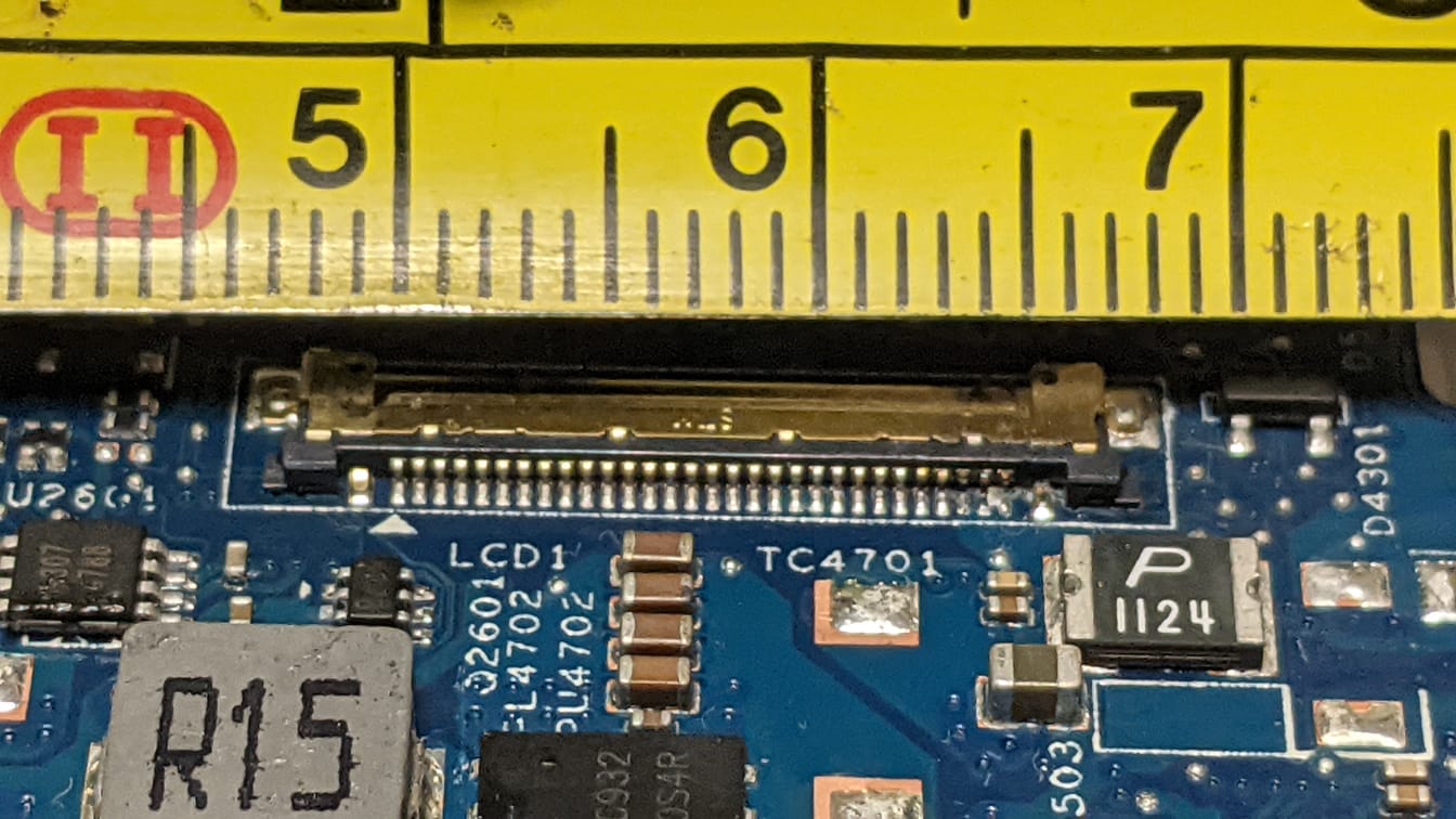

              sorry for the late reply - edge to edge about 19mm, pin 1 to 30 about 15mm

                With 0.5mm pin pitch, the 30 contacts will be 15mm edge-to-edge.
                Suggest for you to order the macbook 30 pin connector and before removing the original, overlay the two connectors to confirm one last time.
                Sure looks the same as the macbook connector.
                Do watch the videos on youtube on how to replace this component. Lots of flux.

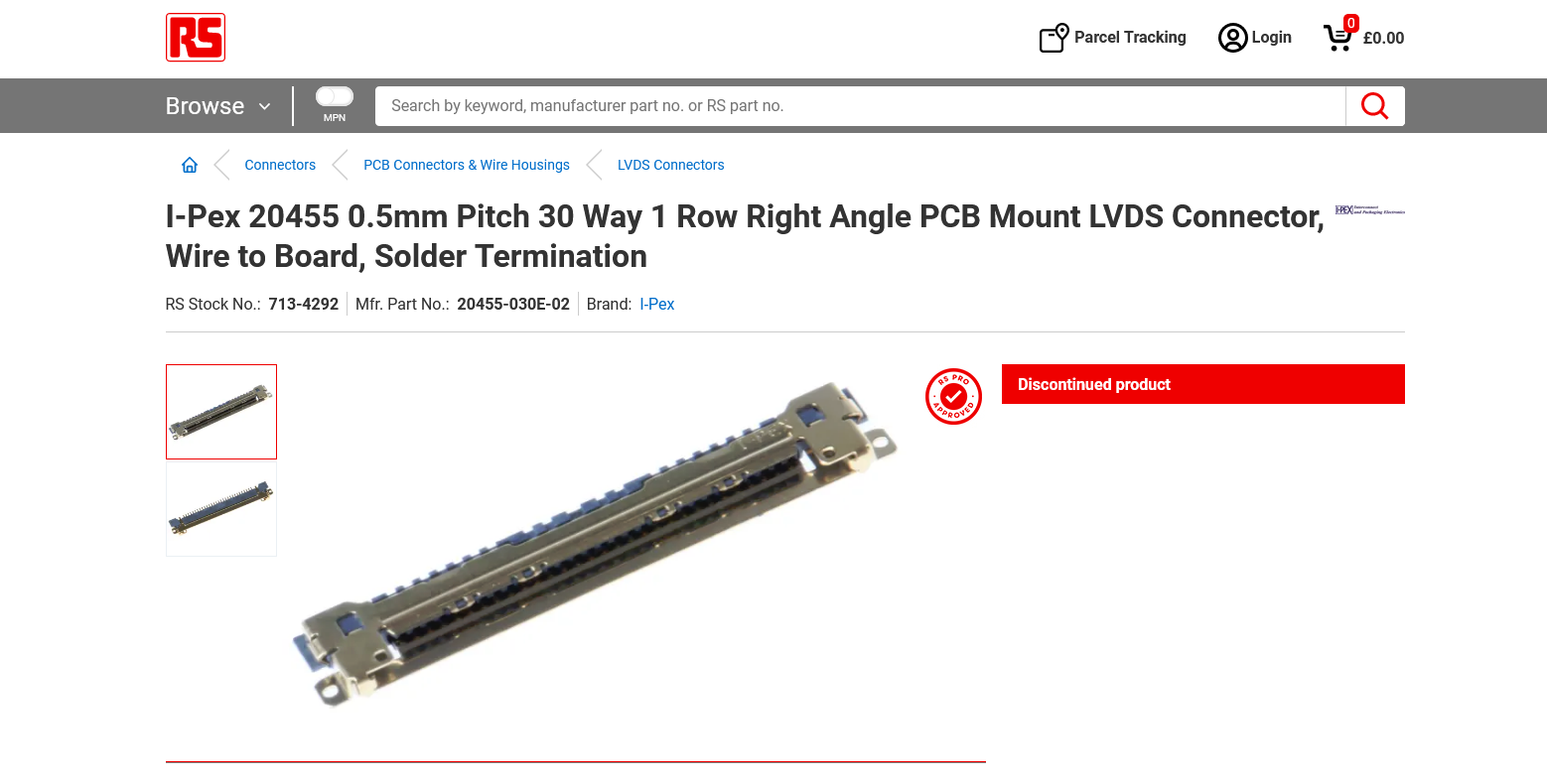

                  Originally posted by luckydip
                  The macbook ones are too small, the pitch is different. I think I need something like this but finding it will be like a needle in a haystack
                  https://www.aliexpress.com/item/1005002465569091.html

                      I have a good magnet ! Experience of buying connectors from Ali and knowing their search quirks (sometimes). 30p lvds 0.5mm connector
