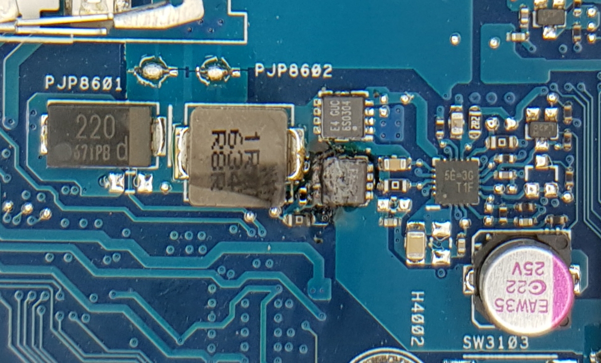

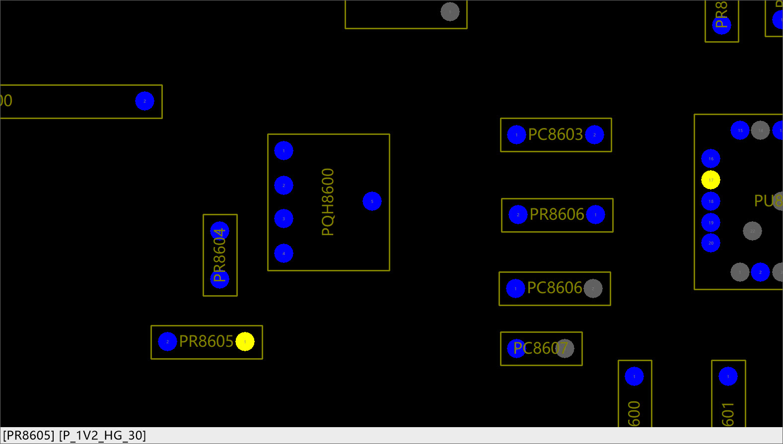

    Hello All I wonder if anyone can help me,
    I'm trying to fix an Asus GL752V.
    The laptop turned on with only the BATT/PW LED's showing on the front, no display/POST.

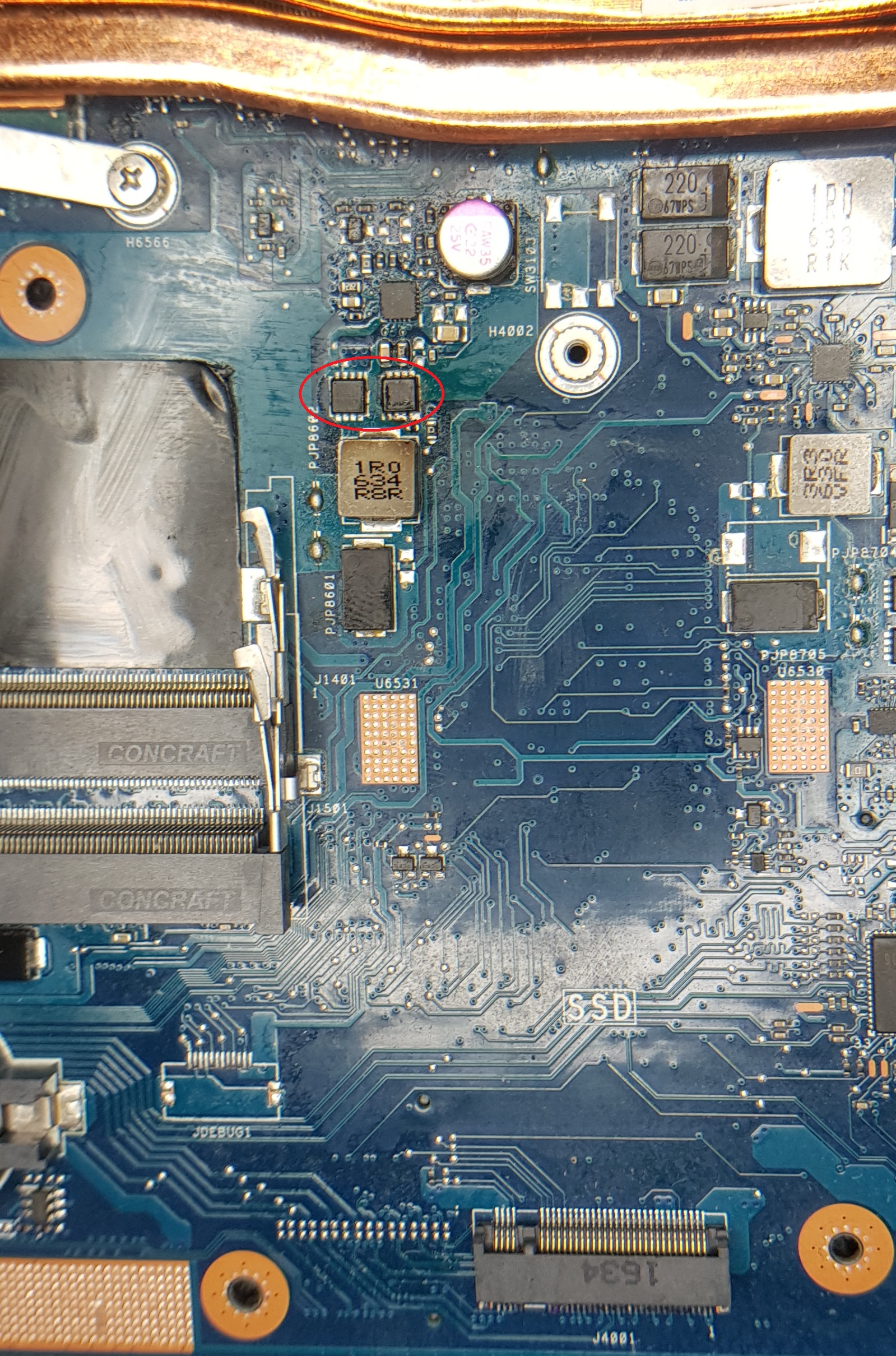

    I found that a MOSFET near the top left side of the SSD bay had blown rather aggressively, (black skid mark see pics) I removed the blown MOSFET and tested the one to the left of it, also blown (short on all pins), I tested board for shorts after the removal all seemed ok.
    I replaced both MOSFETS and did a short circuit test all still good (well low resistance on right FET from GtoS red flag?)
    I powered on the laptop without memory and the PW LED came on, so I thought all was good, I then installed a memory module turned on again and no power no lights, checked FET's and found both to be shorted AGAIN!
    Please could someone guide me to a solution.
    PS. I found on power connect (not pushing the power button) after the FET replacement the southbridge was warm, I'm guessing this is not normal and I think its the death knell of this laptop, Is it worth continuing with it?
    Any advice suggestion.
    Thanks.

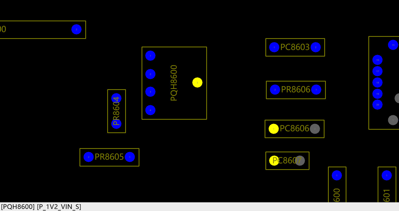

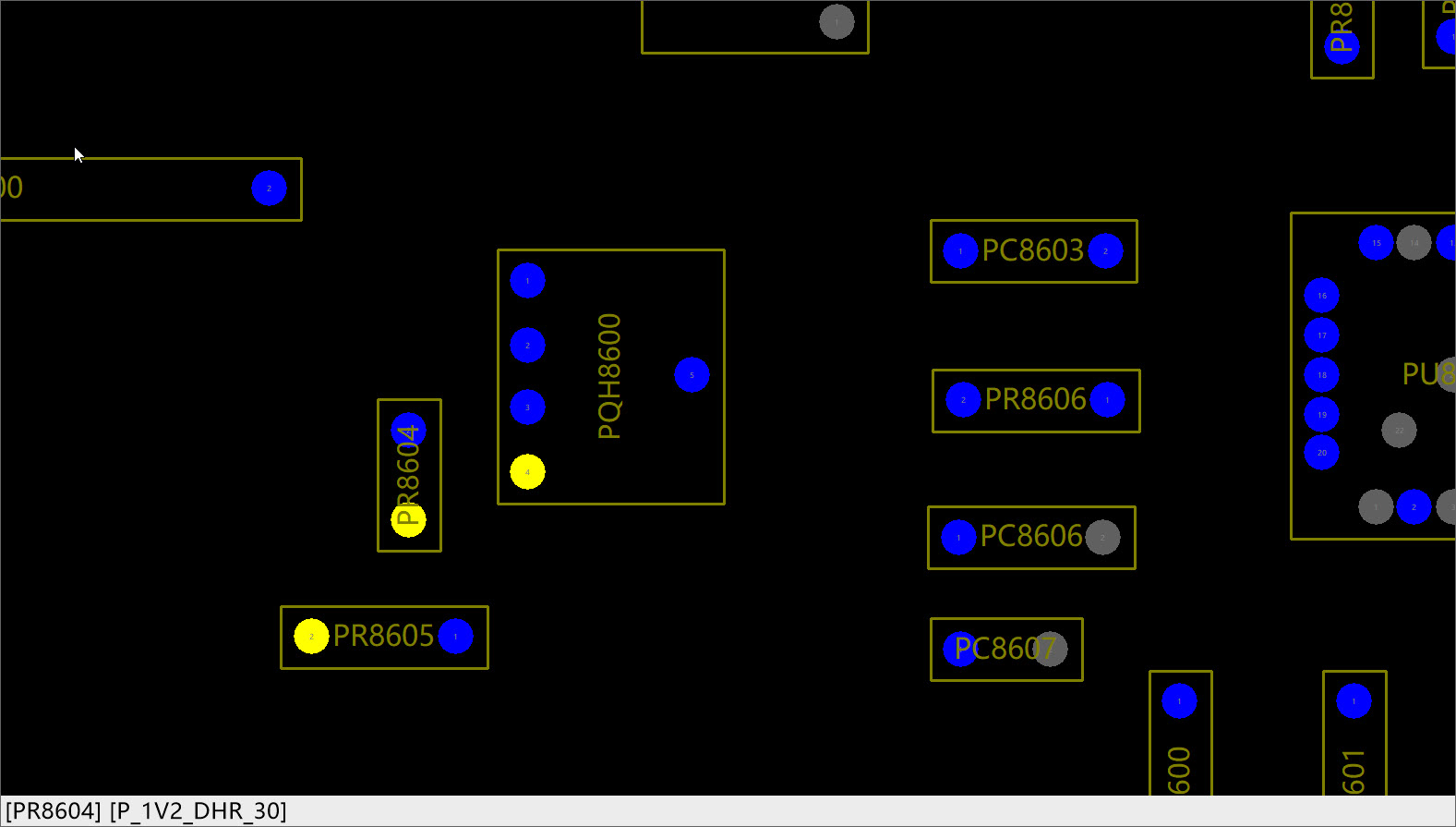

        Re: Asus GL752V Blowing new MOSFETS

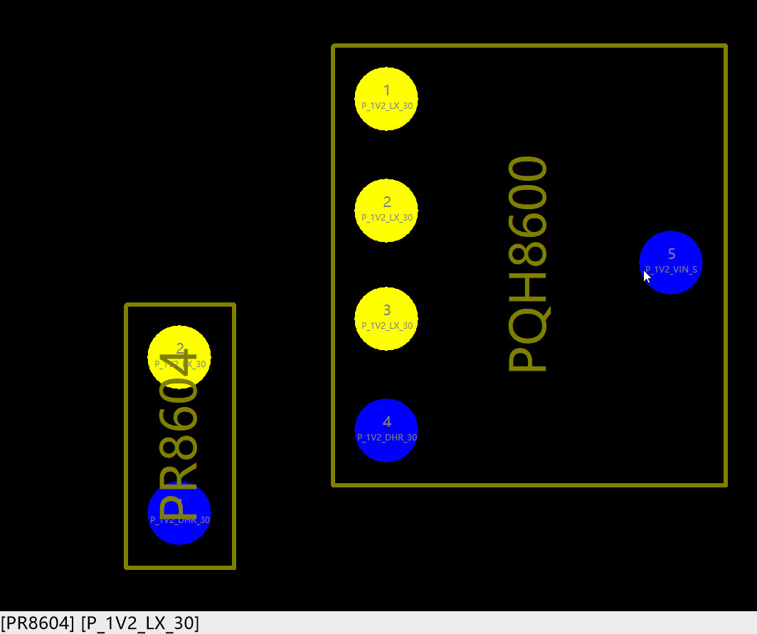

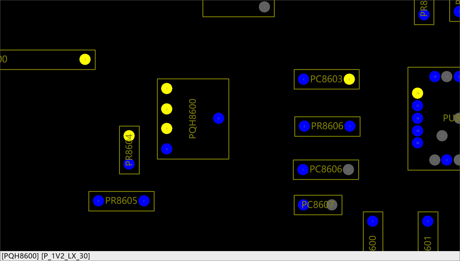

        Posting some details from the boardview for this logic board.
                Hello mon2,
                Thanks for the pictures, however I dont have any frame of reference for the given pics, I dont know the location or what the components are.
                    Sorry mon2 I had my "stupid" glasses on, I see what it is thanks.

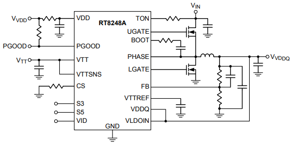

                        Hello Guys,
                        I have done some more digging and found this (see pic attached) DDR PSU controller
                        I guess for some reason the two FET where energized at the same time resulting in massive current passing through them so BOOM!
                        I would like to know why so I may put a scope on the controller and view the high and low gate drivers (maybe just a meter in continuity will work to see if there is a short?)
                        Am I on the right path and is there anything else I should consider?
                        Anyway thanks to all for there input and ktmmotocross for suggesting the controller.
                        PS I wonder if my memory module is ok, if it got hit with 19v I doubt it.
                        Is there a way of testing it without putting another laptop in danger?

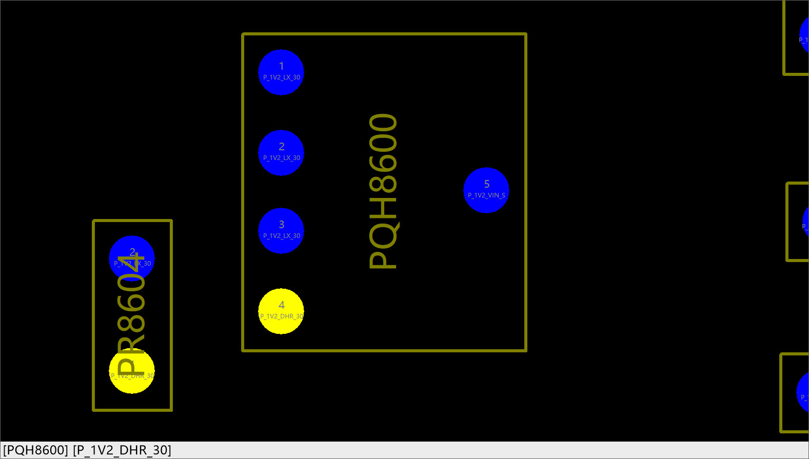

                          Anybody know the value of PR8604 in attached picture, I'm thinking it might be about 10k?
                          Many thanks.
