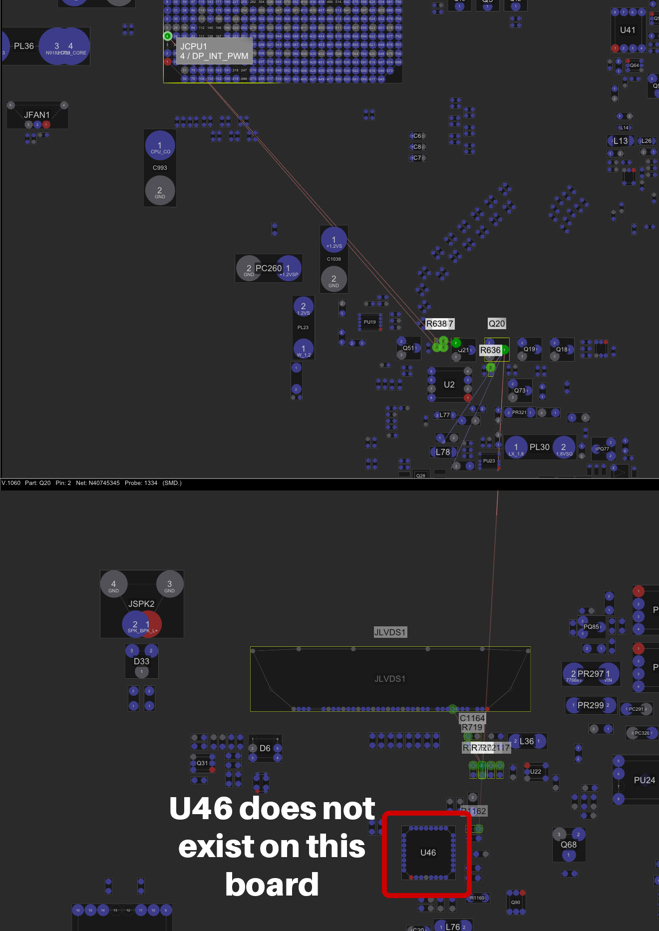

                  Review if there is the RTD2132S @ U46 onboard. It is the eDP to LVDS bridge. Confirm the components are present to power this bridge and that the lvds signals are reaching the lvds screen connector.
                  Perhaps the RTD2132 is defective. It is inexpensive on AliExpress.
                  Any chance you have the datasheet for the RTD2132S?
                  • beogeek
                    • Apr 2018
                    • 100
                    • Serbia
                    Re: Acer E1-531 Motherboard LA-8331P No Display
                    Nope, I don't have the RTD2132S on my board...

                          Wait...can the lvds display even function without the RTD2132S bridge?? Maybe it was removed by another tech?
                          • beogeek
                            • Apr 2018
                            • 100
                            • Serbia
                            I just checked again under the microscope and no it doesn't appear it was ever on the board as if it was there would be traces of work around it, what I'm trying to say is that it looks factory that U46 (RTD2132S) is missing...
                            • mon2
                              • Dec 2019
                              • 14657
                              Not familiar with this topic but it appears from page 2 of the schematic that at build time...
                              LVDs display can be used if RTD2132S bridge is on-board.
                              Or
                              eDP panel must be used if the bridge is missing.
                              Can you confirm that your display being tested is eDP interface?
                                        So this has turned into a nightmare, this is precisely why I hate working on machines someone else has tinkered with!
                                        First I'd like to thank @mon2 for the help, it led me down a rabbit hole I think I've managed to crack! But will have to wait for confirmation from the client on the history of the repair done in it!
                                        What I think has happened is that when the laptop died the client took it to a repair shop who did one of the following!
                                        1. Replaced the motherboard which was probably a Q5WVH LA-7912P which does have the RTD2132S, with the current motherboard which is Q5WV8 LA-8331P rev 1.0. which means that the display that is original is not compatible with the LA-8331P as it's not a eDP display...
                                        2. The board is the original Q5WV8 LA-8331P rev 1.0. which doesn't have the RTD2132S, but the display was changed for a 40 pin LED LVDS backlit display instead of a 30 pin eDP display!
                                        Those are the only two conclusions I have, this is why I think @mon2 is right, if the current MB doesn't have the RTD2132S then the display MUST be a 30 pin eDP display otherwise no picture! But both of my displays are 40 pin LVDS screens made prior 2015 and I do believe most laptops prior 2015 didn't use eDP! (I could be wrong..)
                                        So what that means is either the motherboard was swapped or the display was swapped causing the incompatibility! As I can't really find a fault with the motherboard other than the fact the CPU on the Q5WV8 LA-8331P board doesn't have any voltage at pin 4 and subsequently, the line ends up at pin 8 on the LVDS connector with 0v. Here's a compilation of images to explain what I mean.
                                        Now I could be wrong as hell but that is the only logical thing my brain can produce! I will wait for the confirmation from the client to see if they can find out what the previous repair was and what they swapped or changed...
