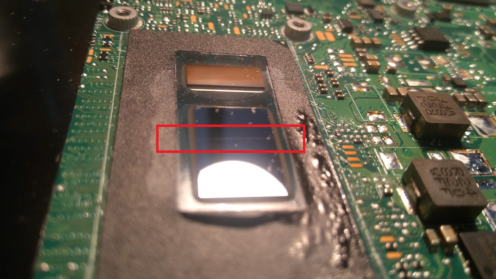

    Today i AGAIN have in hand some burned Intel CPU. now it is SR3LA (Intel Core i5-8250U). when i service AMD i have NEVER seen ONE bad mobile AMD CPU/offcourse they have bad NB/. But i have MANY Intel with burned CPUs. they tweak their obsolette technology to max so they goes bad by itself
    Today it is SR3LA - Intel Core i5-8250U in Asus X510UF. Special on this one is that NOTHING on board is bad except CPU. even CPU rails is ok. BUT the CPU die is BROKEN IN HALF
    Very interresting find

    Asus x510uf-i too have faced many mb's with cpu shorted though in my case nothing is cracked on soc die.Its 3v rail shorted coz of pch shorted. 3 mb's I've replaced soc with success.Btw, amd soc fails almost equally as intel in my experience. Newgen ryzen r dying like a fly.

      I always change the pch power ic whenever I replace soc

        so u guys dont have problems with replacing intel BGA CPUs?
        this board horribly twisting with heat

          i have one asus x431uv with dead pch, but as new cpu bga costs too much i didnt repair it.
          110-200€ for new cpu bga is insane... if someone sell trash or bad bga then u wasted too much money on it..

            that same foreverybody, but i mean replaceng CPUs with CPUs from donor boards. i try to reaball but this ballsissotiny and many ofr them stick to the stencil
