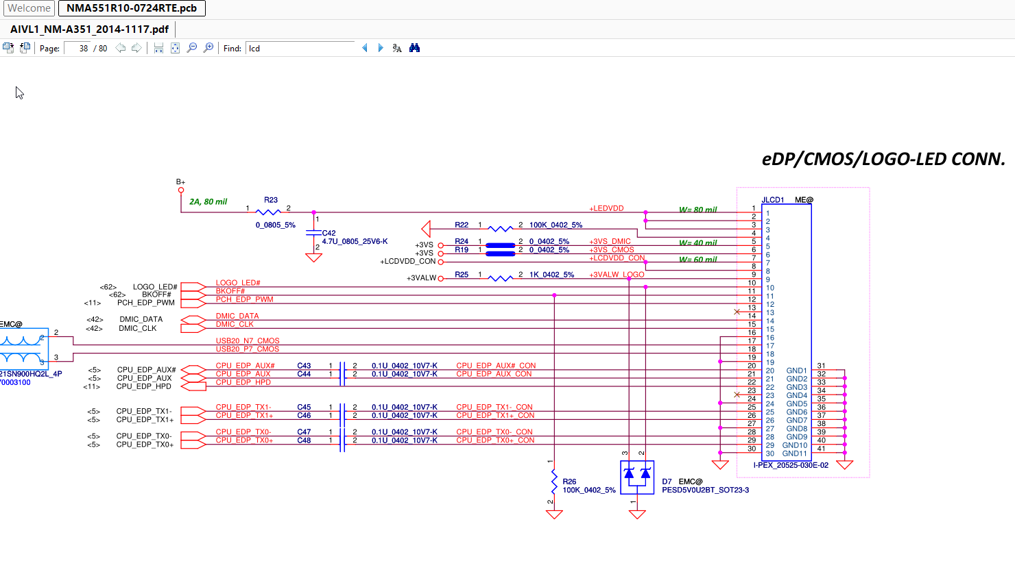

    I have here lenovo l450
    Motheboard is : AIVL1 NM-A351
    Laptop has no picture and no backlight,but on VGA I have a picture.
    First i checked if i have all voltages on lcd connector.
    I have every voltage except +3vdmic,but i think this is for microphone ?
    Please help me !
    Display is ok,I tested it on another laptop.
    Here are schematics i found,there is for be460 and nm-a351 : https://www.badcaps.net/forum/troubl...hlight=nm-a351

          Check if your Super I/O (EC) is generating the signal to enable the display. If the LVDS cable was removed while the MB had power it could have damaged the Super I/O.
          I have a similar fault at the moment with the exact same symptoms and I've traced the fault back to the CPU... SO I will replace the socketed AMD A8-4500m and check as everything else is fine on the board, you may potentially have the same fault. I suggest you start at the EC and go from there. Do you have a board view file?

              What is the part number for the display? Make sure it is indeed EDP and not LVDS.
              This LCD is driven by signals from both the CPU and the PCH. The main ones to consider are PCH_EDP_PWM, which controls your backlight and BKOFF#. The former is a pulse width modulated signal, duty cycle will determine how bright your display is. If there is no activity on this line, your backlight will not work. BKOFF# comes from the EC, and I believe this should be low, but without the panel datasheet, I can't confirm.
              The most common thing I've seen is damage to that PCH data line by inserting the display cable with battery connected.

                According to the schematic, it is EDP style of LCD.

                  Yes it is.
                  Display Model No : B140HAN01.2
