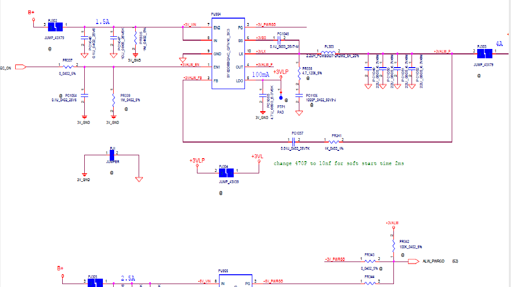

09-28-2021, 02:13 AM
B+ 20V is OK
But +5VAWL and +3VAWL cannot get
Please Advice [/ATTACH]

09-28-2021, 06:25 AM
Re: LENOVO G40-70 no power
For +3/5 ALWS you need the check on PU904 test pin 1/2/7/5 on PU905 test pin 1/2/8/7 feed back

09-29-2021, 10:03 PM
Originally posted by
techtiger
View Post
After Chaining PU904 and 5, Board is OK.
But Another board is not ok, because i cannot buy this components in our country (myanmar)
Thanks for reply

09-30-2021, 10:47 PM
techtiger
View Post
Dear Bro TechTiger
How to call PU904 and PU905, I want to buy this component.
Please Tell me more.

10-01-2021, 12:26 AM
US $1.60 16%OFF | (5piece) 100% New SY8206B SY8206BQNC (ND5MC ND4LL ND3NA ND2CZ... ) QFN-6 Chipset
https://a.aliexpress.com/_mN4nIBs
US $1.51 16%OFF | (5piece) 100% New SY8208CQNC SY8208C SY8208 (MT3UC MT3TD MT3CC MT3FA) QFN-6 Chipset
https://a.aliexpress.com/_mPWGXcq
