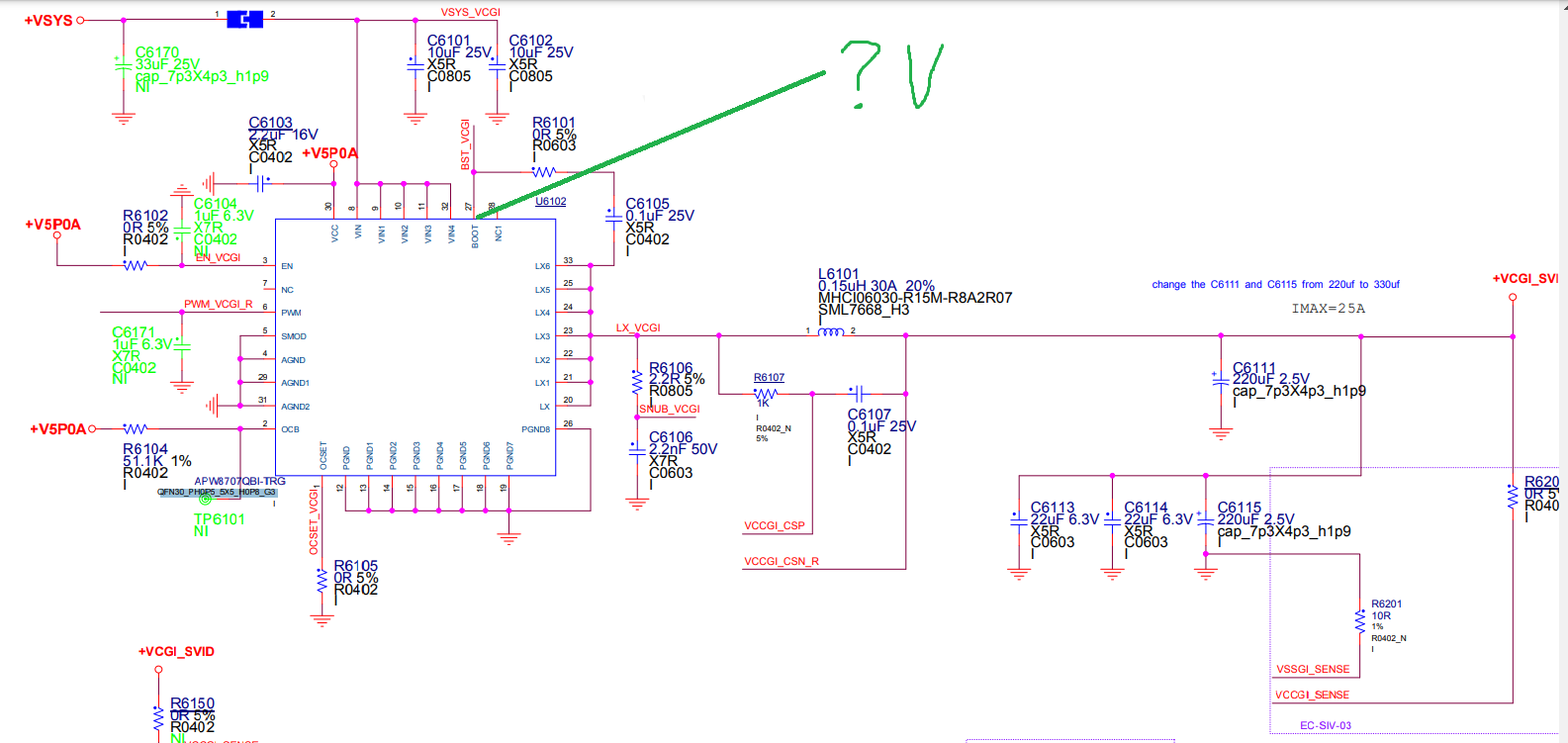

    I have a Lenovo 330 (Yoga 330-11IGM Laptop (ideapad),Yoga 330-11IGM, Flex 6-11IGM) wich powers on but no image and only consumes 1 watt at the 230v adapter. It does charge the battery with or without ac no diffrent.
    YOGA330+MB_V06
    I measured the coils:
    U6002 > 3,3v 2,4k ohm
    U6001 > 5,2v 300k (and less) ohm
    U5901 > 12,9v 114 ohm
    U6102 > 0v 19 ohm
    U6104 > 1v 77 ohm
    U6103 > 1v 27 ohm
    U6105 > 1,2V 222 ohm

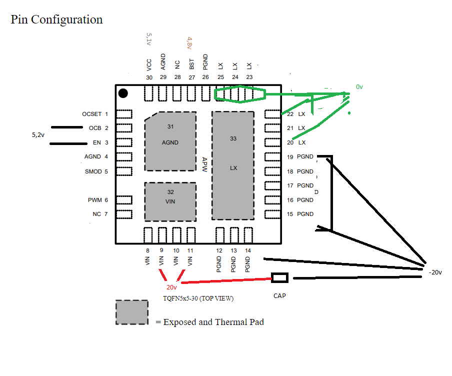

    at U6102 is a mosfet apw8707 located, I attach image.
    I do not have schema, what would the best steps to take so the possible issue can be found/fixed.

    Re: Lenovo yoga 330 powers on no image
    I found some more schematic info, does anyone know what should be present at 27 ?
    And what (flexiable) voltage should be present on LX ?
        If this ic is used in vcore circuit, then close to 1V is expected on BOOT pin.
          Here is the schematics! Should make life easier!
