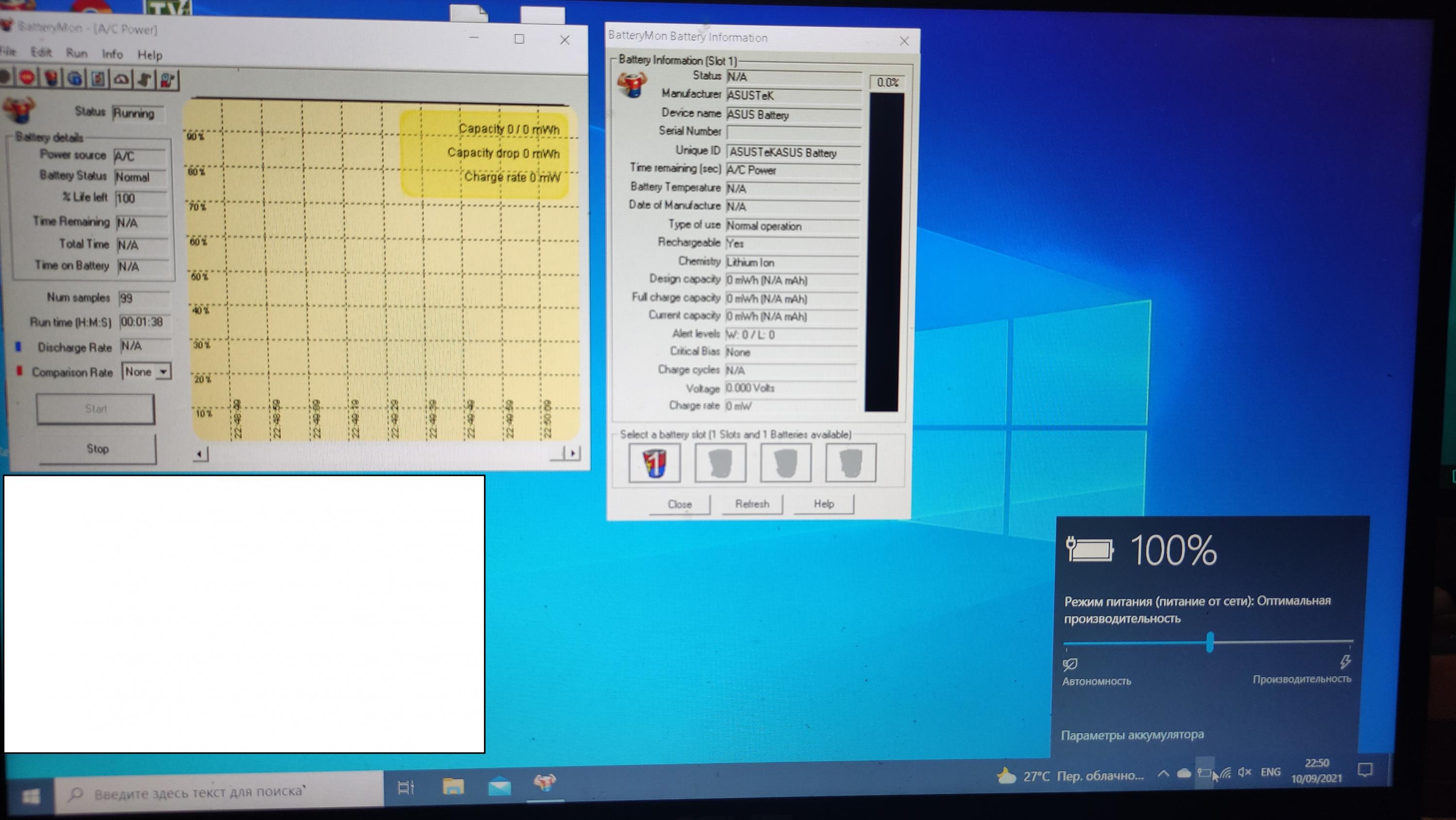

    the laptop doesn't work with battery and doesn't recharge it, although it shows that it is 100% (even when it is disconnected).
    Battery voltage measurement:
    pin 1 and 2 (+) shows 0.85v
    4th and 5th - jumps 3.23v-3.28v
    6th - 2.91v
    no 3rd pin, 7 and 8 are gnd
    I looked for a #EN short for the battery on the board, but couldn't find it.
    I also did a check with the BatteryMon program (photo attached).

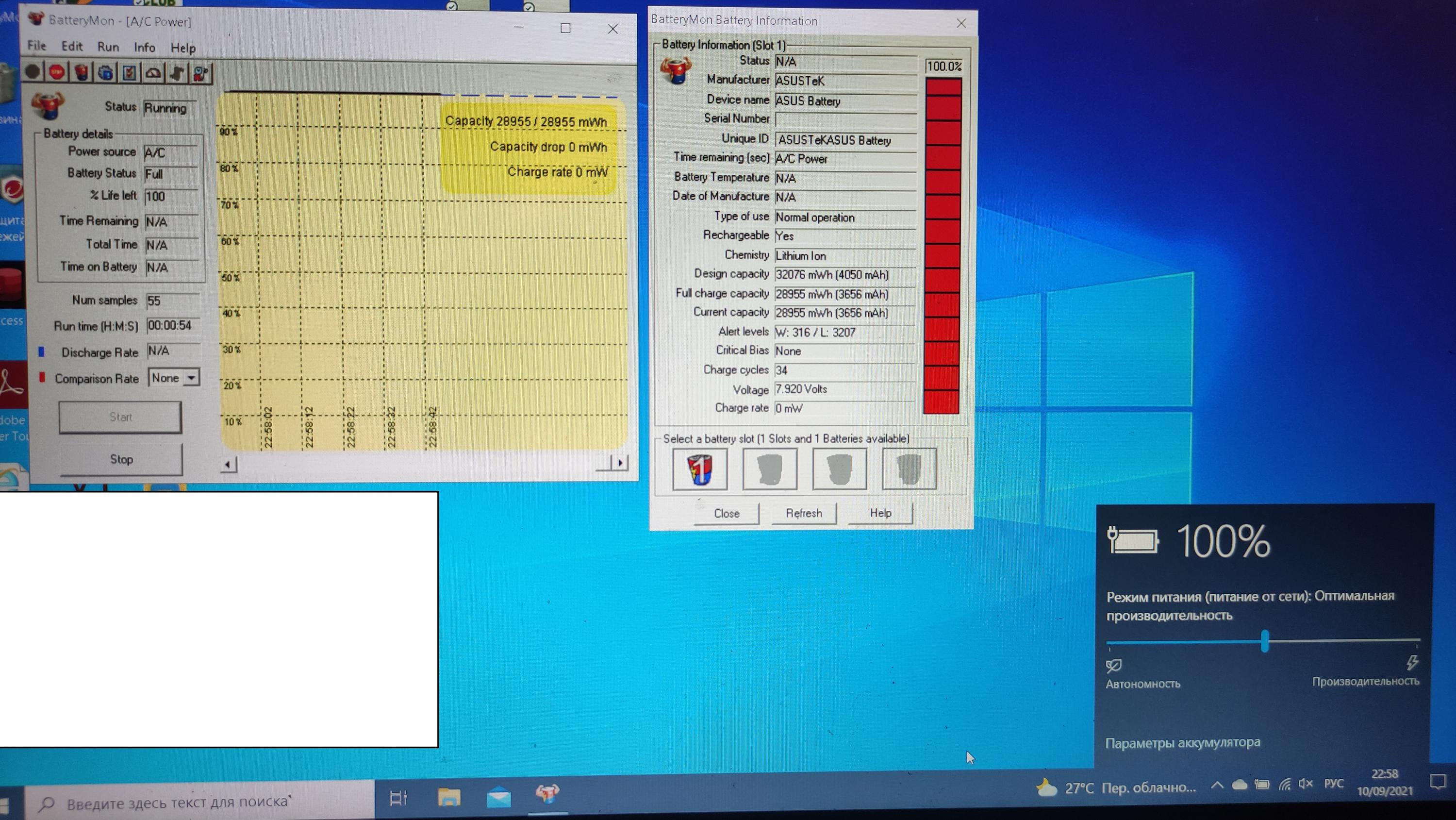

              Tried today to charge the battery with a power supply, but no luck, it's completely empty and not charging at all

                        Ok, got it, so my only solution for now is to find a good battery.
                        Thanks guys, I'll update as soon as I'll find one
