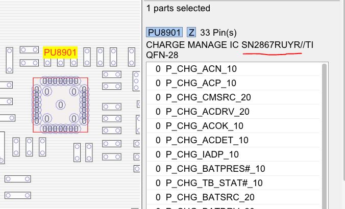

    Hi hope someone can help me I have a burn charger Ic but I dont know what tpye of cahrger Ic was this unit is using.
    I also tried a BQ24780S but I was getting a 6V at may AC ok Signal , its very hasrd beacause I cant find a schematic for this unit.
    I tried to test the resistor that is close to pin 5 of the ACOK of the Ic it values around 0.3 omhs is it normal?
    • 22093
    Re: x407ma rev 2.1 charger IC?
    boardview - https://www.badcaps.net/forum/showthread.php?p=1068431
