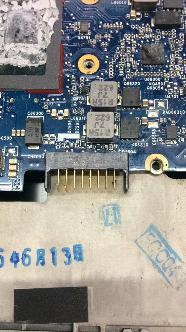

    hello
    i have an hp 820 G3 motherboard 6050a2725001-mb-a01 turn on with no display num lock is blinking 5 time and,i have flashing bios,change the RAM,all voltage is pesent.idont now if bios or other part in motherboard
    pleas help

    5 blinks = system board error.
    https://www.badcaps.net/forum/showthread.php?t=95754
    see the posted post codes chart.
    What is the history of this logic board? Any liquid spills ?
    Just decided one day to start with this 5 blinks code ?

      no liquid damage,no short,the customer informed me that the laptop is often in extended sleep mode

          Re: elitebook 820 G3
          i have 2 coil without voltage in
          • mon2
            • Dec 2019
            • 14153
            1) Power down. Remove the adapter and battery.
            2) Meter in resistance mode (200 ohms scale).
            Check the resistance to ground for each of these 2 coils that are missing the voltages.
            What is the resistance for each coil ?
            3) Post clear pictures of each coil and local mosfets and switching power supply IC. Post the markings on each mosfet and IC that is linked to each coil.

              resistance o 2 coil =6.7ohm

                this datasheet of the ic u66310 driving the 2 mosfet then sw1,sw2 goes to coil

                  voltage on NCP81152:
                  BST1:5v
                  PWM1:2.0v
                  EN1:4.9v
                  VCC1:5.1v
                  BST2:5v
                  PWM2:2.0v
                  EN2:4.9v
                  VCC2:5.1v
                  DRVL2:0v
                  GND2:0v
                  SW2:0v
                  DRVH2:0v
                  DRVL1:0v
                  GND1:0
                  SW1:0v
                  • mon2
                    • Dec 2019
                    • 14153
                    Is the mosfet driver linked to Q66310 & Q66320 in the shared photo?
                    Are the measured voltages with a connected battery?
                    If not, measure again with the battery to see if the following lines change their values (with battery):
                    DRVL2:0v
                    SW2:0v
                    DRVH2:0v
                    DRVL1:0v
                    SW1:0v
                      yes sir
                      same voltage battery in
                        Check to see if the mosfets are shorted.
                        Remove all power and battery.
                        Check the resistance between source and drain for each of the above mosfets.
                        Repeat measurements for source & gate; then drain and gate for each.
