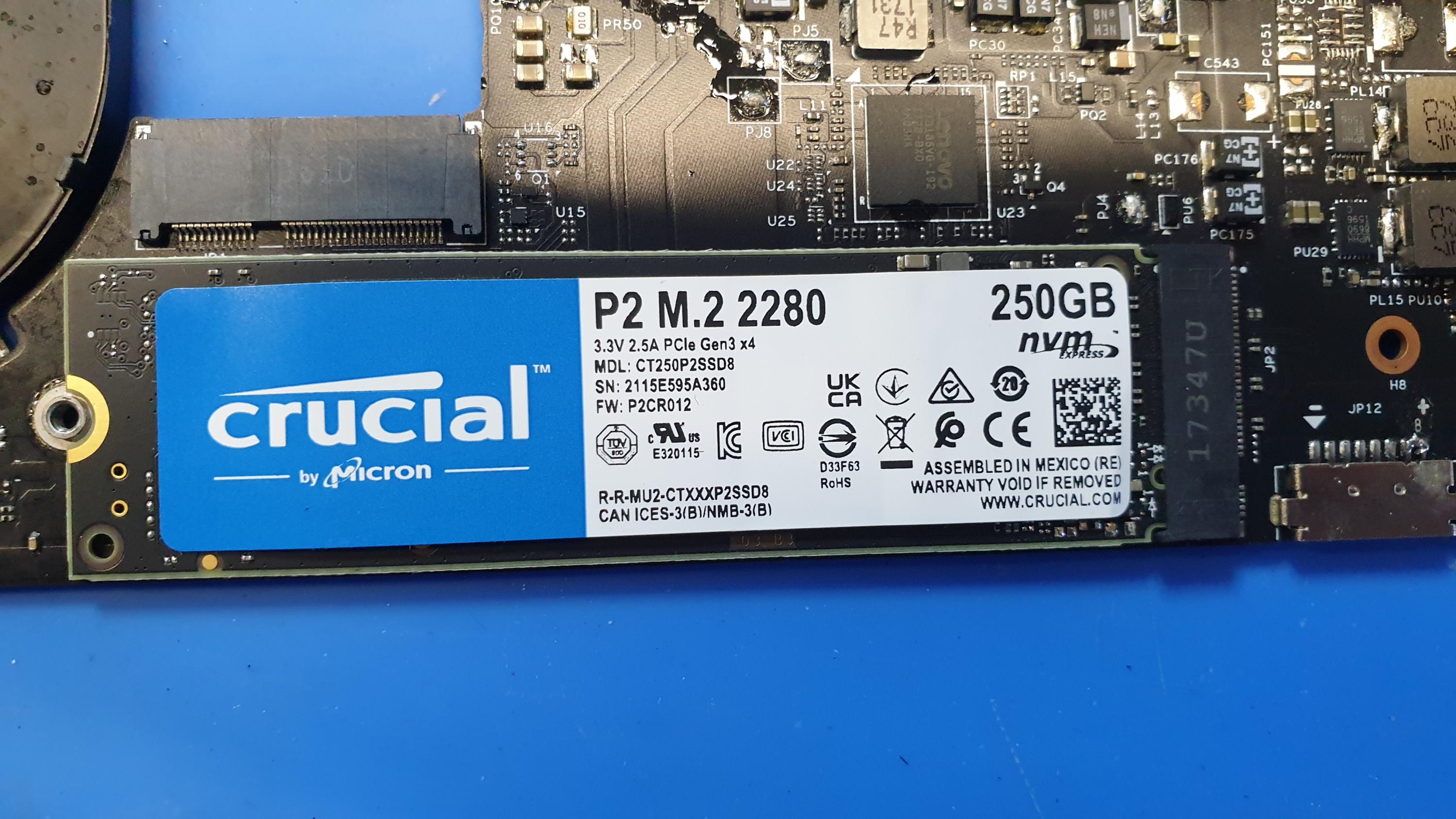

        Sorry to have wasted your time. Correct, the one pictured below just worked.

          This used to annoy us to no end on Asus laptops... Same model different termination, one took NVMe only, one took SATA only. Very bad time when you had to ship a laptop with a m.2 SSD upgrade and you realize you ordered the wrong kind after it arrives and you plug it in and it doesn't work.
          A working TV? How boring!
          • sikocan
            • Oct 2019
            • 347
            Re: Lenovo Yoga 920-13IKB Not Detecting SSD
            Yes this SSD naming convention is not very clear and super annoying. If it isn't compatible, it physically shouldn't fit in. Not only this but even installation can be difficult for example, this Lenovo you can't use NVMe SSD that's double sided, it doesn't fit in nicely, the SSD socket isn't high enough to accommodate double sided chips.
