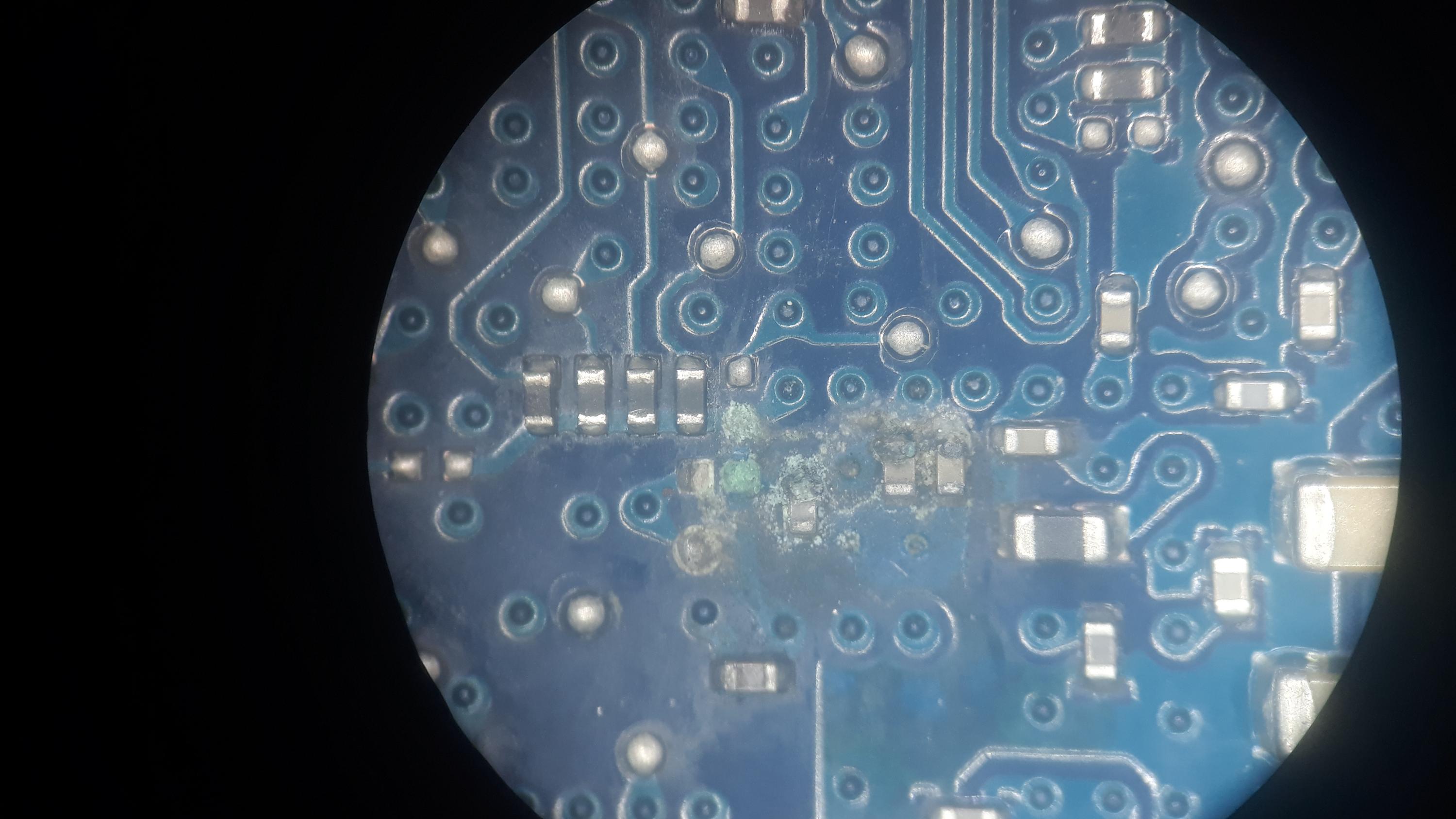

    Help me guys missing component
    ACER A514-52K NB8517_MB_V2
    Back of the processor

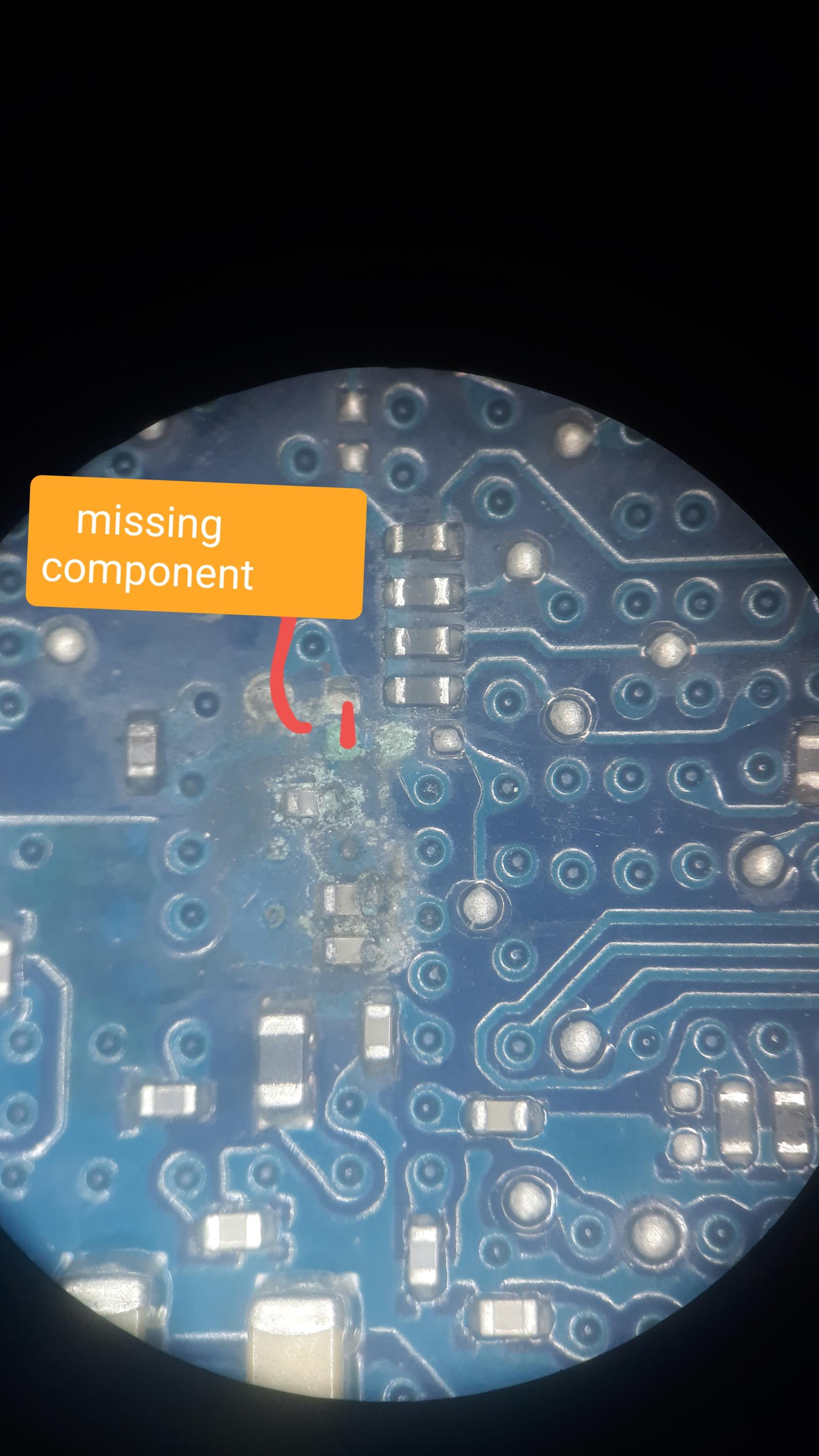

    Re: Help me ACER A514-52K NB8517_MB_V2 missing component
    Check if one of the two pads is GND, then its likely to be a capacitor.

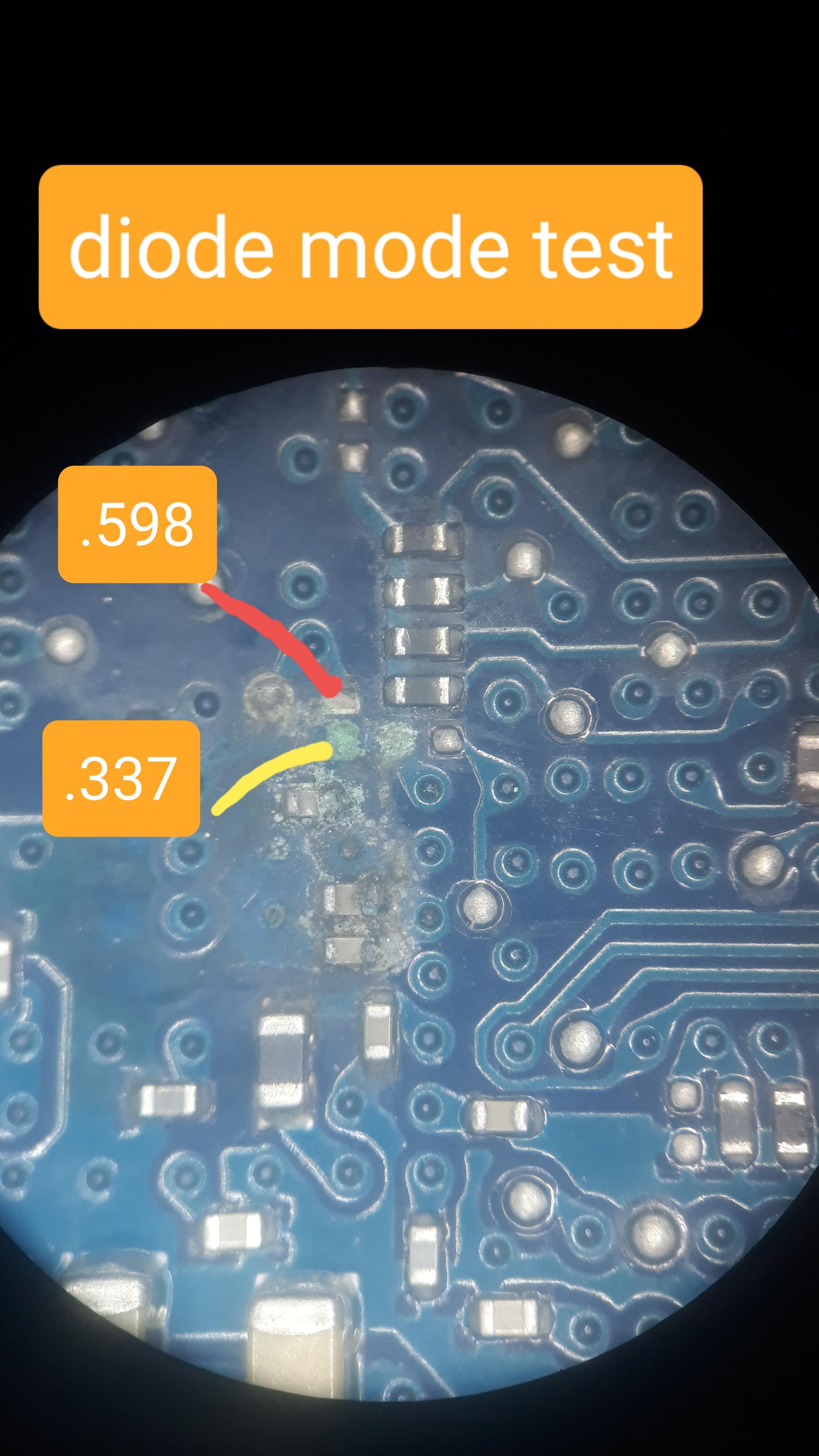

      Here is the test in diode mode
        Seems like a missing resistor but cant say with 100% surety. Unfortunately i dont have such a mb in hand so cant be sure.
