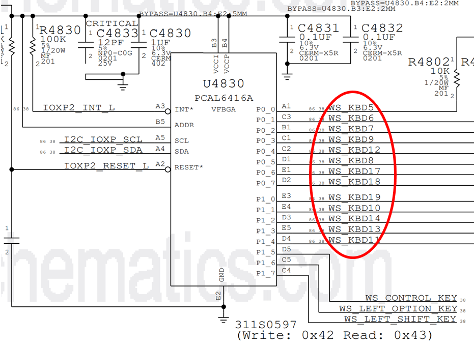

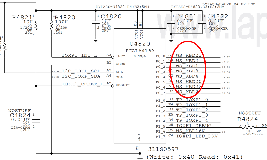

    Hello everyone!
    I'm having some issues with my Macbook Pro Retina 15” A1398 EMC 2909 keyboard. Some keys are not working properly. Keys: D,F,G,H,J,K,L, all same row keys.
    I'm using 820-00163 schematics to track the keys, but I don't know which set of WS_KBD these keys belong to. Is there any guide for that?
