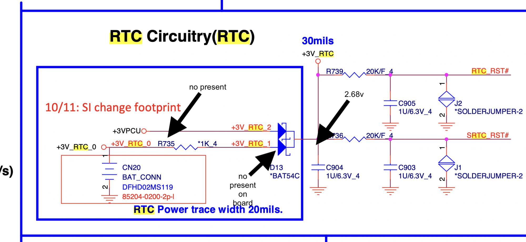

                        I've Checked capacitor c905 on RTC section and it is short to ground; checked the same cap on the spare motherboard and it is no short.
                        I think that c905 is damaged and i have to replace it.
                        ok, replaced c905, now the readings are:
                        J1→2.64v
                        j2→2.64v
                        but the motherboard doesn't power on.

                          Re: HP pavilion 17-e101sl motherboard no turning on
                          Nice to see you fixed RTC fault. Voltage at J1/J2 seems fine now-so we can assume more or less that RTC section is fine though there are many other things to check on RTC but we left that for now.
                          AFAIK, EMU_LID is just another name of LIDSW#. If that is correct it must be 3V. You need to find out where the lidswitch is located. Most likely on powerbutton board. BTW, you are turning on the mb with power switch connected?? If yes, then remove the power switch board and check EMU_LID voltage again.

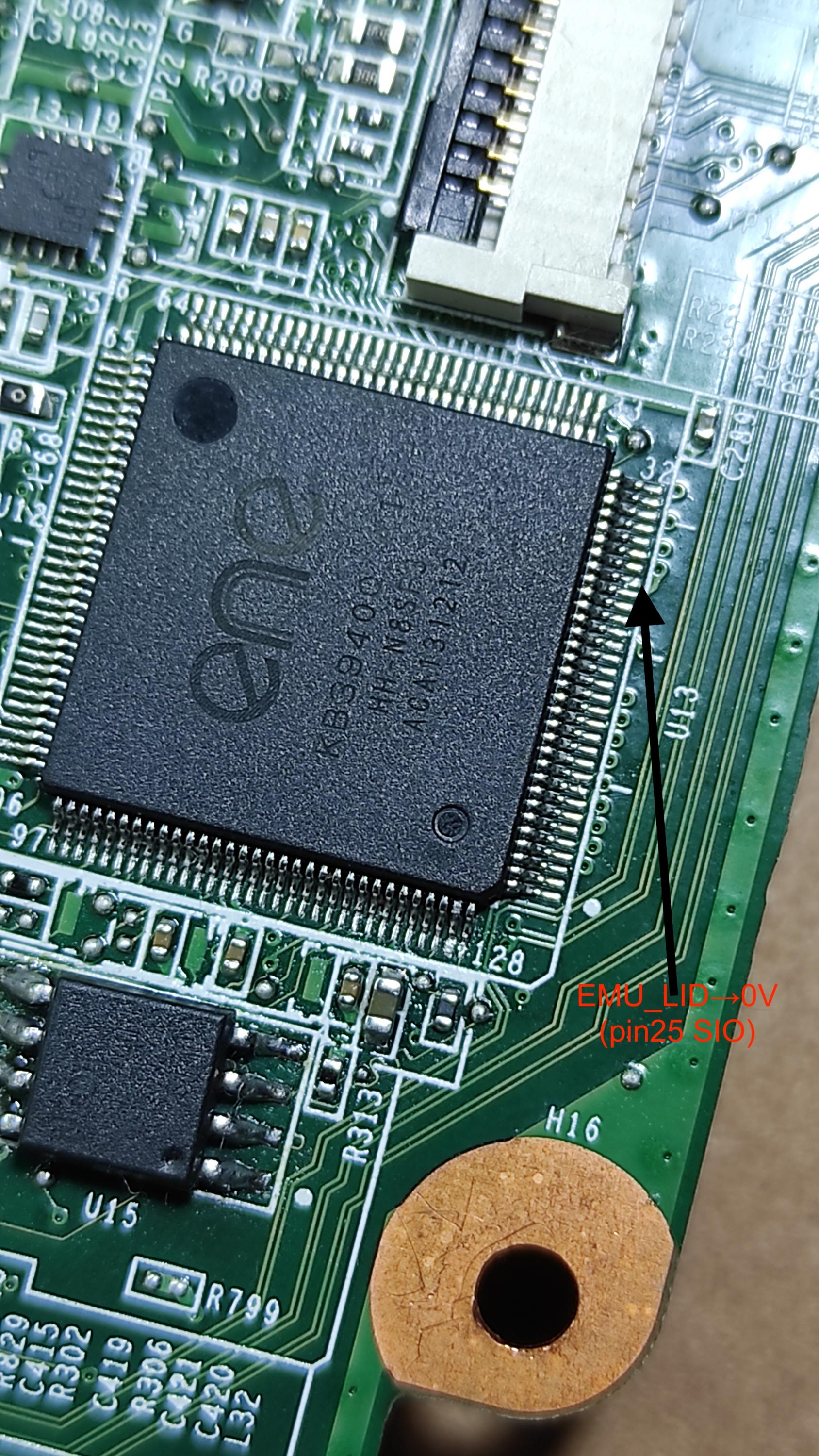

                            LIDSW→3.35V (please see attached pic)
                            Removed the power switch board, EMU_LID (pin25 SIO)→0V (see pic)
                              Oops, it seems like LID_EC# is what is popularly called LIDSW# and that;s reaching the SIO. So everything seems fine with LIDSWitch.
