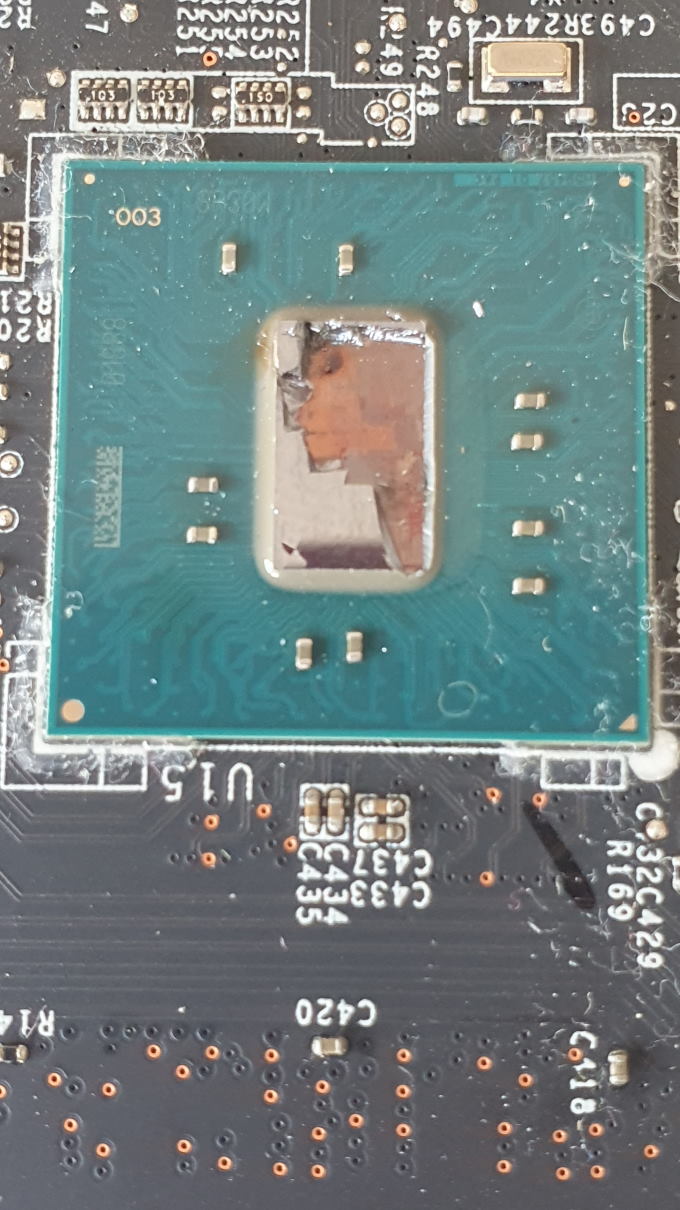

    Hello, I have a MSI GP62M 7RDX, MB : MS-16J91 rev 1
    Schematic posted in this page : https://www.badcaps.net/forum/showthread.php?t=84710
    I saw that the PCH is broken, and it has a brown stain (gone after scratching and no trace on copper).
    Do you know if cracked nickel on PCH means it is dead please ? I found another issue ; 3v line shorted and that could explain why the laptop don't start (no light, no led, nothing after pressing power button). And I don't saw anything shorted around PCH, but I don't know how to check it.

    One small crack or chip is enough to kill it, its as dead as a dodo

      Ok, thanks, so no fix for this one.
