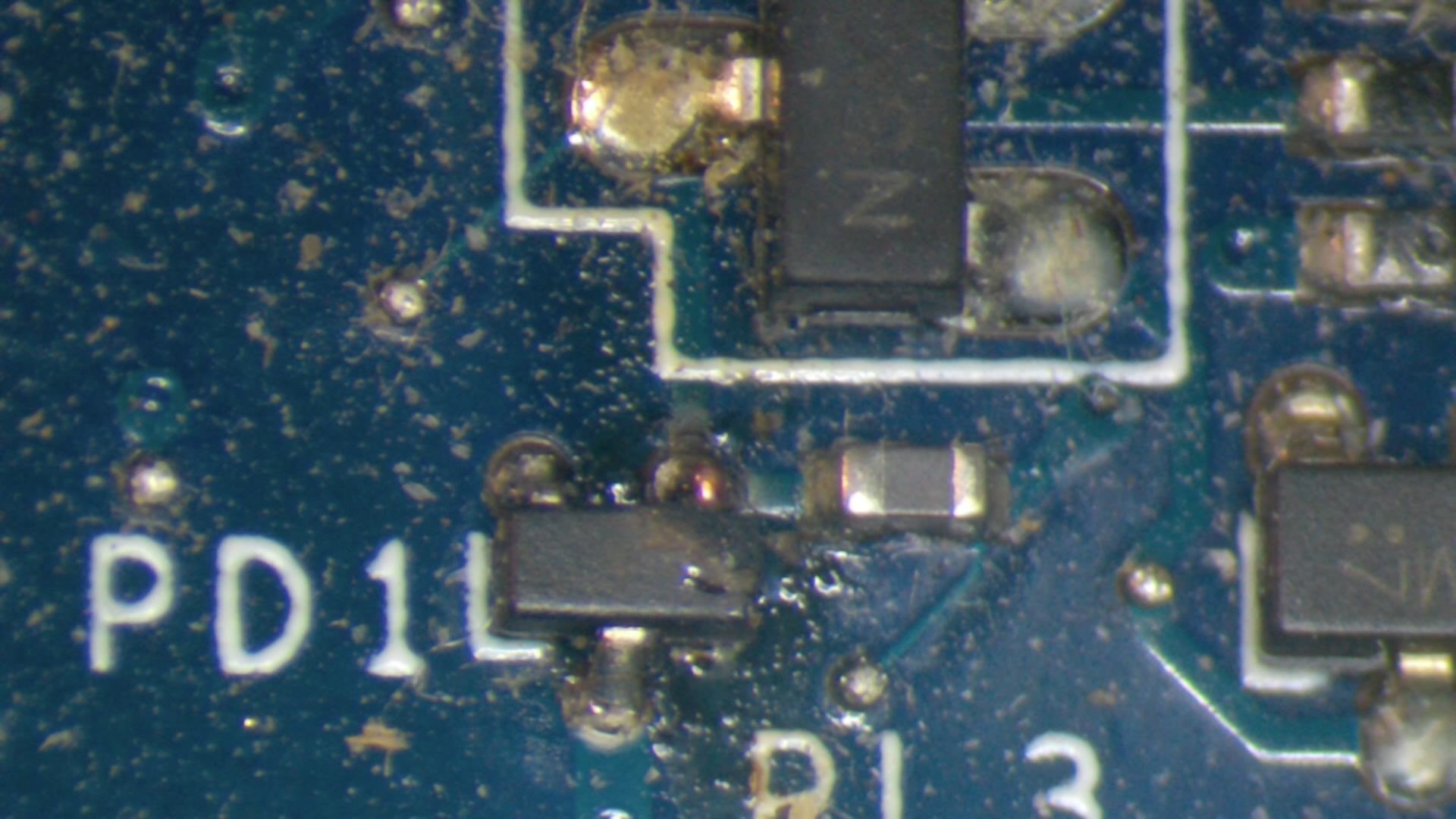

    Found the problem
    According to the Schematic (Page 53) PD1 part number is TVNST52302AB0_SOT523-3
    Googling the part number leads me to Mouser with parts that have the same package size. Or other schematics that have the same part.
    Where do I get, and know if I'm getting the right part?
    Is it a common/standard part on Dell laptops if so can I find it on another dell laptop, I have a box full of older ones made in 2009-2012?

    Hi. The referenced part, PD1 is a transient TVS diode. This component protects the attached voltage rail from being damaged from sudden bursts of energy caused by static discharge or similar events. This part will clamp the energy to ground to protect further damage. Often such parts are sacrificial in that they will die to protect the rail.
    On this note, they are not immediately required for the design to work but a damaged part could impact the operation of your logic board.
    For now, you can remove this part off the PCB. Just have to be careful about static on your body.
    The part can be replaced by many similar devices in the SOT-523 package such as the following from Littlefuse:

      Removing PD1 will let the mb to charge perfectly but protection is gone. Quite a common problem on LA-F115P mb.

        Replaced PD1 and PC worked perfectly. Thank you

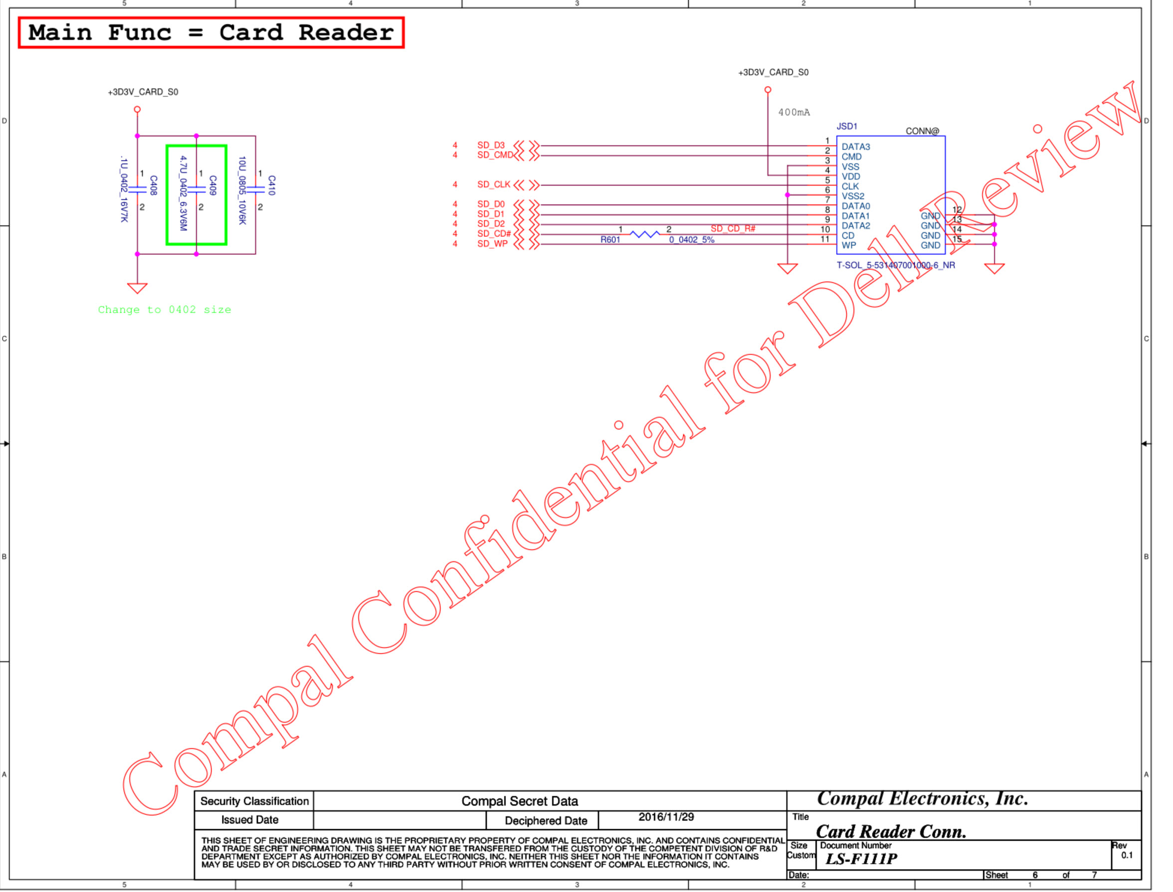

              I have donor motherboards for the Inspiron 5570. The schematic indicates that PD1, PD5, and PD6 are all TVNST52302AB0_SOT523-3. PD1 is connected to the charger sense pin, while PD5 and PD6 are connected to the battery data and clock pins. That makes it easier to find cheap replacement parts. Thanks for the schematic!
              • dana.repouille
                • Feb 2023
                • 39
                Re: Dell Inspiron 15 5570 Plugged in not charging
                Not familiar with Dell boards but check near the USB connectors which may offer a similar part to protect the D+ / D- USB 2.0 interface.
                The Dell Inspiron I/O daughterboard (for USB 2.0, SD card reader, and CR2032 battery) is LS-F111P. It appears to have a similar TVS diode labeled DI1 next to the USB port. However, it seems to be a different part number than the three TVS diodes on the motherboard.
                Is a schematic for the LS-F111P available for download?

                  Attached.
                  L30ESDL5V0C3-2_SOT23-3
                  • dana.repouille
                    • Feb 2023
                    • 39
                    Thank you. Even though the TVS diode on the daughterboard is in the same SOT23-3 package, it has a different part number than PD1, PD5, and PD6 on the motherboard. I assume it has different thresholds, so it would not be safe to use it to replace the other three TVS diodes. That may be because the USB port uses 5V, while the data lines on the motherboard use 3.3V. Just guessing here.

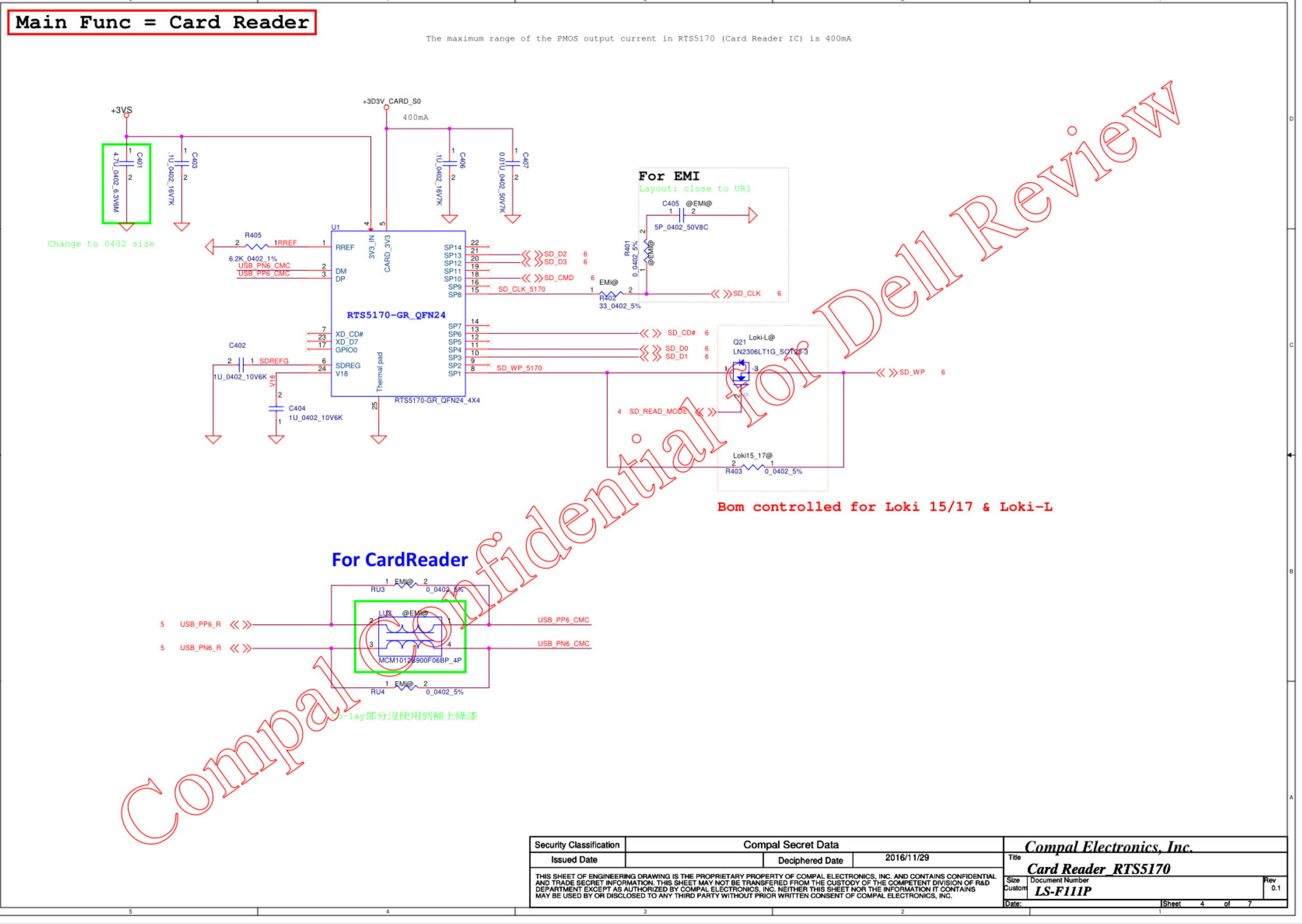

                      Oh wait. The three packages on the motherboard are SOT523-3, but the package on the daughterboard is SOT23-3. It's easy to miss that difference!
                      • dana.repouille
                        • Feb 2023
                        • 39
                        There appear to be four TVNST52302AB0_SOT523-3 packages on the motherboard. In addition to PD1, PD5, and PD6, I think EU4012 is the same package type. It appears to be connected to Pin 2 of JFP1, the fingerprint reader connection. However, when I look for it on LA-F115P TOP.pdf, it appears in the middle of the board, nowhere near the fingerprint reader connector. Now I need to examine the motherboard under a scope to find EU4012.
                        I'm just looking for all the spare TVS diodes that I can harvest from donor boards to replace blown PD1, since it seems to be a common failure point (by design).

                                      I just now removed a blown PD1 from a motherboard, and it worked (charged the battery) perfectly! However, the SOT523-3 package is so darn tiny that I can't imagine how I am going to install a replacement onto those tiny pads.
                                      I have a digital camera with zoom, as well as a 5X magnifying lens, but performing soldering miracles at that level is just insane. I don't know why the companies that make these magnifiers mount them onto an "adjustable arm" that shakes with the work surface.
                                      And not to mention that when I removed the blown PD1 diode package, I noticed that two of the three legs came off. That may have happened because the shell was damaged and structurally unsound, or maybe because my tweezer hand was a bit shaky.
