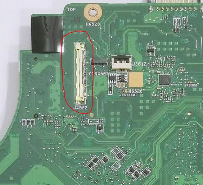

    Hello everybody
    the laptop has no display but with HDMI I get the signal to external monitor signal, I have already cleaned the mainboard unfortunately did not help me
    is there also a circuit diagram?
    can jamand help me further?
    thanks

    Re: Medion Laptop MD99310 Mainboard C15M REV2.0
    You don't need Schematics for some Basic Things and for Medion there is rarely Something Like that available.
    Start with Sharing a HQ Picture of the internal Display Connector.
    The easy way Would be to Check with another working Display First before troubleshooting the motherboard.
      I have windows 10 via external monitor with HDMI but not laptop screen
          The simplest way:
          01.Check whether its LVDS or edp
          02.Check no of pins on lvds/edp connector-30 or40 pins.
          03.Grab any schematic with similar connector
          04. Now you can check what is missing.

                • 22151
                Originally posted by samtron786
                how do you mean
                I've already used HDMI as an external monitor, I see everything
                Take a good clear picture of the display connector on the motherboard. See the attached picture ,the area circled in red
                  EDP means Embedded Display Port
                    OK thanks
                    I also cleaned but didn't help, I take a picture
