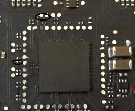

            Sorry to crash your topic, but i've also done the conversion, but i get garbled screen for a few seconds and then goes full white, like only backlight is on...what have i missed? i have like 2 or 3 schematics with drawn ways on how to connect the bypass, and they are simmilar, so i thought one is updated to cut the time or wire length, and i did something wrong obviously...
            And are the small resistors important around the gmux chip? Because i think 2 of them are accidentaly gone...but i thought since it's a bypass they don't matter.... they are rounded in the image attached....
