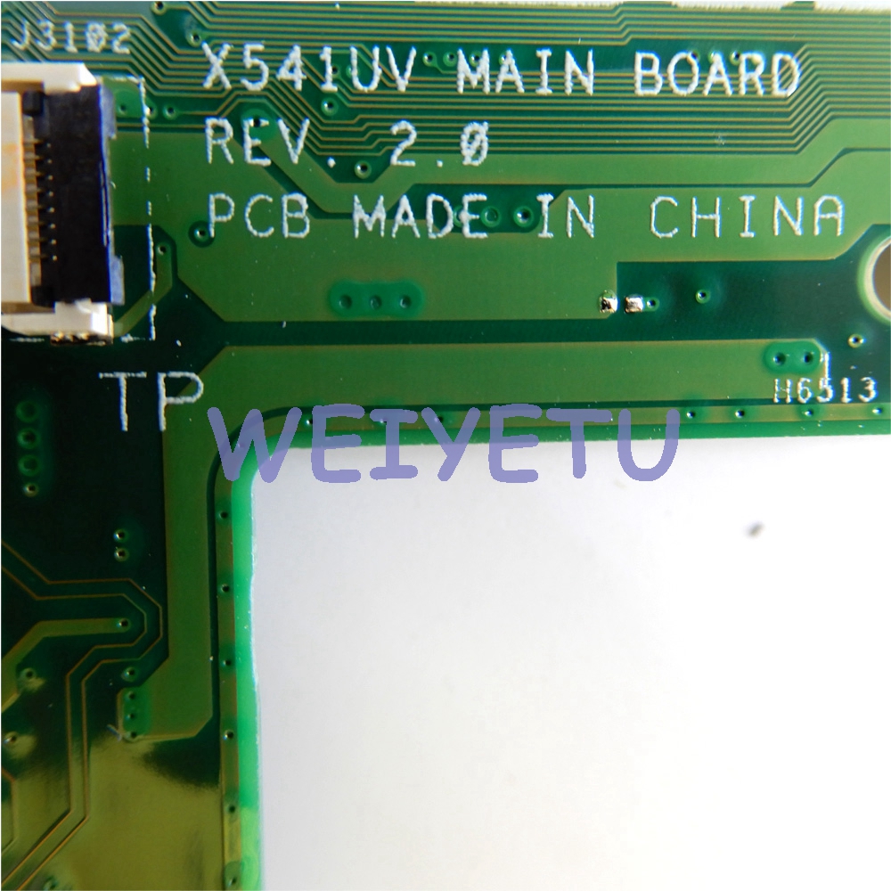

    asus x541uv RAM disable
    I have a cor I5 asus laptop the internal ram of the board has been damaged so I removed the ram chips but it did not recognize the external ram
    Please Help

      Re: asus x541uv RAM disable
      I tried this method and it didn't work
      Do you have any other solutions?
        I post boardview on schematic request, you can trace wich resistor neeed to shift. I've succesfully once but i forget where picture & video i save. i'll try to search.
          Thank you for your reply
          The motherboard is x541uvk
          And this is a file
          BoardView
          in the attachments
            Shift R2180>R2181, R2182>2183, R2184>2185. All three are 10Kohm resistors.
