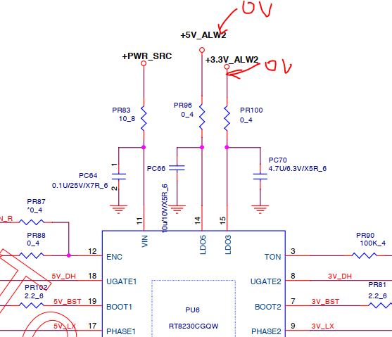

      3v ldo =0v 5v ldo = 0v

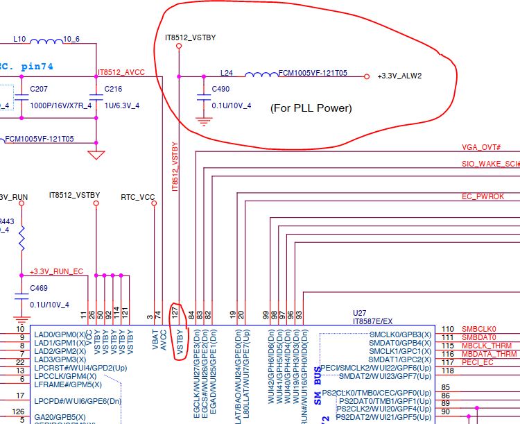

      3VLDO shorted to the ground
      but nothing gets hot and no consumption on power supply .
      I desolder the power ic but short still exist with 0.01ohm to the ground
      what does it mean that ?

              1) voltage on pin 12 (ENC) of PU6 ?
              2) With the power OFF. If you remove PR96 & PR100, what are the resistance readings to ground on the respective +5V_ALW2 and +3.3V_ALW2 rails ?
              3) If you leave the above 2 resistors OFF the logic board, do you see the local LDO output values on pins # 14 & 15 of PU6 ?

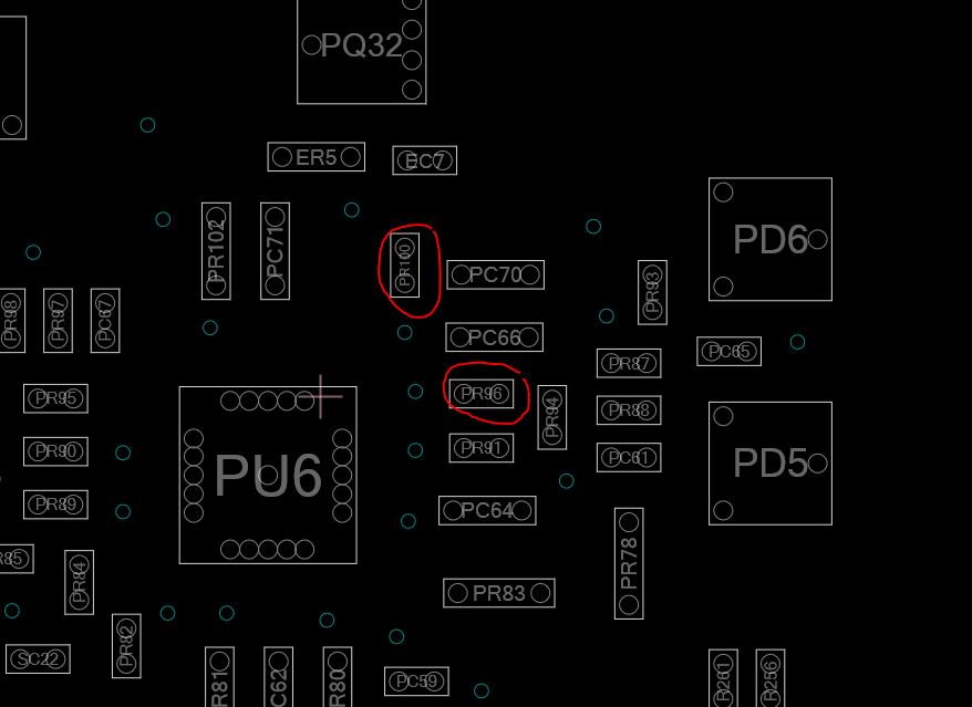

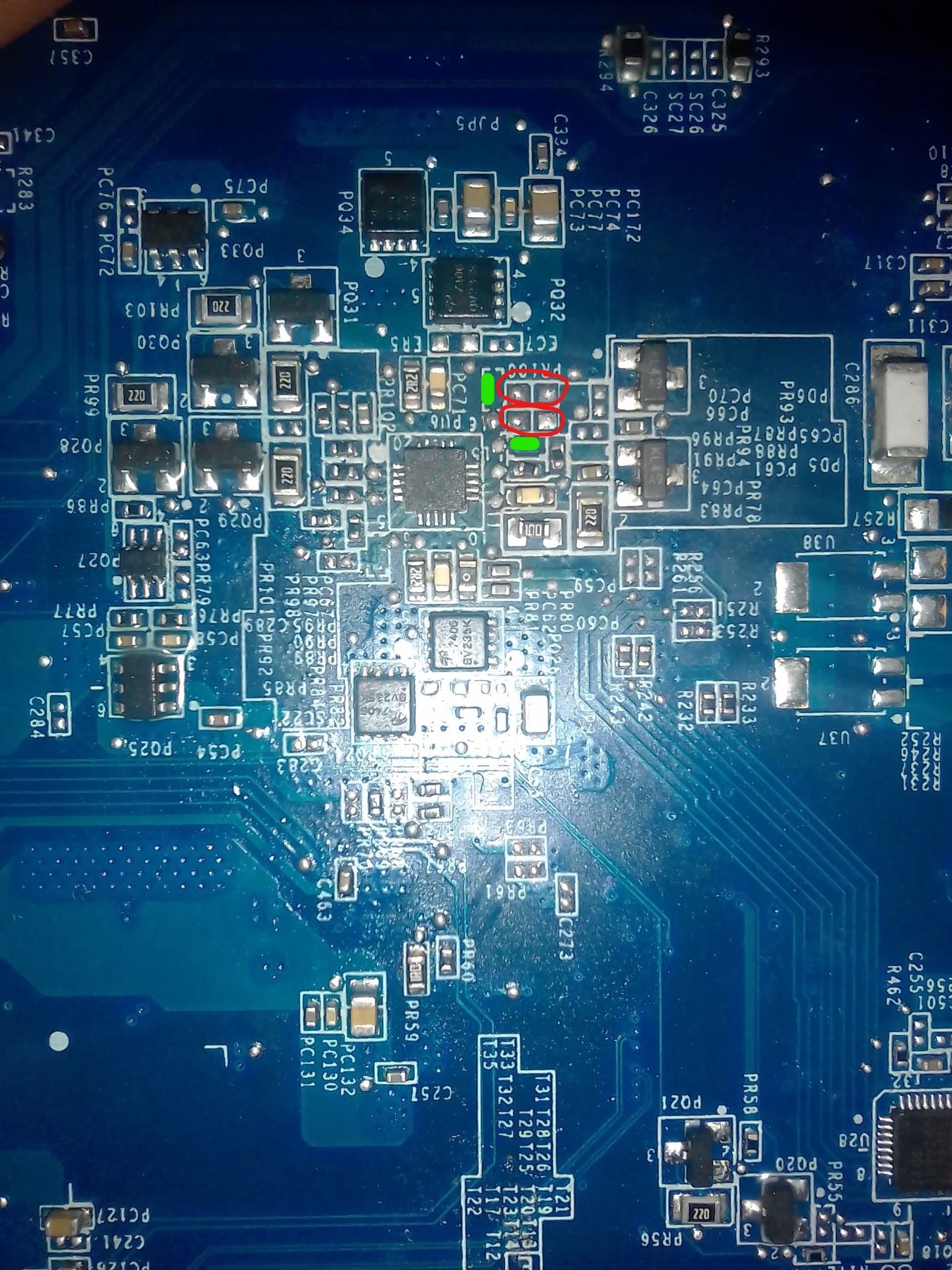

                i think something missing , the laptop comes from another shop
                PR70 PR66 missing and i can't found PR100 PR96 .
                pin12 0v
                pin 15 LDO3 shorted .
                from the boardview PR96 AND PR100 suppose to be where the green spot .
                help me to find them on the board .

                    If you suspect there are missing resistors, trace pin 14 & 15 of pu6 with a multimeter to the pcb pads of the resistors.
                    Do this with power off.
                    Once they are found, check the voltage again on pin 14 and 15. With the missing resistors, the ldo rails have to be ON.
                    The short must be AFTER the missing resistors. Correct?
                    Either way, PU6 is looking to be defective if these 2 rails are not always ON.
                    Be sure that you replace with exactly the same with the "C" version otherwise these 2 rails will not enable.
                    Pin 12 is not related to the LDO rails on the "C" version of this regulator. However, the "A" & "B" versions are and then the rails will not enable.
                    You need the rails on pins 14&15 to be always ON to power critical parts of the logic board including the KBC, etc.
                    Be sure that vin is reaching PU6. That is required to power PU6 and to feed the LDO rails.
                    Post your updates.

                      First no PR100 PR96 on this model just pads .
                      vin reaching PU6 on pin11
                      i remove KBC and the short is gone (kbc shorted on PIN127 VSTBY) no short on LDO3 rail
                      but still have no LDO3 AND LDO5 LDO3=0.04V , is this means PU6 is also defective .

                        i wonder in this model PU6 don't need En signal to generate LDO3 LDO5 or what
                        because i desolder KBC short gone but no LDO3 LDO5 .
                        from PU6 schematic
                        ENC
                        (RT8230A/B/D)
                        Master Enable Control Input. The LDO5/LDO3 are enabled if it is within logic
                        high level and disable if it is less than the logic low level
                        this means no LDO3 LOD5 without en signal so it's time to replace kbc and program it .

                            1) We do not know yet if PU6 is defective.
                            2) power down -> check and post the resistance to ground on LDO3 rail @ PU6, pin 15. Use the 200 ohm scale on your meter.
                            3) Post the resistance to ground on LDO5 @ PU6, pin 14.
                            If the resistance reading is very low then yes there is a short condition on the respective rail and the power rail is shutting down due to high current draw.
                            4) You mentioned that PR96 and PR100 are pad shorts? If yes, desolder these pad shorts to open up these LDO3 & LDO5 rails.
                            Power up.
                            Now, do you see LDO3 and/or LDO5 output the proper voltage rail value ?
                            If NO to either of these required always-on rails, then PU6 is defective. Replace with the proper version of this part - see my earlier post. The suffix "C" in the part number is important.
                            Source the exact RT8230CGQW device and replace PU6 if you do not see the LDO3 and LDO5 rails after removing the pad shorts.

                                    LDO3 ON 200ohm scale no reading , on buzzer diod mode 680
                                    LDO5 on200ohm no reading , on buzzer diode mode 405

                                      Are the LDO rails working without the short?
                                      Need to confirm if this regulator ic is working for the always-on rails.
                                      • mo000
                                        • Nov 2017
                                        • 284
                                        • algeria
                                        Re: LENOVO ldeaPad Flex 14 completly dead ,help.
                                        no , no LDO3 LDO5 output .
                                        I only have 19v vin and no output .
