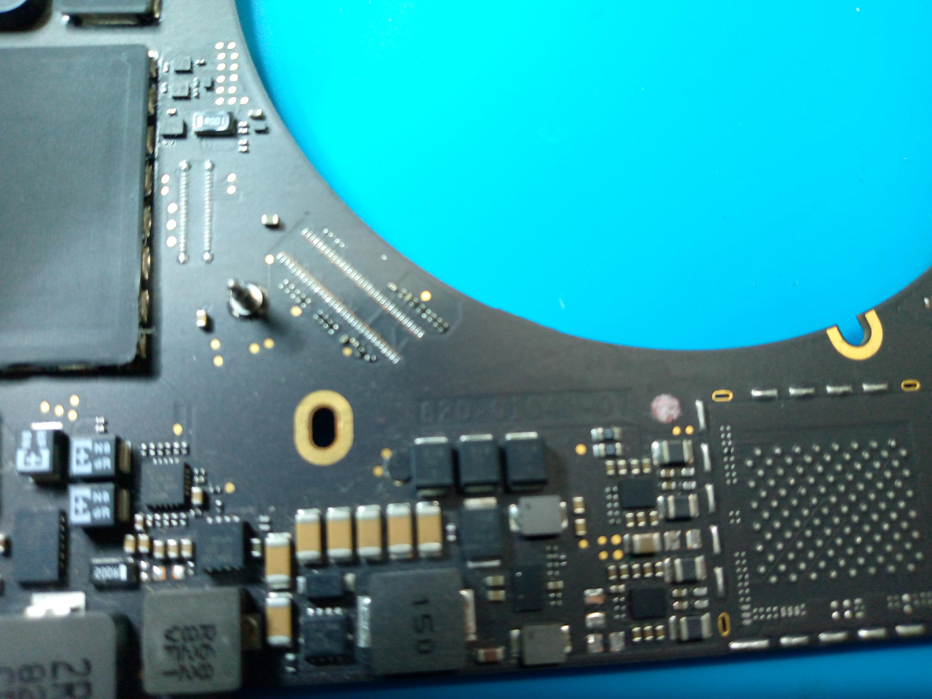

            I forgot to tell you, after I remove F7000 and F7001 I saw "light red" spots in the board, so, liquid damage areas.

              Re: 820-01814-01 Macbook Pro A1990 with short
              post picture of red dot zone.

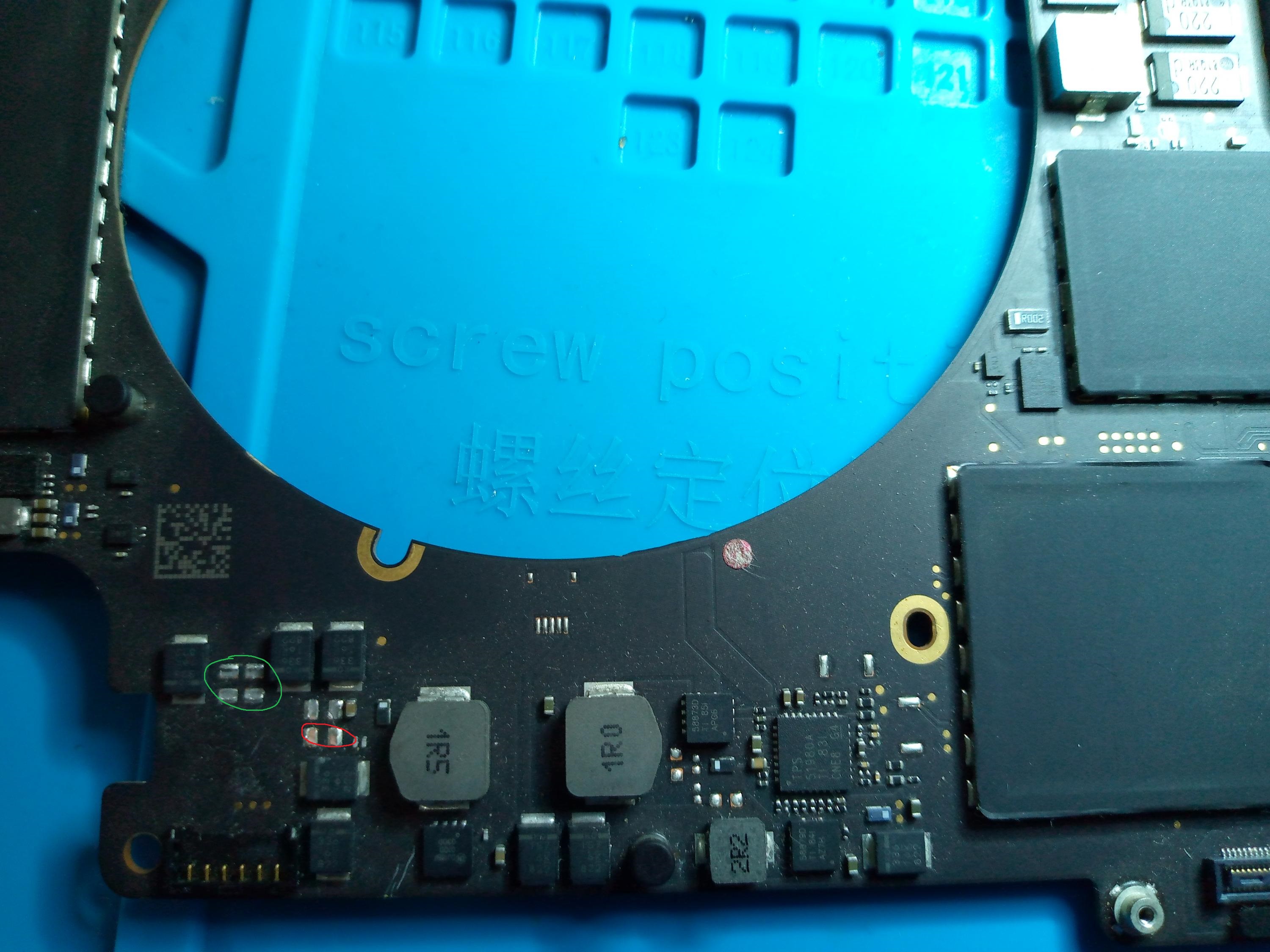

                pictures attached.
                  red spot looks like ripped of component, while green spot looks like desoldered component.
                  remove fuse f7001 f7002 and solder one wire to pin 2. use lab psu and try with 1 volt and see if something get hot.
                        yes i was meaning red and green zone in my modified pictures
                        1 red and one green for esch side of the board
