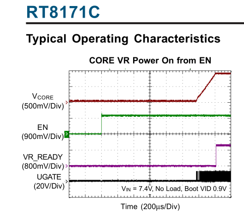

              Re: HP 15 LA-E811P no video
              I have been checking PG of the IC's.
              Cpu core IC is RT8171c (3L=) and its PG (VR_READY) has 1.05v only, there is another RT8171C ( I guess for GFX) and it has 3.3v in PG.
              Coould it be bad?

                • ruletero
                  • Nov 2018
                  • 183
                  • Mexico
                  Each IC (3L) works perfectly, it has 1.03v in its coil. The only difference is the PG signal: the first one (uses 2 mosfets, vcore) has 1.05v, the other (uses 1 IC with two mosfets) has 3.3v.
                  I replaced the IC with the lower PG, same result, not changes. Checking the datasheet, I see that the PG value is correct, I attach the graphic.
                  Please help how to continue.
