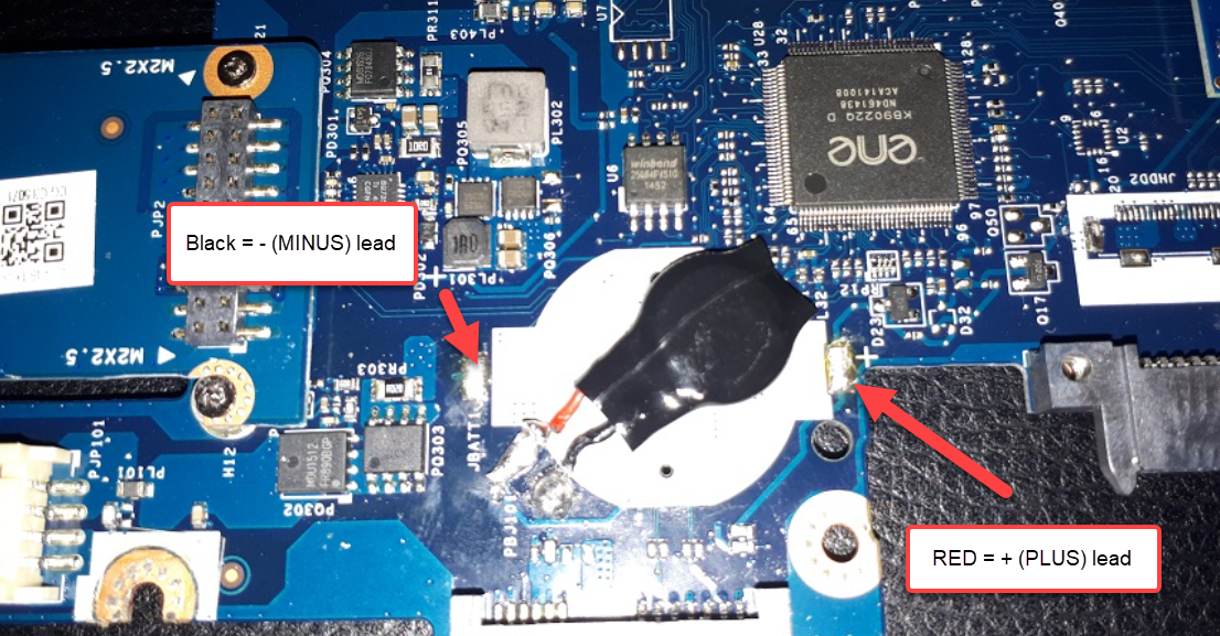

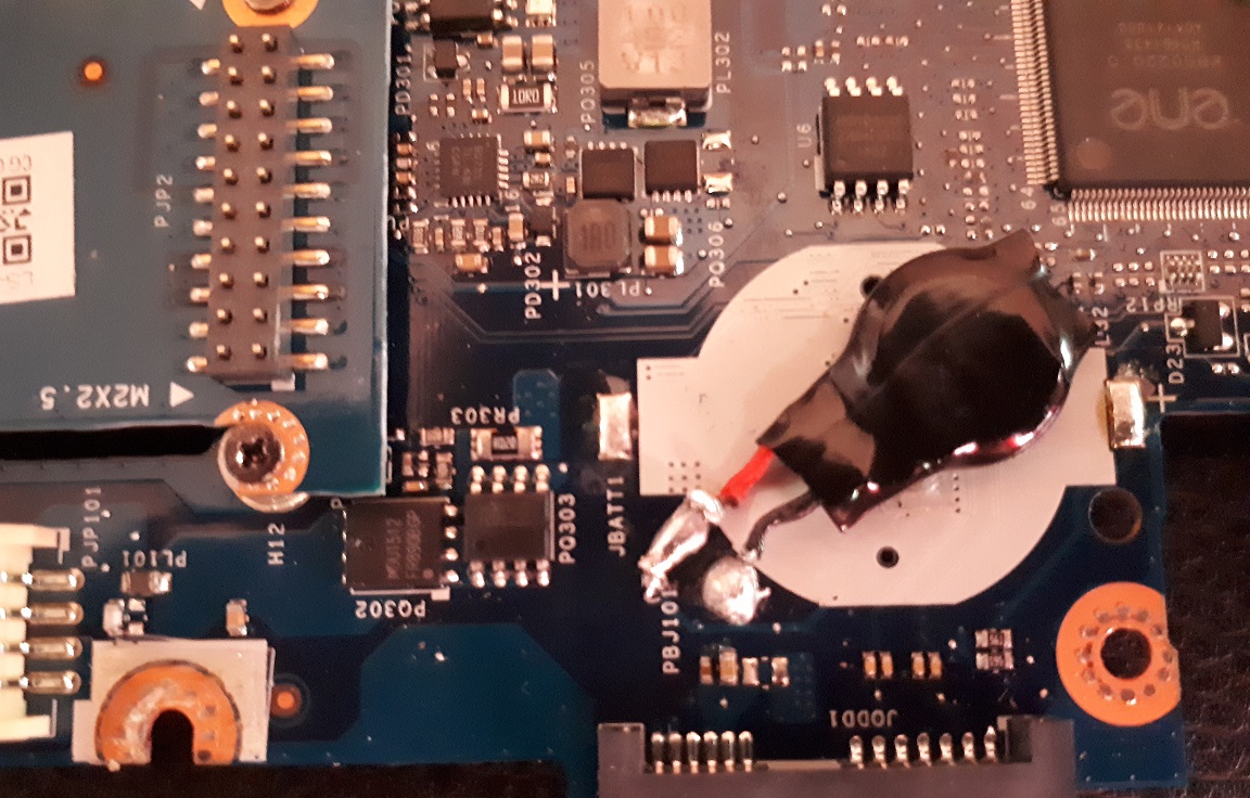

    I have an Acer E15 (E5-571) that is loosing all settings whenever unplugged. I got a replacement battery however the original battery broke off from the motherboard and the positive lead broke away completely. I tried scrapping the board and soldering the new battery to it however it still looses all settings when unplugged. Is there an alternate point on the board where I can solder the positive lead of the battery? I found schematics of the board on the forums however I have no clue how to read it.
    Thanks.

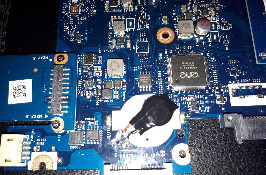

      Re: Acer E5-571 RTC battery - alternate solder point
      Thanks for the quick response. I've uploaded two pictures of the motherboard battery area (ignore my bad solder work), I hope one of them will provide you with what you asked for.
      Thank you.

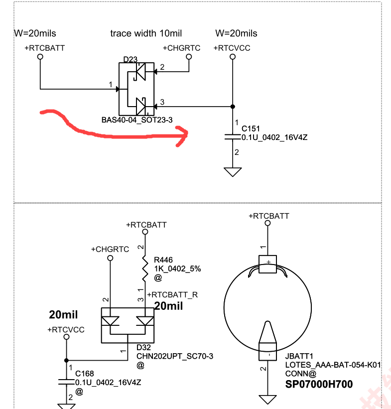

        Hi. Yes the pics help. The large white base is the original coin cell battery that is used to retain your real-time clock (RTC). Ideally, you should search out the CR2032 (?) or whatever the computer manual recommends for this coin cell battery holder.
        Coin cells do vary in diameter; the thickness and mAH (milliamps per hour) rating. The coin cell battery is NOT rechargeable but often last a few years if a good brand and original.
        You have the soldered on battery pack which should be fine but be 100% sure that it is the same voltage as the original +3v0 value or close to this. Otherwise, can cause damage.
        Aside from the above blabbing, see the attached.
        Solder as noted and see if that works for you.

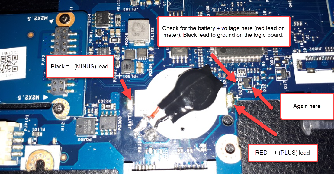

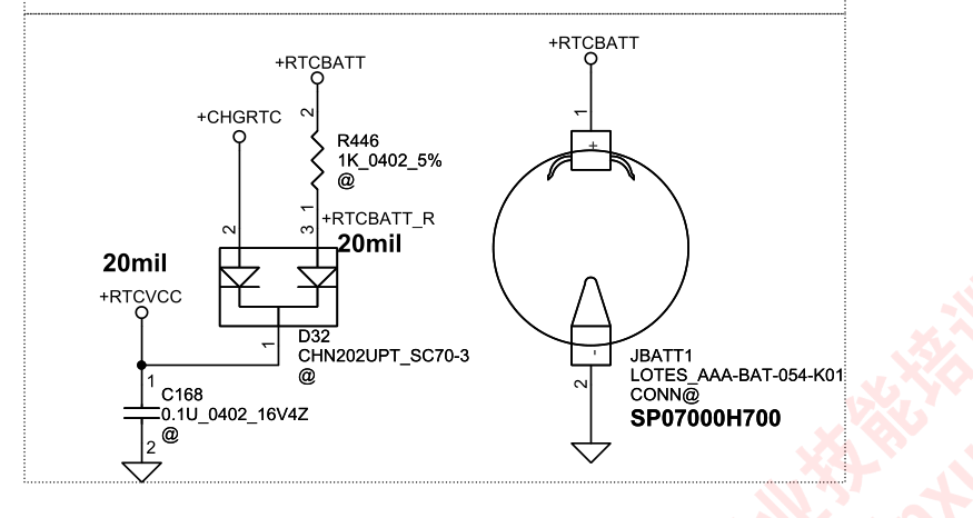

            Ok - check the voltages:
            1) on your external battery. What is the voltage from this external battery pack? Meter in volts mode. Red lead to red on the battery; black lead to black on the pack.
            Value in volts ?
            2) Then place the meter in ohms mode. Remove all power.
            Check the continuity from the + battery connector to the pin # 1 of the 3 legged dual diode (SOT-23 package).
            You should see the voltage from the battery reach pin # 1.
            The voltage should flow in the direction shown in the red hand drawing
            Then the diode inside D23 should allow for the voltage to travel to pin # 3.
            Confirm these details. If D23 is working, the voltages should reach pin # 3 which then powers your RTC IC.
              Thanks,
              Here are the results,
              1- got a 2.07 reading with battery detached from the board.
              2- when battery connected, there is no continuity to D23 at least not from the battery lead but from the plus side of the 2032 battery image.
              Don't understand, the original battery was soldered exactly where the new one is soldered but I get no reading once attached to the board. Should I solder the battery to the plus and minus (2032 battery image) as you suggested even though it is not the original location not sure if it would damage the board once plugged in??
                      The original battery is very small,as seen in the motherboard pics posted (badly solder battery). There is nothing on the other side of the board that would lead me to believe it fits a 2032 battery... I can rig up a 2032 battery to fit but not sure what issues might arise from installing a battery that doesn't, like the original, charge.
                      Thanks.

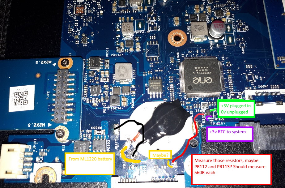

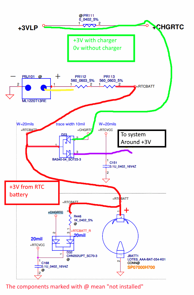

                            Hi, to me, the board looks like it was designed to accept either a rechargeable ML1220 battery, or a standard, non rechargeable CR2032, depending of the components fitted to the board
                            From the looks of it, D32 and R446 are not fitted (for using a regular CR2032), instead you have D23 installed on your board
                            Brief explanation of the circuit:
                            - From +3VLP goes to PR111 (may be fitted with a jumper trace instead), and it becomes +CHGRTC (RTC voltage with charger plugged in)
                            -+CHGRTC goes from pin 2 to pin 1 of D23 (+RTCBATT), then it goes 2 ways:
                            -+RTCBATT goes to PR113 and PR112 (2x 560R in series) to charge the ML1220 battery (PBJ101)
                            -+RTCBATT goes from pin 1 to pin 3 of D23, then it becomes +RTCVCC (to system)
                            At pin 2 of D23, with charger connected you should get +3V, charger unplugged 0v (green line on the attached pictures)
                            Pin 1 of D23 (red line), you should get voltage from the RTC battery
                            Pin 3 of D23 (purple), you should get voltage from the RTC battery (minus diode drop), with charger unplugged
                            Also check continuity from the - terminal of the battery to GND (marked with black line), you can use the screw hole as GND for measurement
                            Don't connect the ML1220 battery directly to the + of the CR2032 pads, instead it should go to PR112 (yellow line on the pictures)
                            The trace marked with "Maybe?" in yellow near those 2 resistors on the attached pictures, is where i think the + of the battery should go, please measure voltage there with charged plugged in, and RTC battery not installed (should give around 3v minus the diode voltage drop)
                            Also, you can scratch a bit of the solder mask on the trace marked in yellow near the battery, and measure continuity from there to PR112 (the other part I marked with yellow, near 2 resistors), if i'm right should measure 0 ohm
                            The circuit may be modified to use a regular CR2032 battery, by removing D23, and installing D32 and R446 instead, I also marked the possible location of R446 on the pictures
                            Hope I explained well

                            Not a good idea, may damage the battery by overcharging it
                            From there it should go to PR113 and PR112 (2x560R), as explained before
                                I followed m1ch43lzm suggestions and ended up soldering the battery as shown, and the settings are now being saved. Using what m1ch43lzm suggested I couldn't understand why I was getting a voltage at the yellow line close to the resistors but not where I had originally soldered the + end of the battery so I scrapped a little more and got a voltage. Not sure if there was a break along the line somewhere but now with the battery soldered, I get a voltage (about 2.67v) to D23.
                                DanielDacko, your solution is interesting but I am curious about something, when the board is powered from the adapter, i get a 3v reading to the + side of the space; would that damage a 2032 battery?
