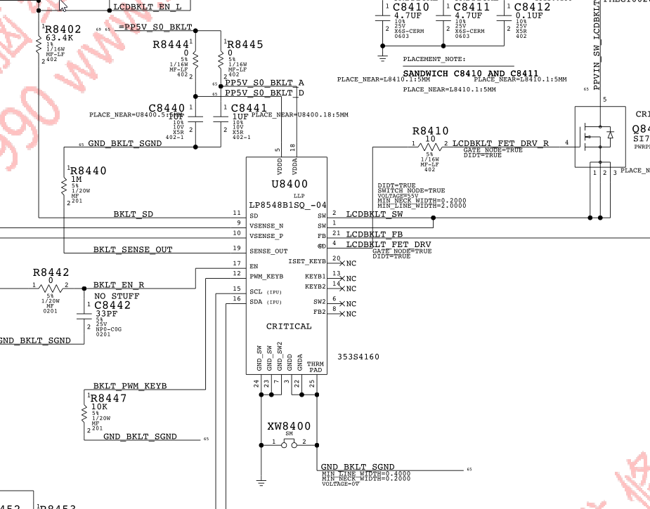

                  Re: Apple macbookpro 13" A1708 2017
                  If you CAN see the LCD display (on the macbook) with a flashlight / phone, etc. light then your backlight is defective.
                  This is a boost regulator that takes in a low voltage and multiplies the voltage (boost) to 25-45 volts for the LEDs that are behind the LCD display. Once this voltage rail is working, you can see the display.
                  The question now is if the backlight voltage is defective or working ok at the logic board level but due to flexgate (ie. broken cables to the display assembly) not reaching the led matrix of the display assembly.
                  Can you post the 820-xxxx logic board number for your macbook pro ?
                  If not known, will try to locate it another way. Once we have the details, using the boardview file viewer, we can locate the backlight voltage rail for your inspection.
                  You will need a multimeter in voltage mode setting.
                  Would you have this tool ? If not, you should be able to at least arm yourself with enough info to take it to a local repair shop. Often Apple likes to use the TI LP8550 LED driver IC which is around $3 USD each + labor to install the part.
                  https://www.ti.com/product/LP8550?ke...rch-everything
                  Let me check some schematics to confirm...

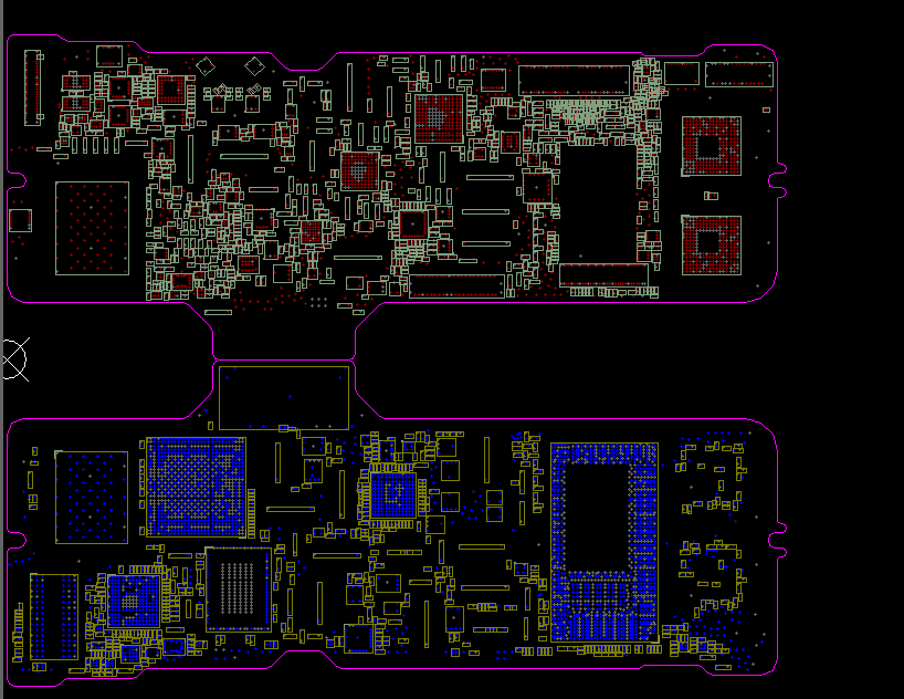

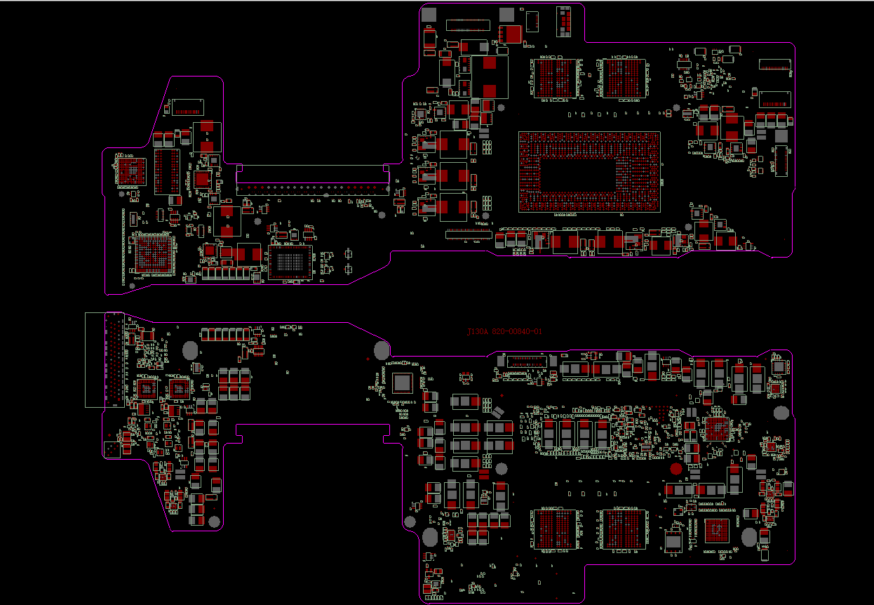

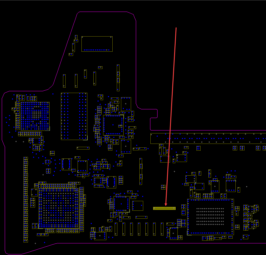

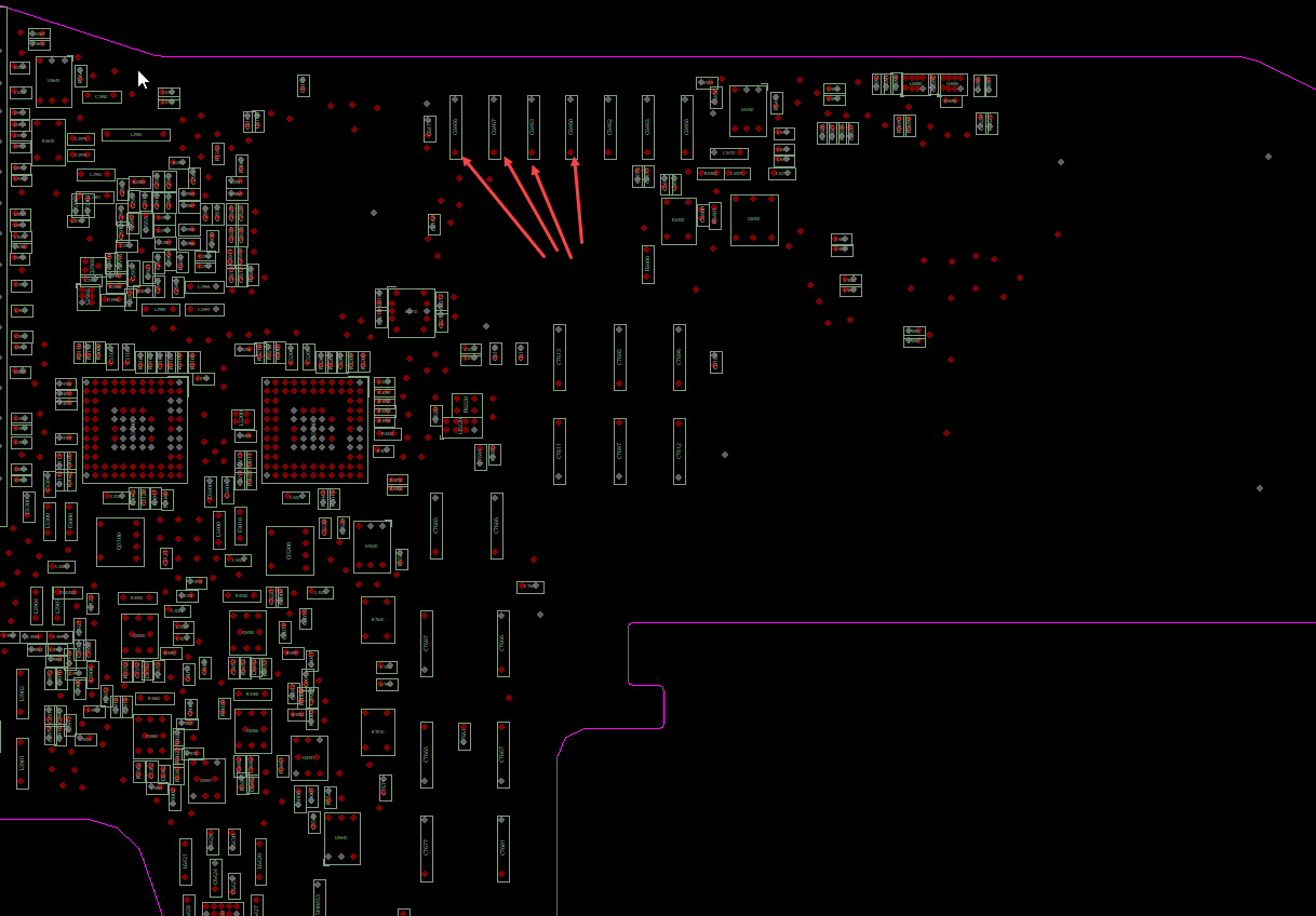

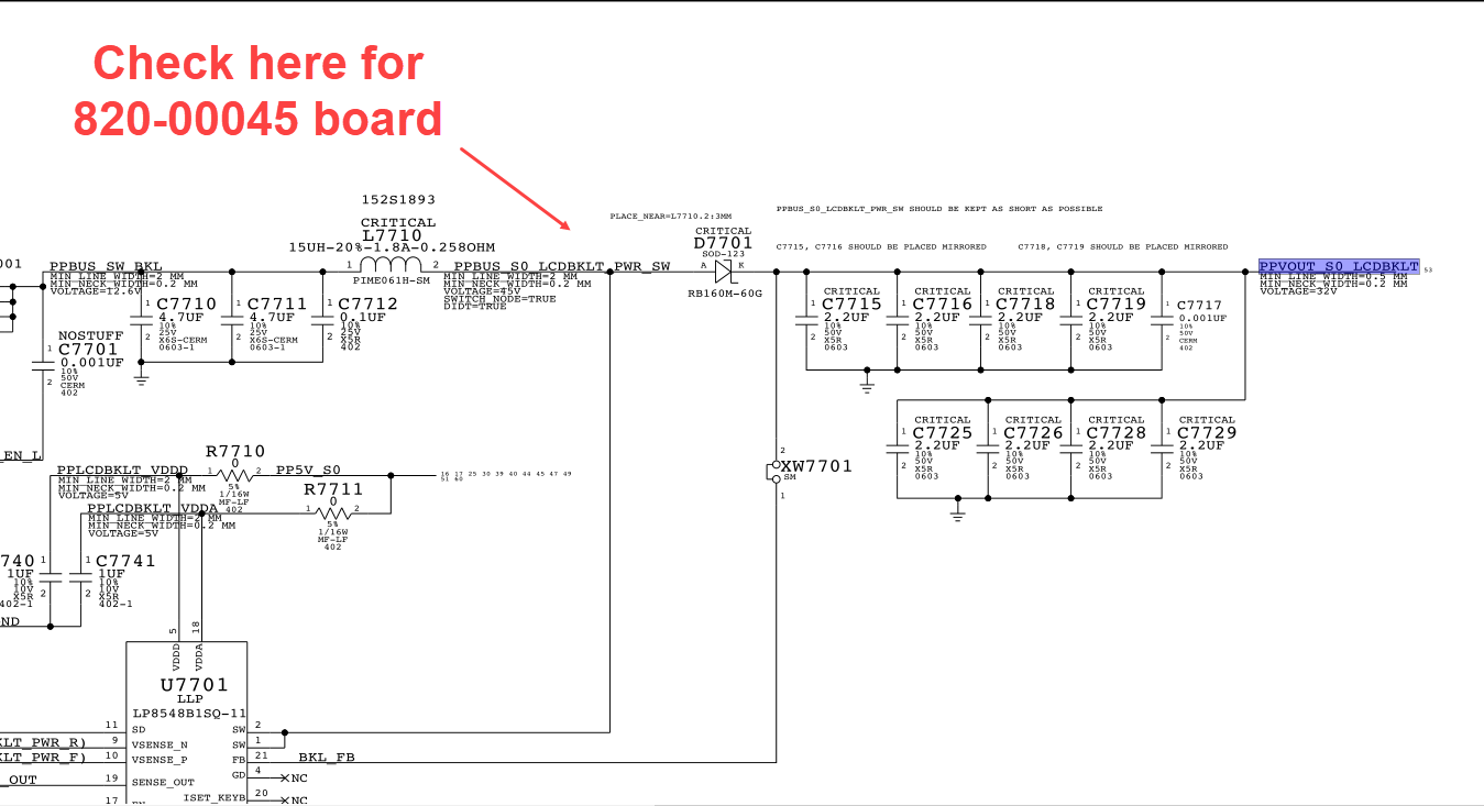

                  Ok, it is a different part from TI - see attached for the 2 logic boards used by Apple for the A1708.
                  Have a look at the PCB shape - which shape is your logic board ?
                    Ok I have a multimeter available and the main board is 820-00840-01

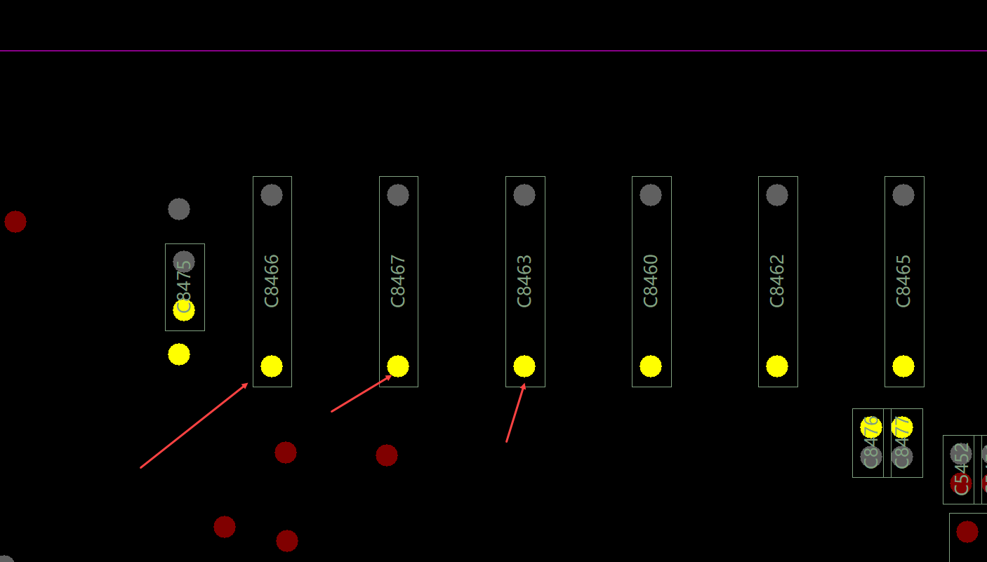

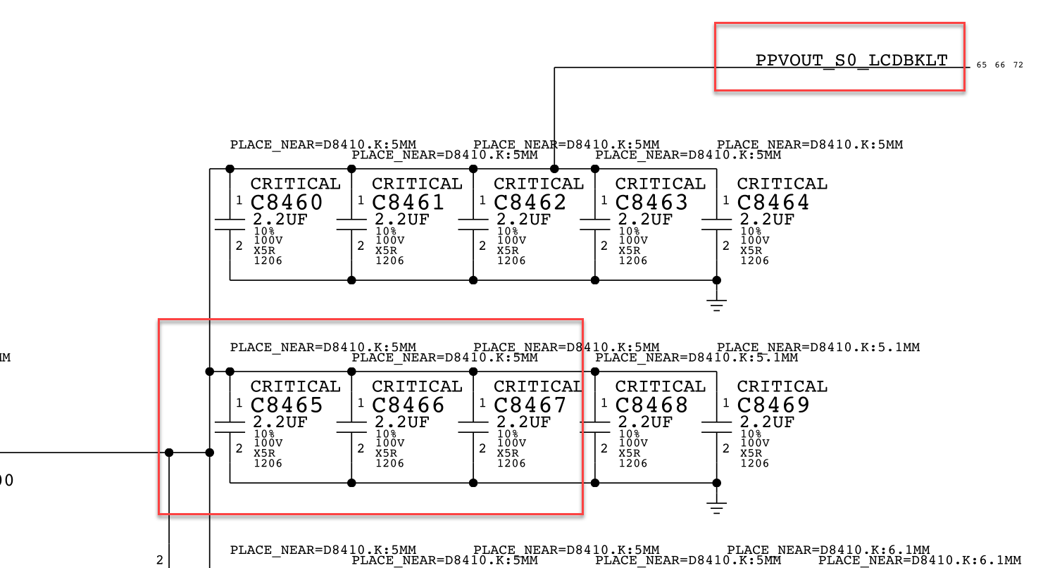

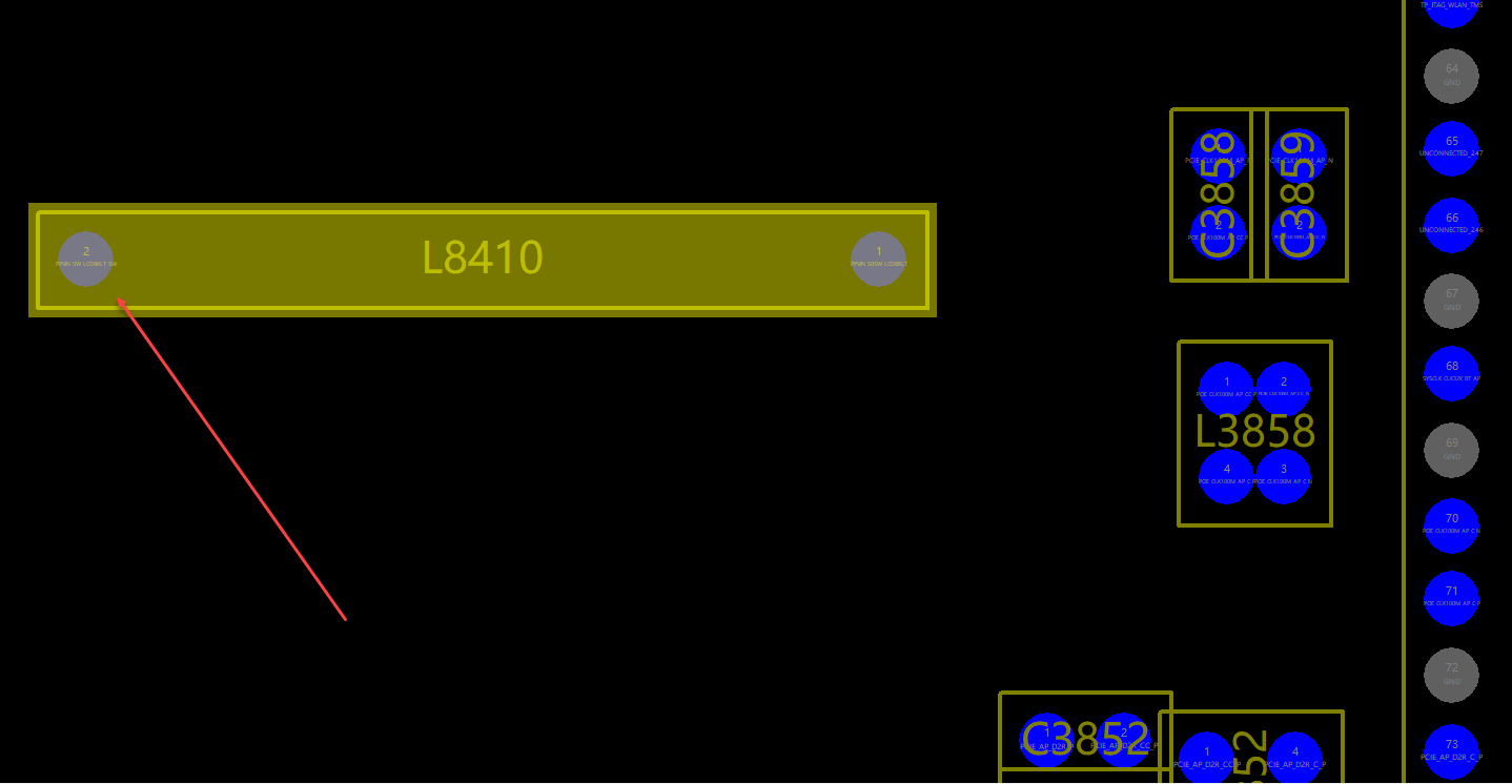

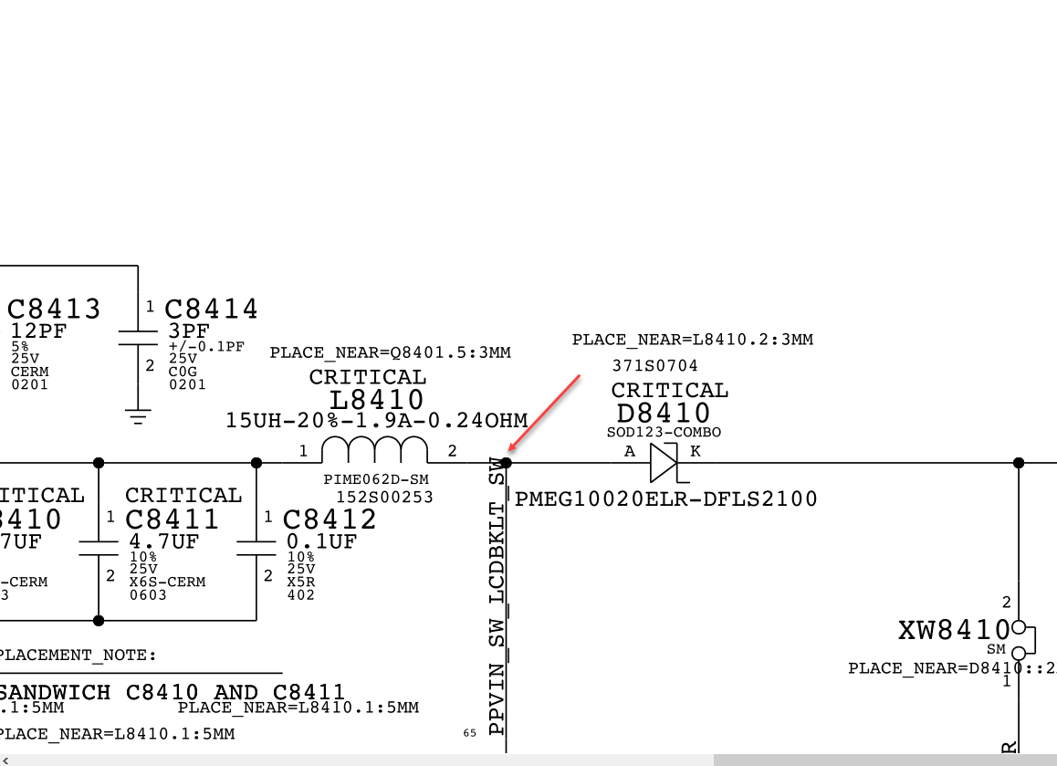

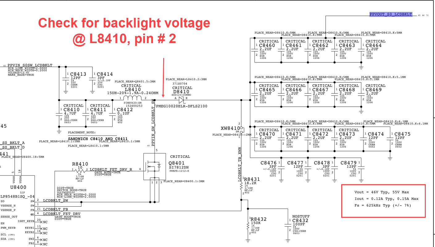

                      Check and review the voltage @ L8410, pin # 2.
                      Be very careful on the powering of the logic board and keep away from all metal objects during this review. Must not short circuit out to anything else on your work table.
                      This inductor (coil @ L8410 may be on the bottom side of your logic board).
                      With your meter in volts mode, black meter probe to ground -> red meter probe to pin # 2 of L8410.
                      Post your readings.
                      Update - you can probe the backlight voltage on the TOPSIDE
                      See revised last pix.
                        There are 11.68V
                        • mon2
                          • Dec 2019
                          • 14666
                          There are 11.68V
                          The backlight is not working. This rail should be much higher in voltage.

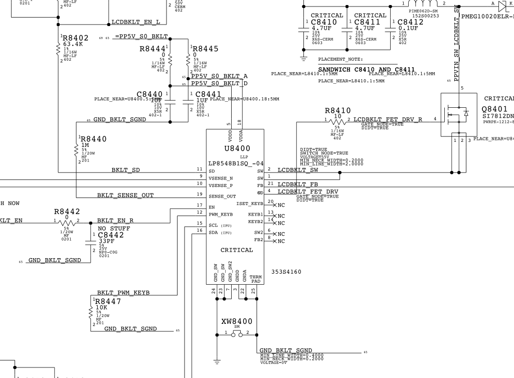

                              @ktmmotocross, I think OP is saying the backlight voltage on the logic board is @ 11.68V for the LED driver.
                              Does the LED driver require the LCD display mated to generate this backlight voltage ?
                              Unless I am mistaken (could be), the logic board should generate the backlight at a much higher voltage even with the LCD not connected. It is just a boost power supply but not sure if this boost power supply is enabled over I2C / SMBUS interface ONLY after the LCD is detected.
                              I think if U8400 (Pin 17 = EN) is HIGH, then the LCD backlight should be much higher in value.
                              • piernov
                                • Jan 2016
                                • 4439
                                • France
                                Backlight won't be enabled with no LCD connected.
