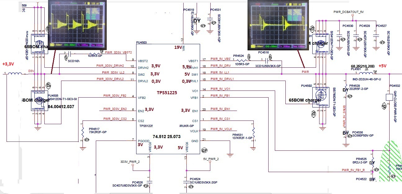

          Re: Latitude E7250 3.3v/5v IC overheating
          examine the similar scheme. first, 12 pin e 19v should come. 3 and 5 pins should be 3v and 5v. 6 and 20 pins when the enable signal comes out of the coils voltages. Make a short circuit cotrol on pins 3 and 13.
            remove pr103 and pd3 to better locate short
