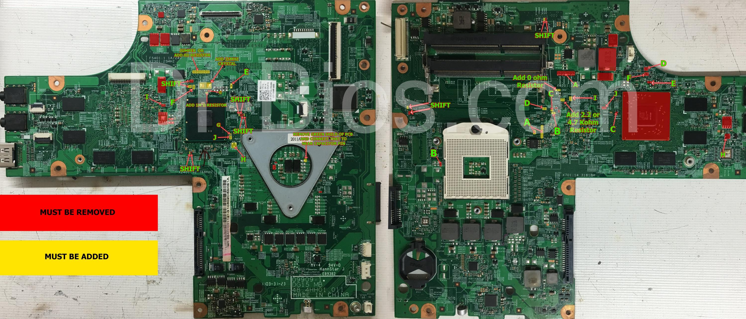

    hello friends,
    after converting board to uma i have ablank screen,
    backlight on and caps lock working but no data on screen.
    no signals on RN5505 & RN5509
    what i missed?

    Re: Dell 5010 dis to uma blank screen
    which version did you apply.

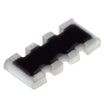

      I had to convert to uma this model too. I advice you firstly step by step check did you soldered everything corectly. Also very important, check 4x0 resistors. When I was soldering them, sometimes they was damaged (instead 0ohms became mega omhms), also check don't they contact to each other.
        Thanks guys for reply
        I applied same version you sent. Also i checked soldered
        everything. I don't know what's wrong.
          I used this tutorial and worked well.
            Thanks bro. But i already used this tutorial as it's.
            Unfortunately same problem .
