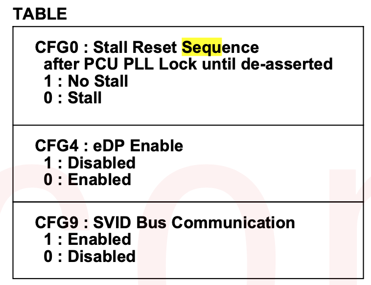

        Re: X1 Carbon beeps "0001: Reset error (platform reset not de-asserted)"
        In the schematics, page 21 - there is a table related to CFG0 Stall Reset Sequence - could this be related to the issue? See attachment - any advise is appreciated and help others.
