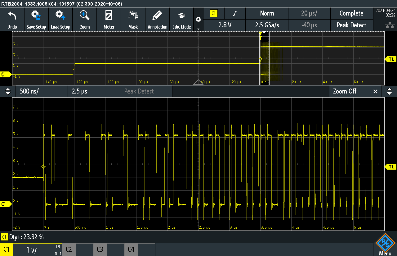

    I have a Lenovo X1 Carbon (5th gen, 20HR, YD1KL-3, NM-B141) which beeps when power is applied. The beep code decodes to:
    0001: Reset error (platform reset not de-asserted)
    This is a correct assessment by the embedded controller: the NCP81218 (U137) DC/DC controller never asserts VR_RDY, which is routed to the CPU package PCH_PWROK pin.
    It looks like it tries to ramp up its 1B rail, which is driven by a NCP81382 (U136).
    U137's DRVON pin is routed to U136's DISB# pin; it gets driven high and stays high while power is applied.
    U137's PWM_1B pin is routed to U136's PWM input. I have attached a scope trace of the PWM pin activity.
    However, I don't see any activity on the output inductor, which is driven by the VSW pins. The output rail stays at 0V. All input power rails for U136 seem to be present.
    The PWM pin trace matches these symptoms: after an initial mid-state voltage level (top and bottom switch open), the controller starts ramping up the duty cycle (soft start), but never reaches equilibrium and therefore drives 100% duty cycle in the end.
    The output rail resistance to ground measures 25Ohms, the other output rails measure 10.4Ohms and 8.8Ohms; it seems that they are all in an acceptable range for 1V rails. Reverse (+ on ground, - on rail) measurements are 12.5Ohms, 7.4Ohms, and 6.5Ohms.
    I have replaced U136, but the symptoms persist. Of course, during reflow, I might have overheated or damaged U136 so that the replacement failed in exactly the same failure mode; I don't know how likely this is though.
    What could I be missing? What should I try next?

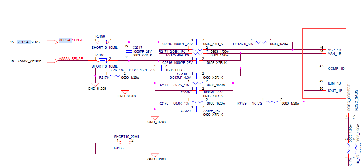

    Attached: schematic (pages 67 & 70 relevant), similar controller datasheet, gate driver/MOSFET datasheet

    5V present for sure on U136 VCC? No visually damaged/knocked off components in U136 circuit?

      5V definitely present. No damage visible on any of the components.
      I'm contemplating building a test PCB for the NCP81382 to see whether the ICs work in isolation.
      I'm tempted to lift the current sense resistor R3177 to remove the output rail load in order to see whether without any load I can observe switching activity. That seems like a remote possibility though; I should be able to see switching activity on the inductor even with the output shorted (which it isn't, at least when unpowered).
      I realized I did not attach the correct controller datasheet. Attached is a controller (NCP81246) that seems very similar to the NCP81218.

                  Current sense components for VSSA_SENSE / I limit, etc. present?
                  • bla2c

                    yes, components present, and COMP seems to ramp up fine - there is a PWM signal coming from U137 to U136 (see scope trace above).

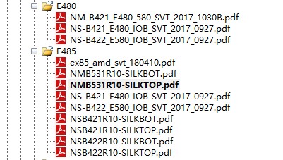

                                  Would you have any boardview resources for this? I have schematics attached.
                                  • mon2
                                    • Dec 2019
                                    • 14662
                                    Re: X1 Carbon beeps "0001: Reset error (platform reset not de-asserted)"
                                    Will silkscreens for this PCB help?
                                    May have spoken too soon. See attached and let me know if screen grabs are of interest. Do not think your exact logic board is in this list for the silk screen.
