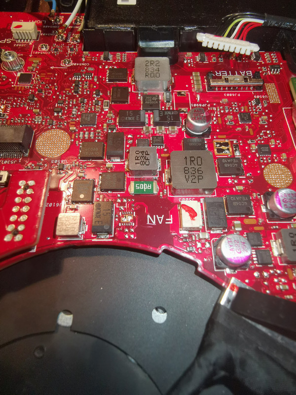

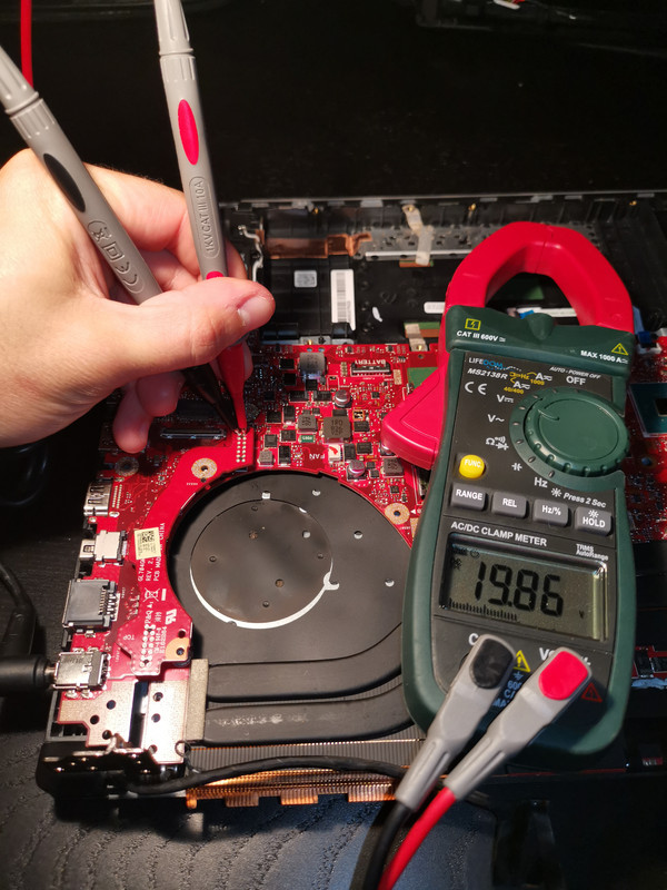

            #45
            Re: Component blow up, Asus GL704
            I have also a laptop GL704GM that stopped working, it dont turn on, I removed the battery and plugged the charger still not power. No led on with or without the battery/charger.
            I have 19V in entry but after I'm lost... If someone could help me on how to diagnose the problem?

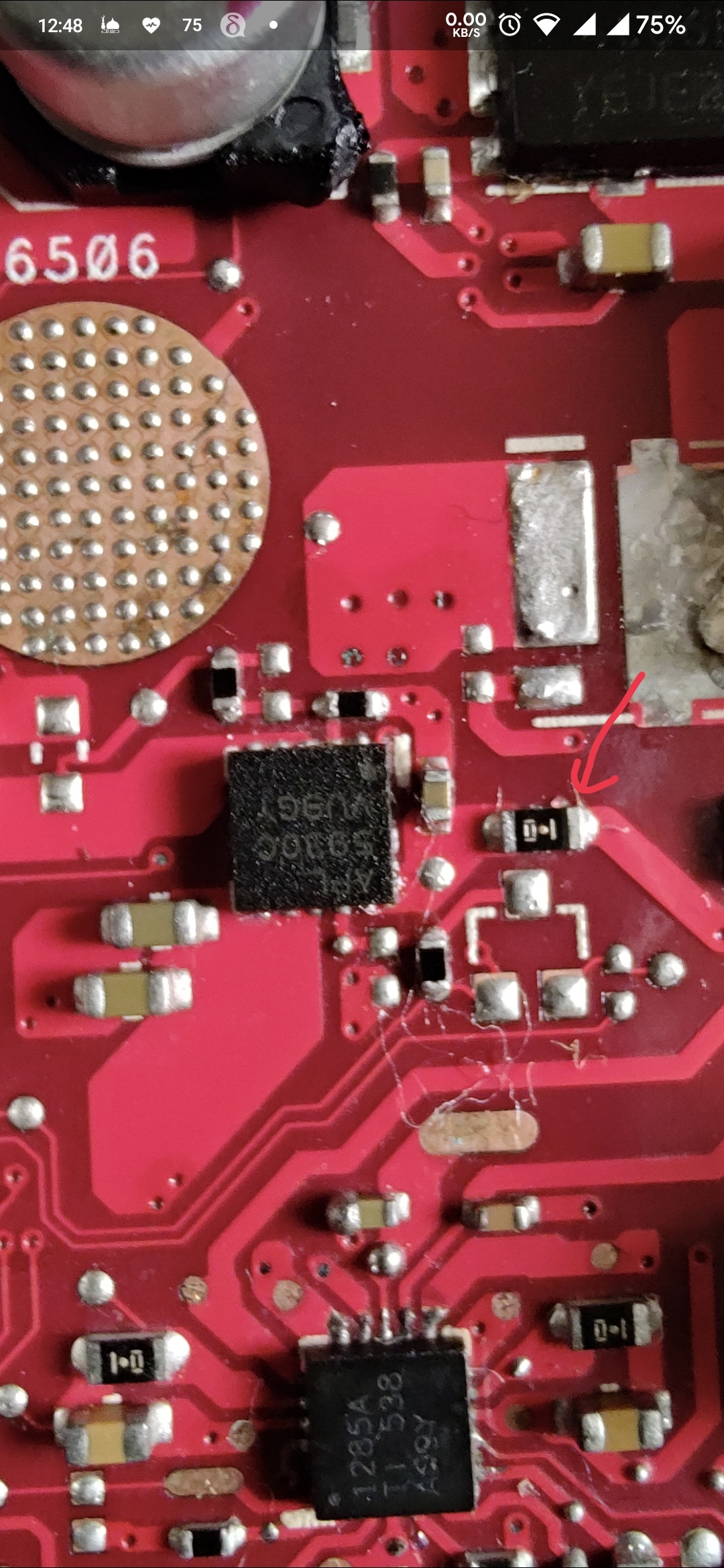

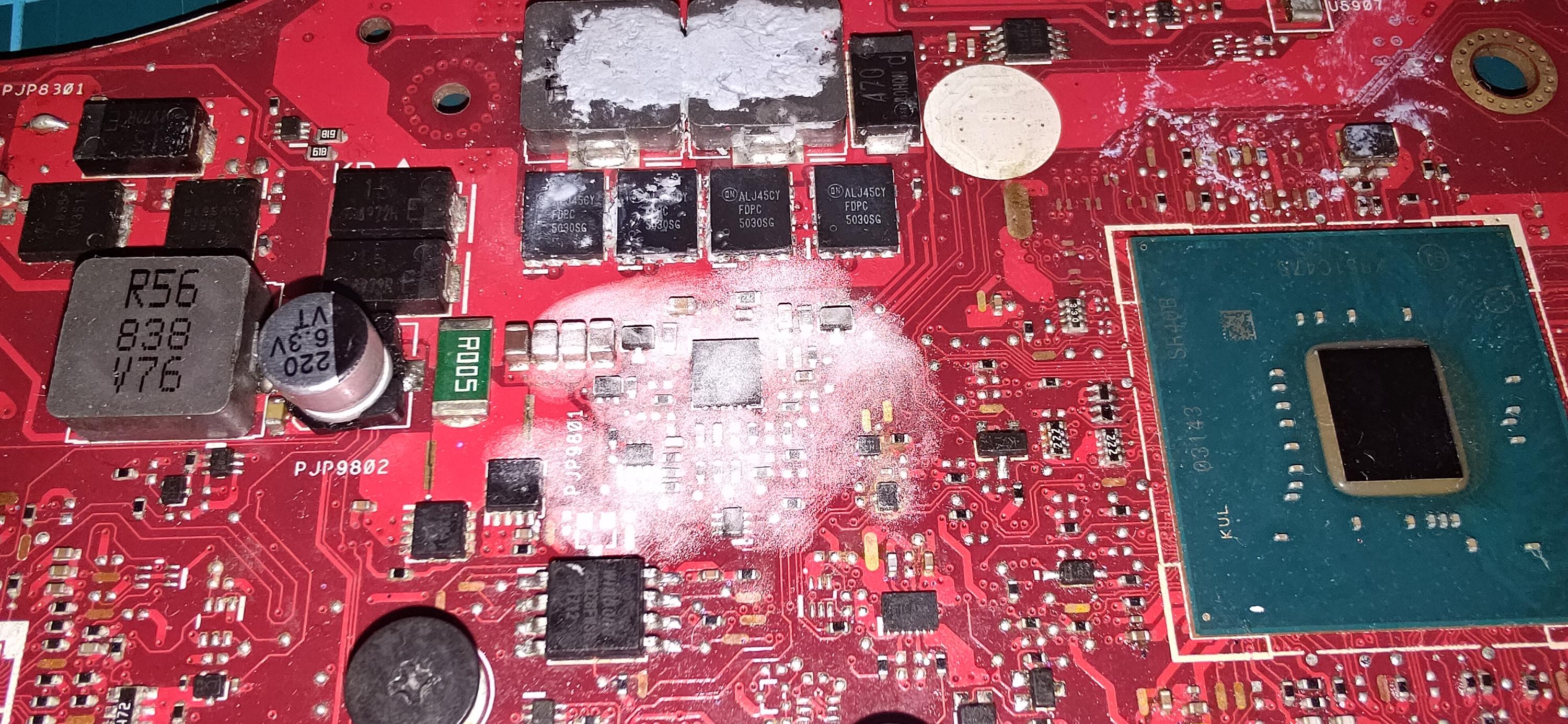

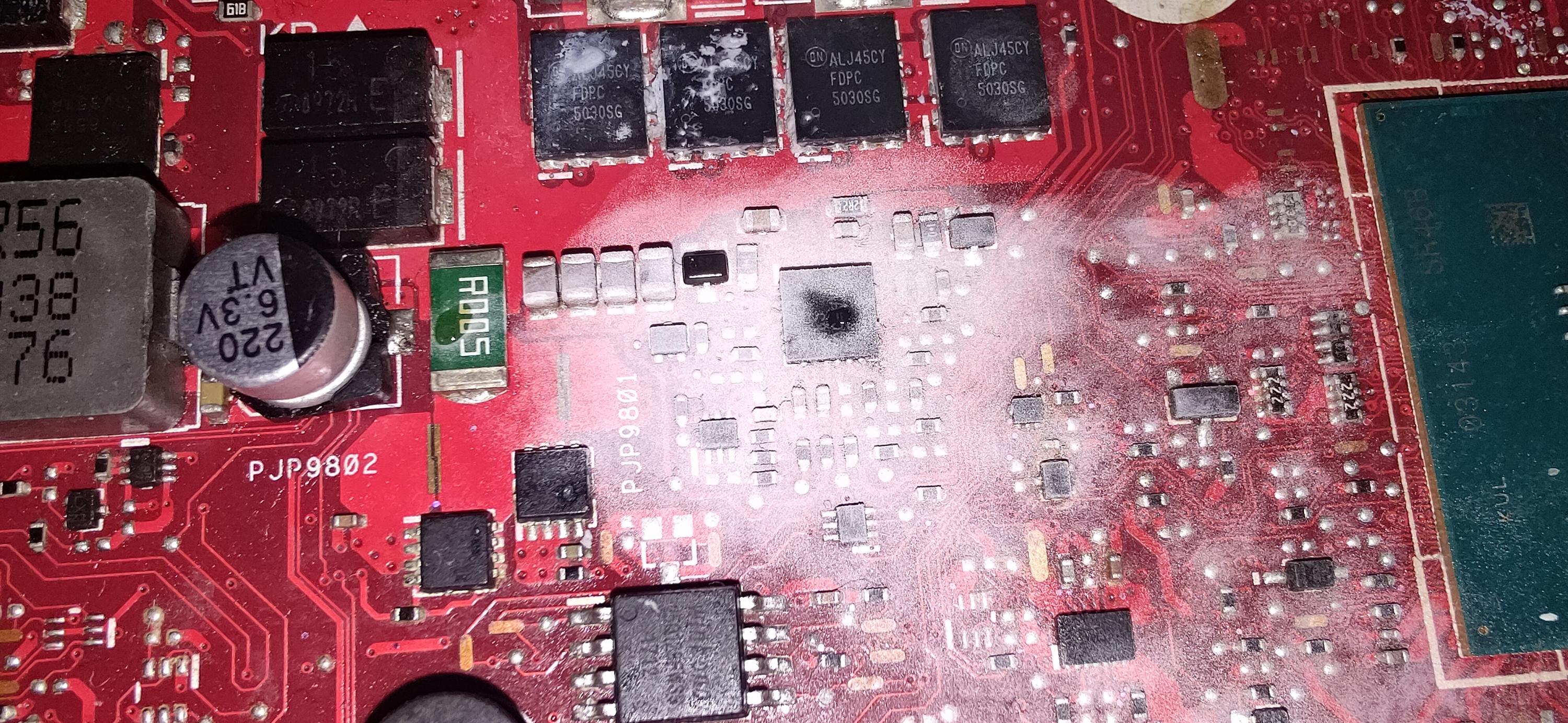

              #46
              hi again,
              so i changed that chip and i think as i was very bad on soldering it, something went bad when plugged the charger,
              now I have a short on the 5v rail, found a shorted mosfet, removing it didnt fixed the problem, still have 5v rail sorted,
              so I bought Powersupply and injected 1v and I have 0.3amps drain, but cant see anything hot,
              injected 3v the 5v rail drained 2amps I got a 1Ohm resistor going very hot
              so i removed it, still the 5v rail drain same 2amps,
              searching for what is going hot found this
              before injecting used rosin
              after injecting
              so its an RT8819a chip and a SOT-323 BAT54CW getting hot,
              found similaire config in another laptop
              as I dont trust my soldering skill, so I dont want to take any unnecessary risk on disordering those component.
              can be that SOT going bad or its the chip, or both? isnt 2amps alot for the SOT? as its rated 0.2ampers in its datasheet.
              what advise you can give me to continue the diagnostics.

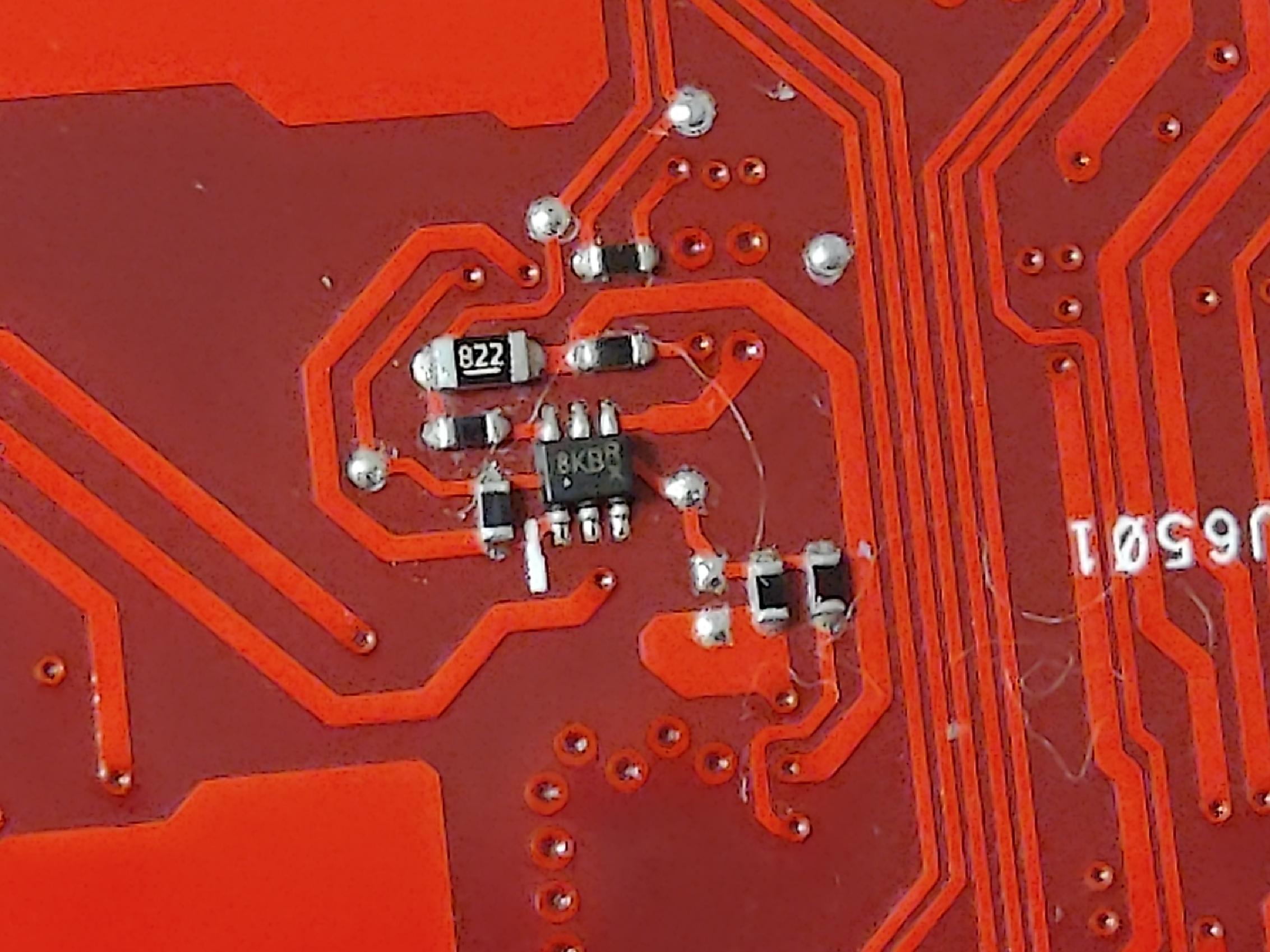

                        hi all,
                        so i Soldered the RT8819A IC now no short in 5v rail but im back to the first problem which is the TPS51258a getting very hot when 19v is present.
                        so when I inject 19v 1amps, in the 19v main rail that chip heat up, but when I inject less than 1amps (500mA) the chip is pulsing, i observe it with IR cam it, but I have a 6 pin chip with marking 8KB RX (RX is vertical) heat a little.
                        can you help me identify this chip?
                        pic attached.
                        • R_J
                          • Jun 2012
                          • 9607
                          #52
                          Pjx138k Dual Mosfet
                            thx, but after checking its not that chip, its th 822 resistor that goes hot,
                            after further inspection, desoldered the TPS51258a and injecting 19v found a Mosfet (PE616BA) pulsing which is connected to 3.3 rails, inspected it and its shorted to ground.
                            so i did inject 1v1A in that coil, the voltage drops to 0 with 1amps is drained but no heating present,
                            do i Increase the amps?
