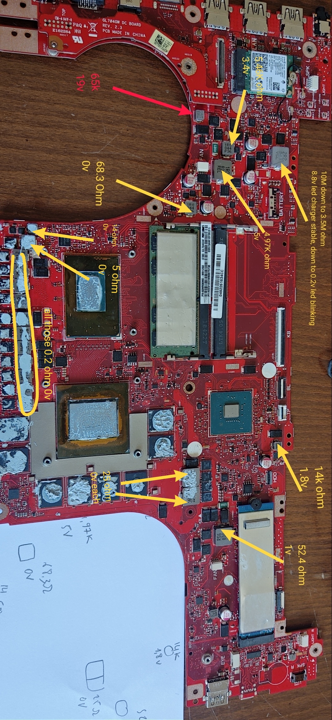

Obviously the Laptop didn't start at all. RAM, CPU and GPU voltages are Missing.
But i See another Problem with the Coils you forgot in the First Pic. I believe there is an RTX2070 soldered? In this Case we could tolerate the Low Reading at the GPU Core Coils but Not the Low Resistance to ground of the four upper coils which Points to the CPU Core (in my opinion).
How Low exactly is the Résistance Reading when you short your probes directly to each other?
This seems to be a Very expensive Board, so i'm a little Bit afraid to Help troubleshooting. Usually i would suggest to lift all four upper coils, then Check on which Side is the short. If the short is on the CPU-side inject 1V 2A and Look whether the Voltage Drops. But as i Said i am a little afraid. For me it is a clear Short at VCore but Maybe Someone Else Would confirm this is a normal Reading...
Which Type of CPU and GPU exactly are soldered there?

This laptop is 8750h 2070RTX.
My multimeter shows 00.0 ohm when probes are shorted to each other.
This board isnt under warranty anymore.
Edit: after reading your reply again and again, i did a new test and here the result:

This Looks much Better now. Good, you double-checked your measurements.
I have an Board with GTX1080 Here which still (somehow) works and reads Only 0.3 Ohms to ground, so should be fine. Resistance of CPU Core is high enough to Not suspect an issue there anymore.
So what next? You should Check whether the Voltage at the Power Button (or the corresponding Pin at the connector) has 3V present and Drops to 0V when pressed.Last edited by Sephir0th; 04-24-2021, 04:47 PM.Comment

Ps: I updated the pic with where the 19v arrive at cpu coil level.. it drops to 0 after the little mosfet
Re: Component blow up, Asus GL704
Okay, that's fine but now the really hard Part of the repair begins: The search for Missing Logic Signals. This is already hard with Schematics but even harder without...
*** Edit: forget about the EC. It's a BGA one, it seems from ITE. But you could Check whether it is getting warm or hot when powered. It's located below the SSD. You should Remove the SSD anyway permanently to exclude an issue from there.***
Share also a clear Pic of the Region where the Coil with 68.3 Ohms measured, both Sides of the Mainboard. I want to know where the RAM Controller is soldered.
Did you Ever Tried to start the Board without RAM? Or Tried with another known working RAM? And of course you are working With a known good Adapter of correct wattage?Last edited by Sephir0th; 04-25-2021, 03:16 AM.Comment

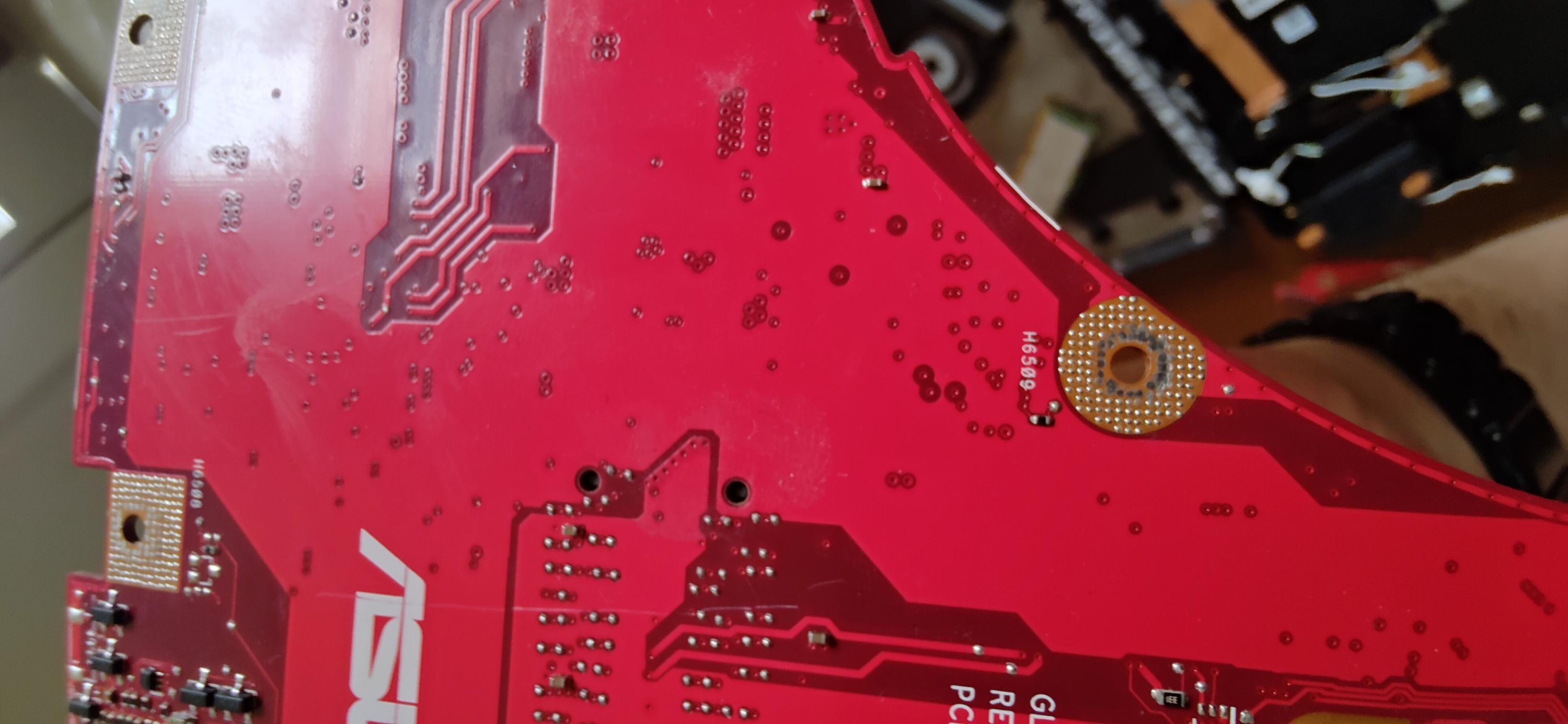

For EC ITE IT 8291E120A on the otherside:
Ram Coil region:
Otherside of motherboard ram region:
Is this the BGA ? :

No, Not this Big one i mean the Second EC directly below the SSD. It's black, much smaller, has No Pins, and should be also from ITE. Check both ECs whether they're getting warm or hot.
Meanwhile i'll Check the Datasheet of the controller you found around RAM Area.Comment
