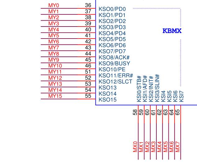

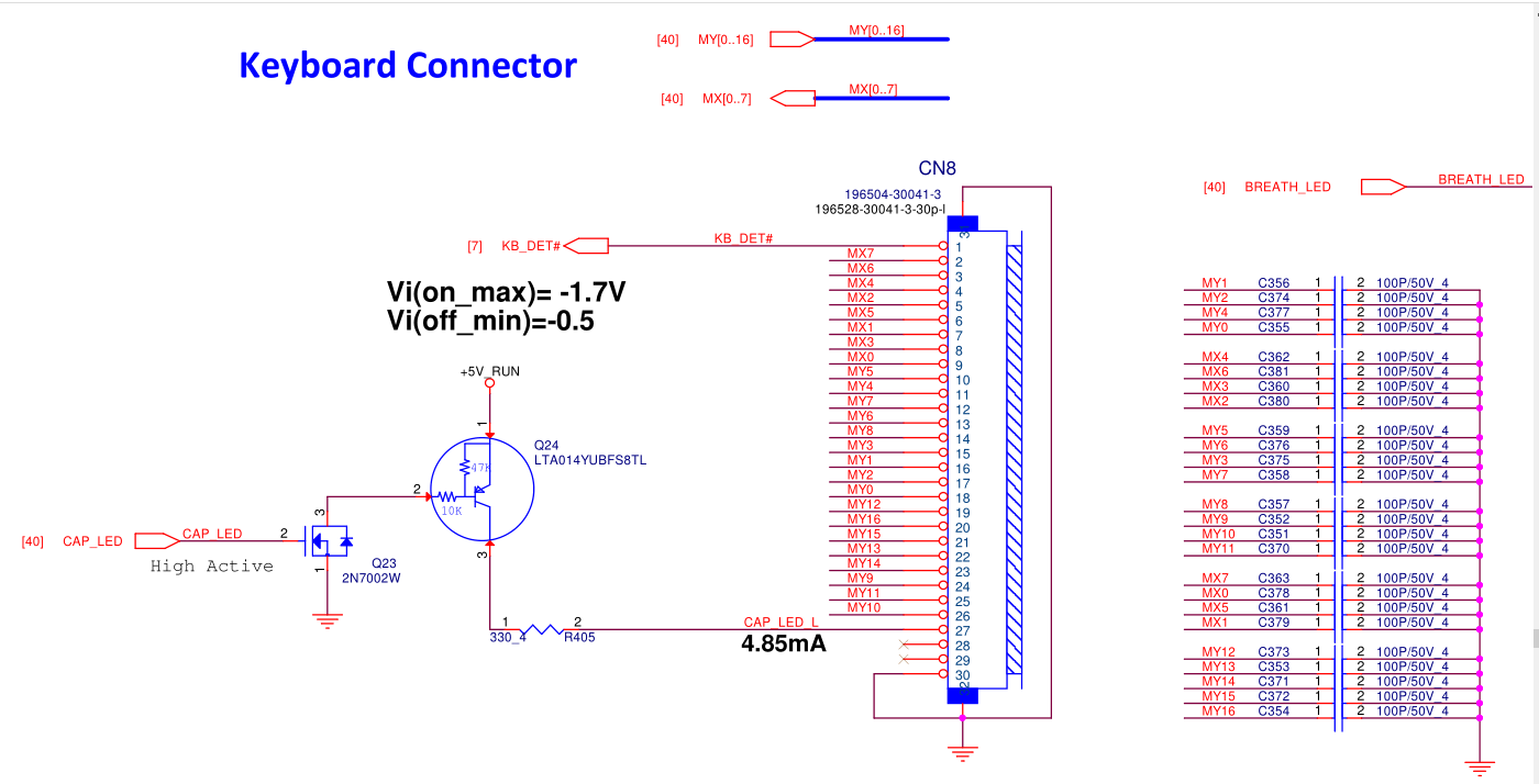

          Thank you very much for your suggestion "mcplslg123". Really appreciate!!! Is there any diagram to show which circuit lines controls what keys array on the keyboard?

            hello from Windsor. pls see attached.
            • mferna14
              • Jun 2018
              • 1019
              Re: It8528e kbc
              Hi "Mon2" you guys are really GREAT... I have this photo & I know about this matrix... but I wanted to know the arrays MY1 ~ MY8, what keys on the keyboard do they control??? Thank you very much
