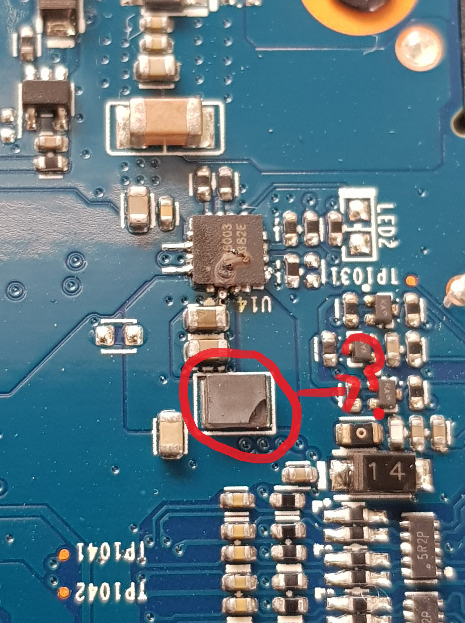

    Lenovo Ideapad 100S-11IBY

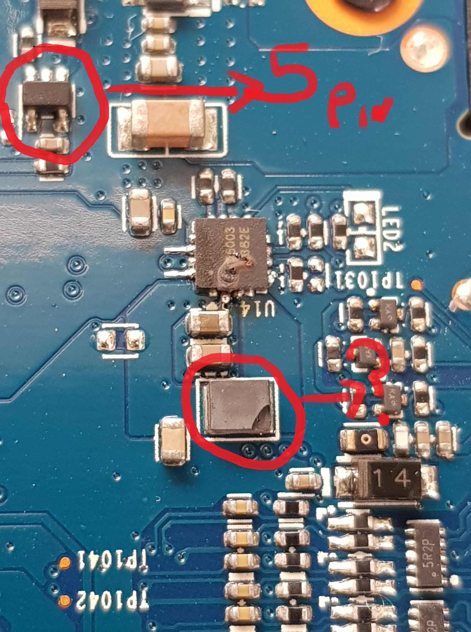

    HELLO FROM GREECE
    can anyone knows the type of this chip ?
    Thnks

    Re: Lenovo Ideapad 100S-11IBY
    The "chip" in the red circle is an inductor, if i understand your question correctly.
    The burnt controller should be this: https://cdn.badcaps-static.com/pdfs/...f41af7ba3f.pdf
      thnks for the answer ..... the type for inductor i need ,,,,
        The plastic casing of the coil is broken. but it can be solid. the chip next to it seems to be problematic.
          problem is not that inductor. problem is U14 and that 5pin ic near him
            i know the problem in U14 ... i change this....
            that 5pin you mean ?

              @ghost73
              Did you solved the problem with your lenovo 11S-11IBY?
              I have same problem (burnt IC like on your picture), did you found out the specification of the 5-pin IC?
              Probably some kind of voltage regulator?
              Im looking for the schematics for this Lenovo model, is there anyone that can post that here?
                Originally posted by repair_schematics
                @ghost73
                Thanks in advance
                Same issue! 5 pin ic not recognized. Anybody help me?
                Thanks!
