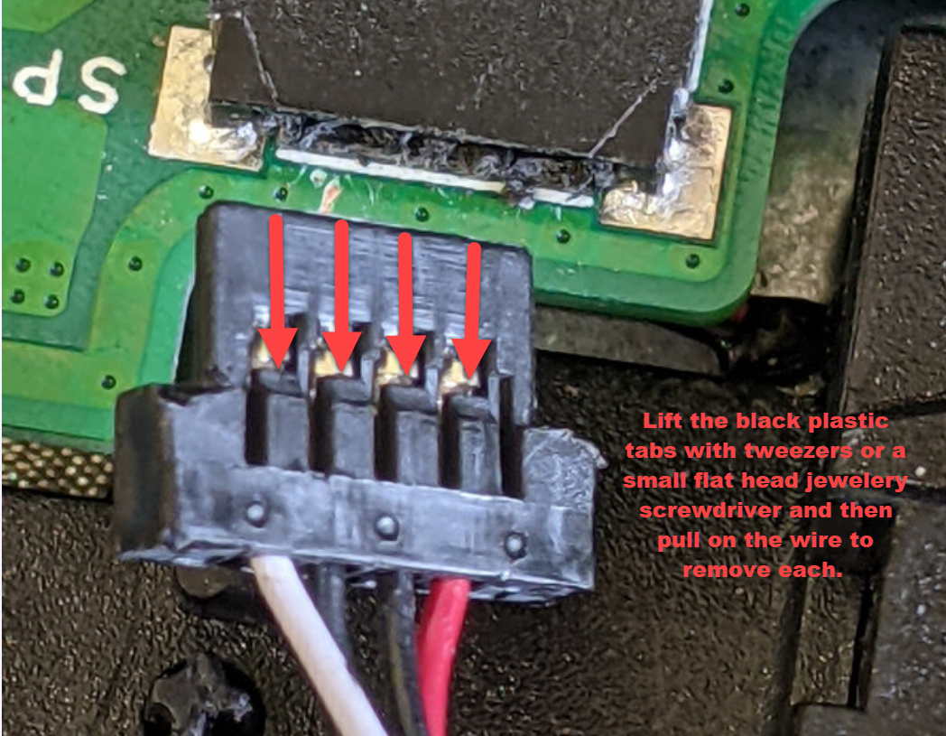

    Hi guys/girls
    I hope you can help.. I was helping a friend by replacing their speakers in the hp pavilion notebook.. pulled the plug out and its broke inside.. my question is how can I get it out?.. any handy tips please?..
    Also maybe I can get a replacement part?. Please go easy I'm fairly new to this..

        Hi. Do you have small fine tipped tweezers? They are commonly available from electronic stores. You can probably get a pair from any cellphone repair shop for cheap. Tons on AliExpress.
        Using the tweezers, try to remove the broken plastic parts inside the soldered connector on the logic board. It appears that the male and female parts may have been glued?
        A suggestion is to clean up each male pin on the logic board and then extract the speaker female pin and mate them directly without the plastic housing.
        That is, using the tweezers, lift up the black plastic tab that is holding down each speaker wire. Once you lift up the plastic tab, pull on the color coded speaker wire. The wire will then release and come out of this plastic shell.
        Try with one speaker wire and then mate this wire directly with the male connector on the logic board. Repeat for the rest. This solution will not need any soldering.
        Option 2: same but cut off the speaker wire, solder tin each and solder onto the pads on the logic board.
        Option 3: measure the pin to pin pitch if the speaker connector and share the details. From the pictures, appears to be 2mm pin pitch. You gave 4 pads ar 2mm pitch with 2 outside board locks to secure the connector. With a hot air tool, the connector could be removed but you need a replacement. Let me check around for a similar part while you try to clean up the plastic parts that are broken inside.

              See attached suggestion. Remove one of the speaker wires as noted and then attempt to insert this raw - compression fit female socket directly onto the logic board connector.
              Repeat for each such wire.
              Then you could hot glue the contraption to secure the wires.
              Pretty sure these wires / socket looks to be glued together.

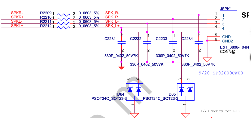

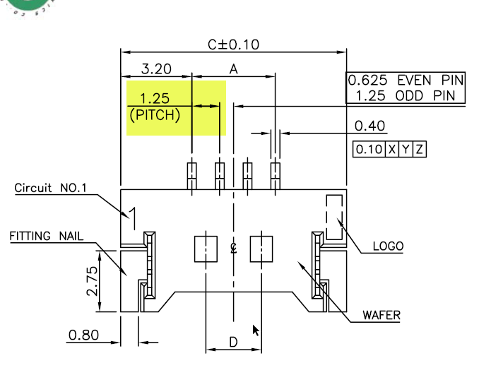

                          Having a hard time nailing down the details of your logic board but have a partial listing on our online service we have at the shop.
                          In reviewing the assorted HP Pavillion logic boards, a few of them offer p/n for the surface mount speaker connectors.
                          See attached.
                          Based on searching out two of these parts, each part appears to be a SMD WAFER connector with a 1.25 mm pin pitch. Perhaps what you have is also a 1.25 mm pin pitch SMD connector.
                          Will not hurt to ask the shop you wish to work with if they can also source this connector @ 1.25 mm pin pitch wafer connector. Mention it is for the HP laptop.
                          Molex may have this style as well.
                          Once you receive the part, place the pins - head to head so you can confirm that the pin pitch matches 100%. There is a high probability that you have a 1.25 mm component.
