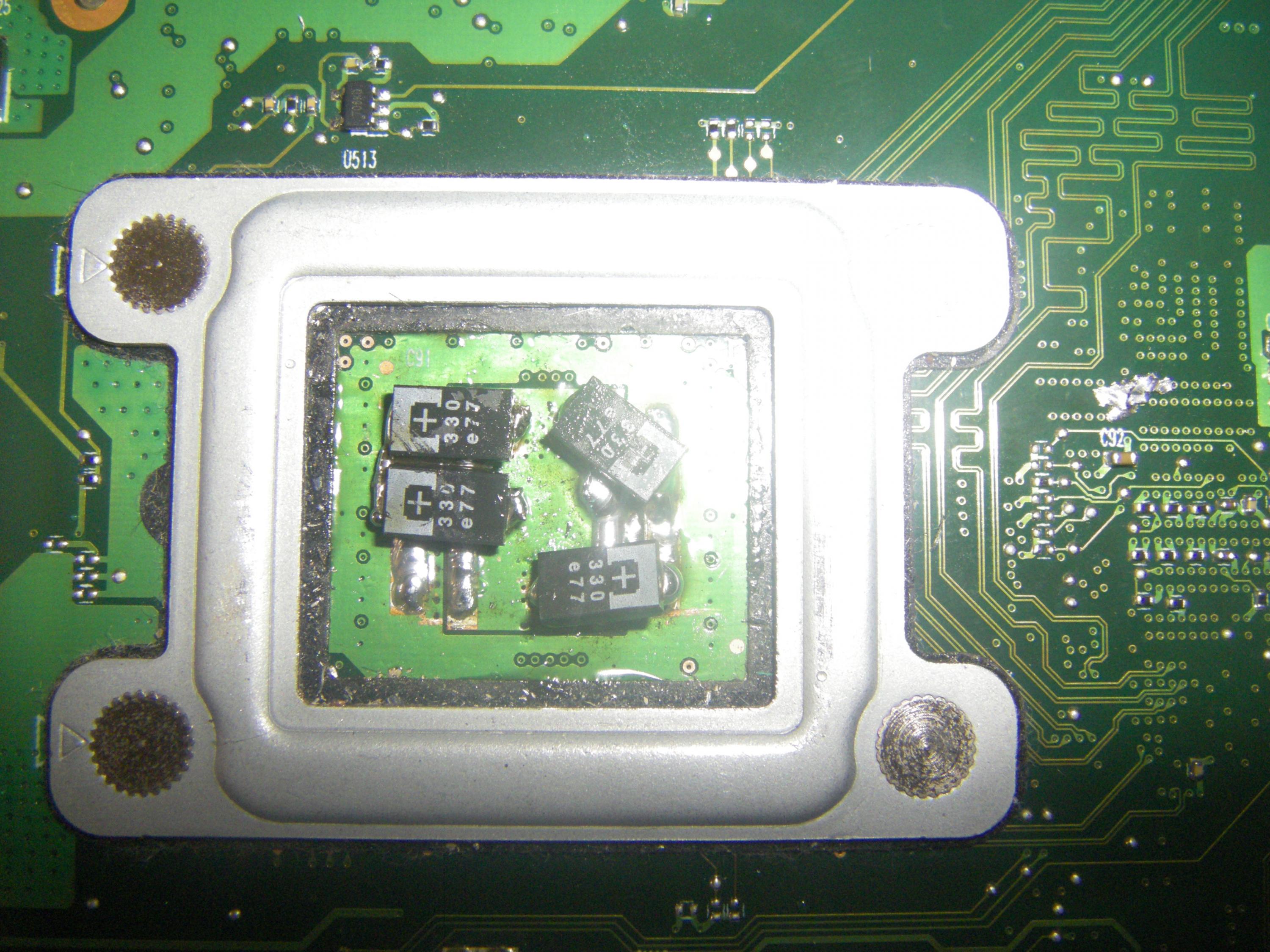

    I didn't take any pictures, but it looks just like the ones on the first page of this thread, posted by ablacon64.
    Apply a small amount of solder to the motherboard and a little bit to each of the capacitors first. Then place on one capacitor at a time and apply heat to the legs of the capacitor. It solders in place quiet easily. Don't use huge amounts of heat, because the cpu socket is on the otherside.

              gud day to all! Just found this site looking for some answers regarding my laptop its a toshiba satellite L355-s7900. It powers on then off, keeps on going like that. I took it apart and found that there's also a nec tokin 0E907 under the cpu socket.
              I did try to follow some guides here to see if its going to work. I measured the cpu voltage and found out that its fluctuating from zero to .9 voltz and it doesn't stay on that. It gives random voltage reading.
              I removed the tokin successfully and replace them with a different capacitor but it still won't give any display but the good thing is that its not turning off anymore, it stays on and the voltage stays on .9 voltz. I may have missed some steps here coz I've read that my processor needs to be on 1.070 to 1.175 voltz. .9 is low i think. Maybe I used the wrong capacitor. It says 330 e53 I don't know if its the right one, any advice will do thanks a lot!

                Did you use just one capacitor? As others stated in the thread, you should use at least 3x 330uF capacitors! 0.9v does seem low.

                  yes I used 4 caps same as the images shown. by the way I forgot to mention that one of the capacitor I placed is labeled 330 e58 instead of e53, does it have any effect on that? if the laptop stays ON using adapter does that mean I' m on the right track? tnx again for the help!

                    read Post #444 of this thread
                    a few members added more than 4caps to make it work

                            You know what guys.... You're all AWESOMELY GRATE!!! I fixed my laptop with no display just now using 6x 330uf e53 2.5v capacitor. It really did a great job after replacing that tokin.
                            To everyone...Thank you very much!
                            And also a big thanks to badcaps.net! cheers!
                            Sorry its a bit blurry, just used my old cellphone for this
