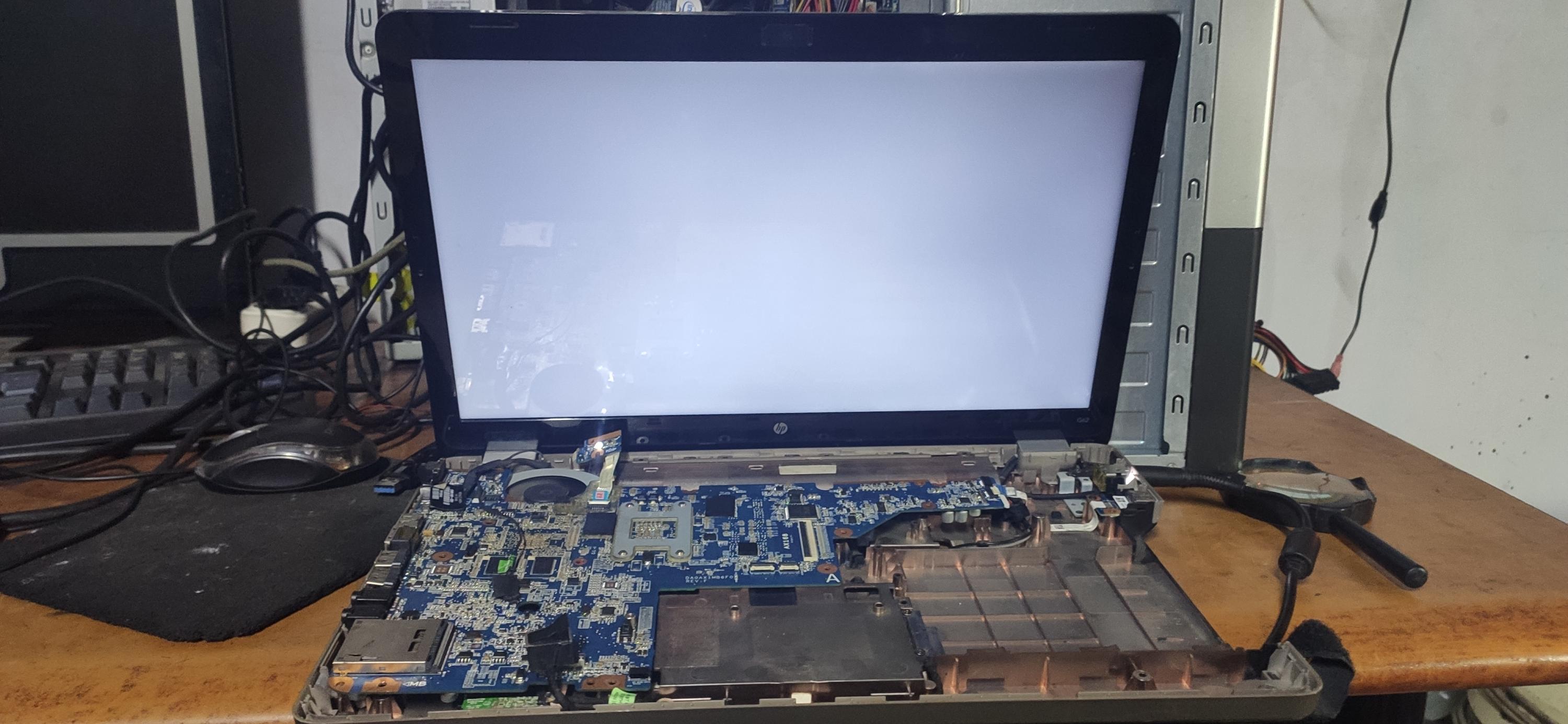

    Hp g62 daoax1mb6f0 rev f after dis to uma no data
    Hi, I tried to do uma this device with this conversion pics;
    https://www.badcaps.net/forum/attach...7&d=1503059068
    Everything made same as conversion pictures. When I powered on the laptop, there is backlight on laptop but no data on screen (no logo etc.). Just blank screen I saw. What should I do?
    this picture explains everything. I tried different model lcd panels, replace 1 mohm resistor and crystal. Every result is this;

    Re: Hp g62 daoax1mb6f0 rev f after dis to uma no data
    Hi, while looking at the motherboard, I didn't see the jumper between the capacitor field next to the power capacitor 132 and the IC next to the CPU, Personally I think that it's all, and if you fix the problem earlier, would you please clarify to me how you did it?
