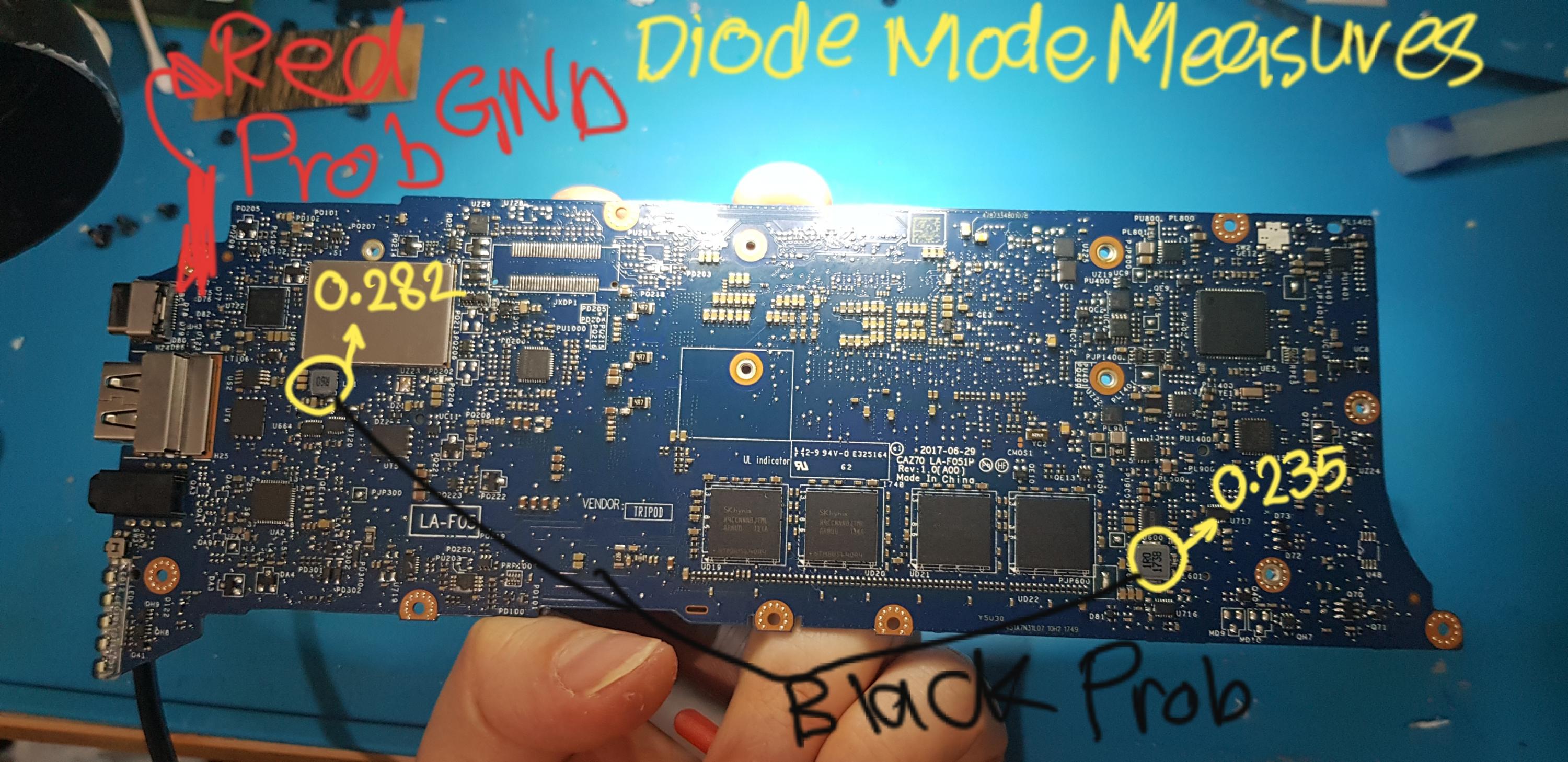

    Hi
    So i got a xps 9360 i7 8th generation . Which has LA-F051p motherboard.
    The laptop briefly blinks and immediately shuts off. All the signals including VCC SA and VCC Core comes on during this 1 second time. Apart from VCC_GT. I did the following so far
    Replacing charger IC
    Replacing CPU controller ic ISL92859A
    Replacing the VCC GT mosfet
    Replacing the VCC SA mosfet + its driver.
    Replacing TPM IC
    And of course tried 2 different bioses but same issue.
    So i am open for any suggest or help what could this be before deciding on its PCH.
    Kindly refer to its schematics as attached in this post..
    Thabks

    It could be a short circuit somewhere on the board. Measure the resistance value (with black probe on ground) of all the coils and report back.

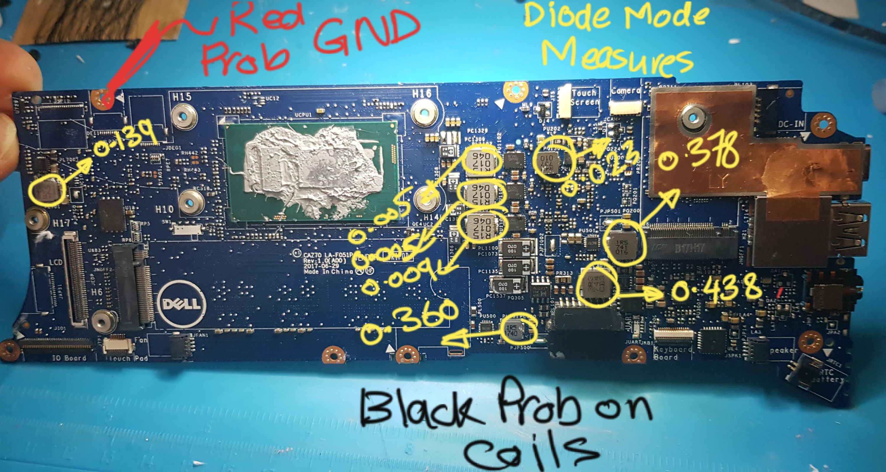

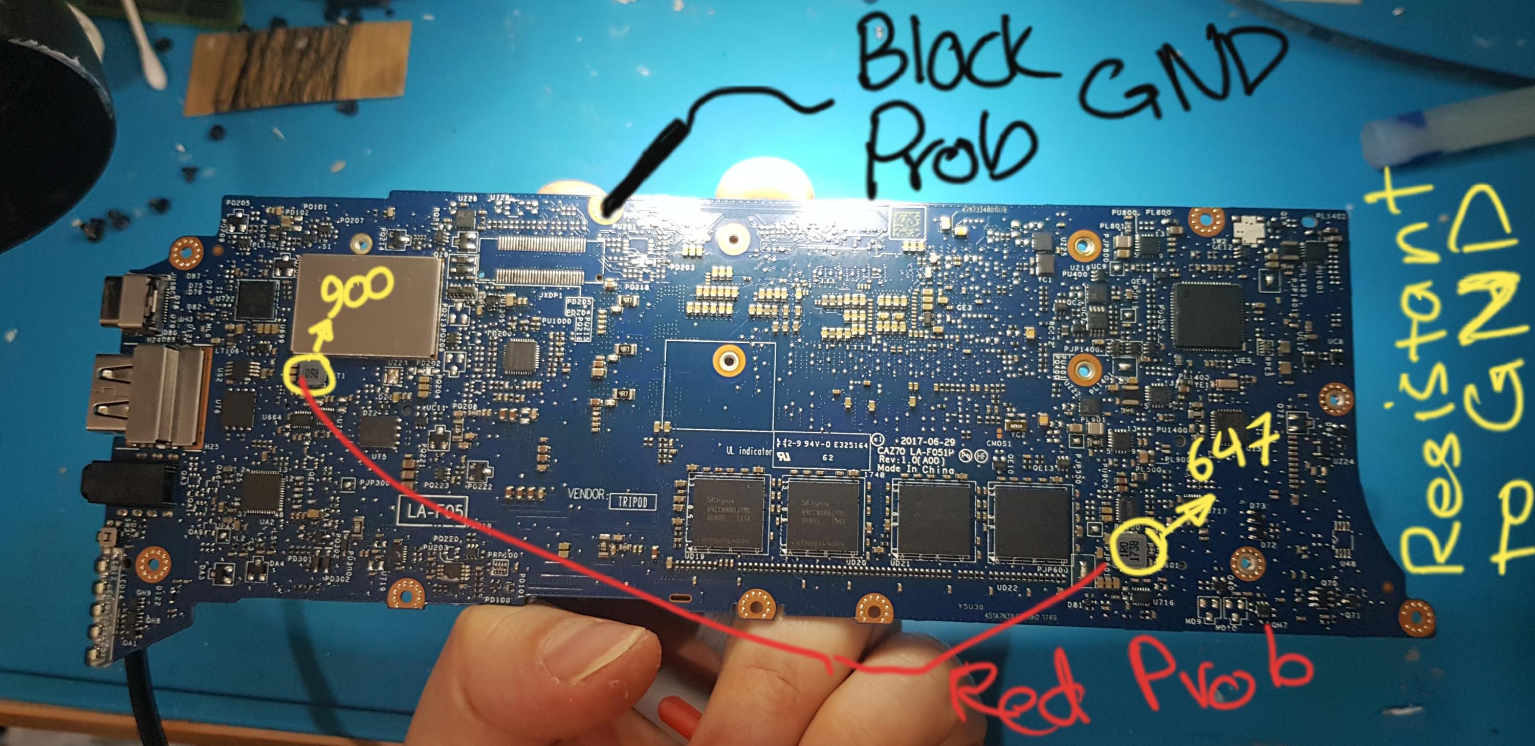

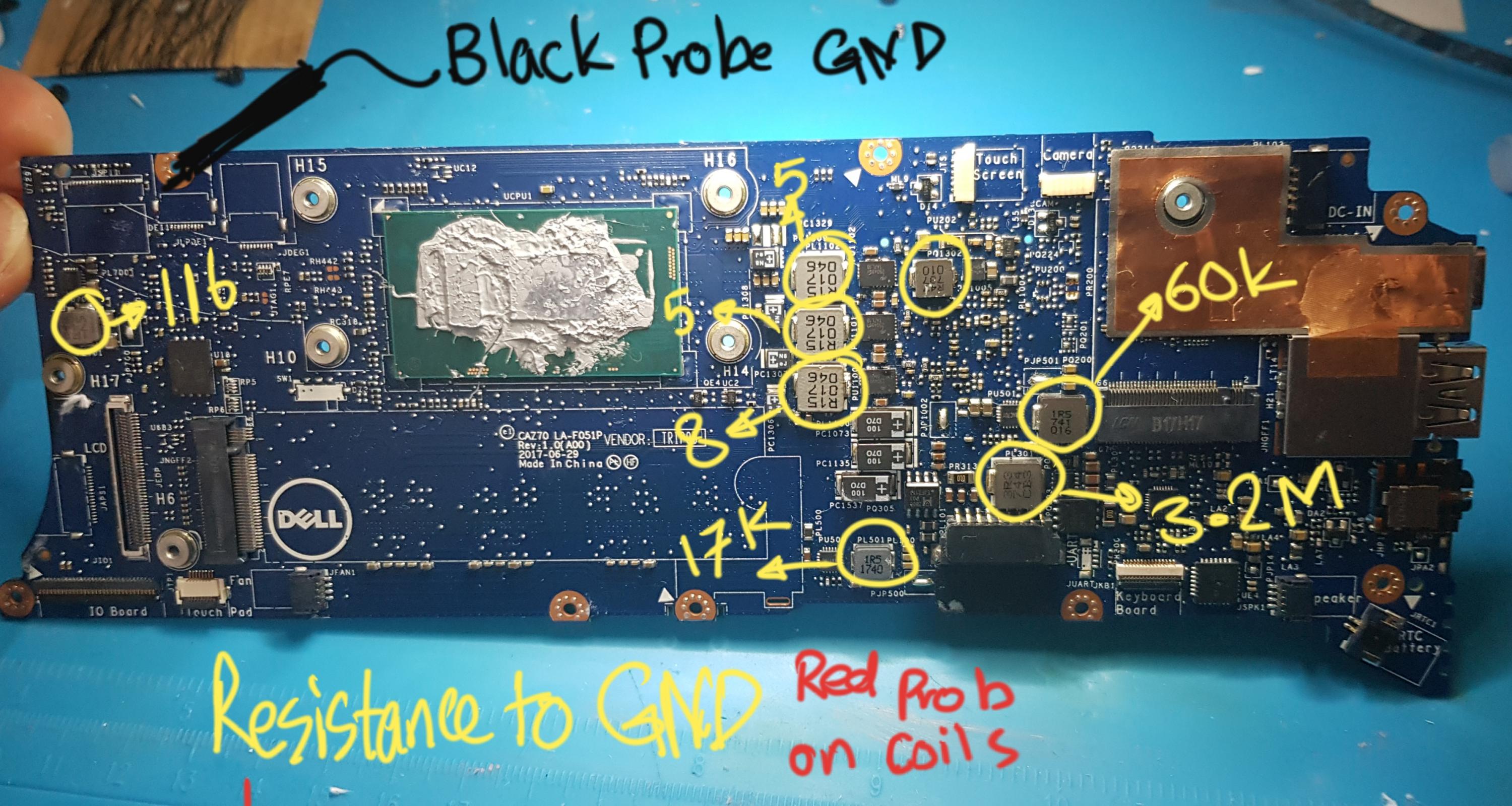

      Thanks for the reply.
      I could not find any overheating comp. Under the thermal camera.
      But these are the resistance readings as requested (black prob on gnd)
      and the diode mode measures . (Reb prob on gnd)
