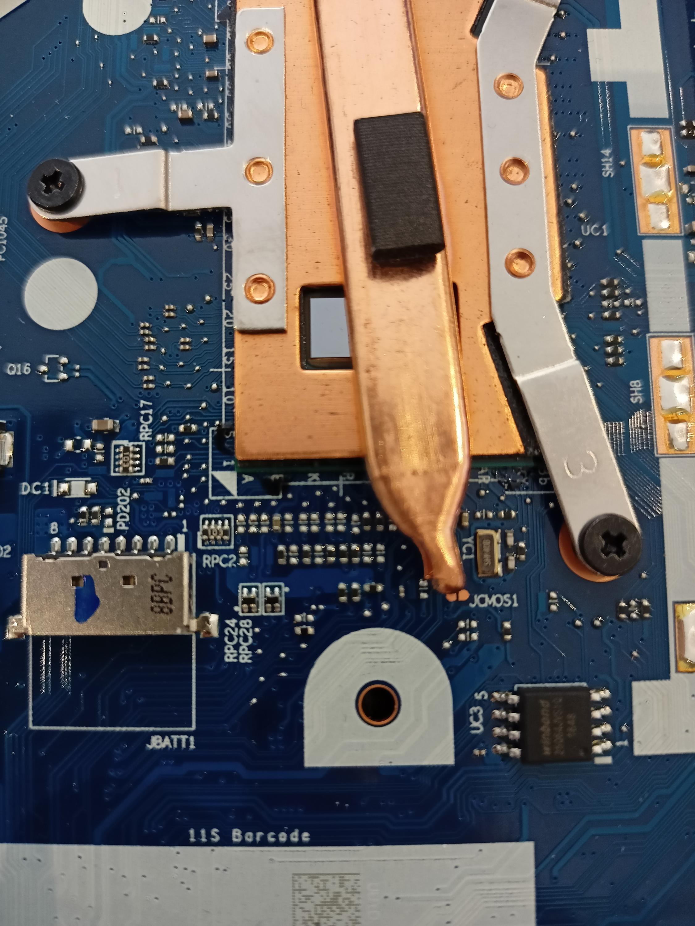

    I have a Lenovo Ideapad 330. The onboard ram has failed on memory test.
    Any help how to disable this and works only from the slot ram?
    Board is DG52A NMB244

          I've linked the boardview in schematic section. You can use NM-B241 schematic which is practically same as your mb. The ram config is given on Pg 8 of NM-B241 schematic. If you can understand do it yourself, else you need to specify the onboard ram detail -samsung,micron or hynix??

              Re: Lenovo Ideapad 330 Onboard Memory Fail
              For onboard samsung memory shift RC1634 to RC1631 & Shift RC1635 to RC1632. The value of the resistor is same at 10K. So just needs shifting.
                  Maybe i will need boardview to locate where are they, because i cant find them onboard... Is that possible?
                    This is what i see near processor
                      Read post#5. I've already linked the boardview file in schematic section .
                        ok. i have done these steps. I have black screen. should i remove the old memories?
                          You can remove the onboard memory.
                              @memoslar, seems like wrong diagnosis from the very beginning. If onboard ram was the issue, this would have been resolved. Your problem lies elsewhere. You have schematic+boardview. Check deeper.
                                Thank you for your answer my friend. I tested with memtest without the external ram and showed errors. Also the laptop was freezing at random times. It was for sure the internal memory.
                                Something happened from reflow on memories....????
                                  Download bios update from lenovo site for your model and make a fresh bios out of it and flash it. If you dont know how to do that, ask for bios in bios section.
                                    Ok it worked! thanks!!
