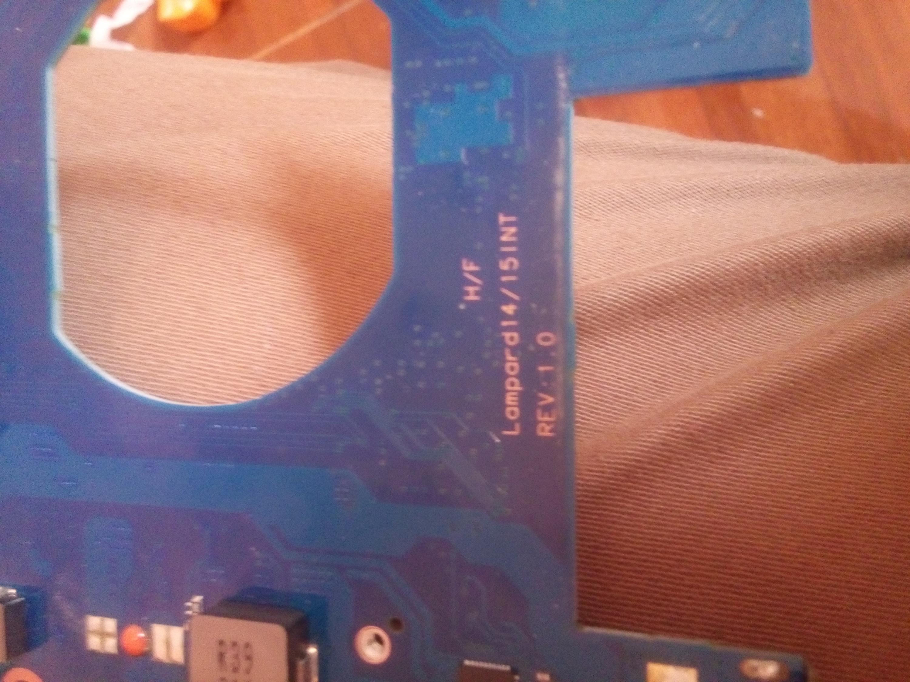

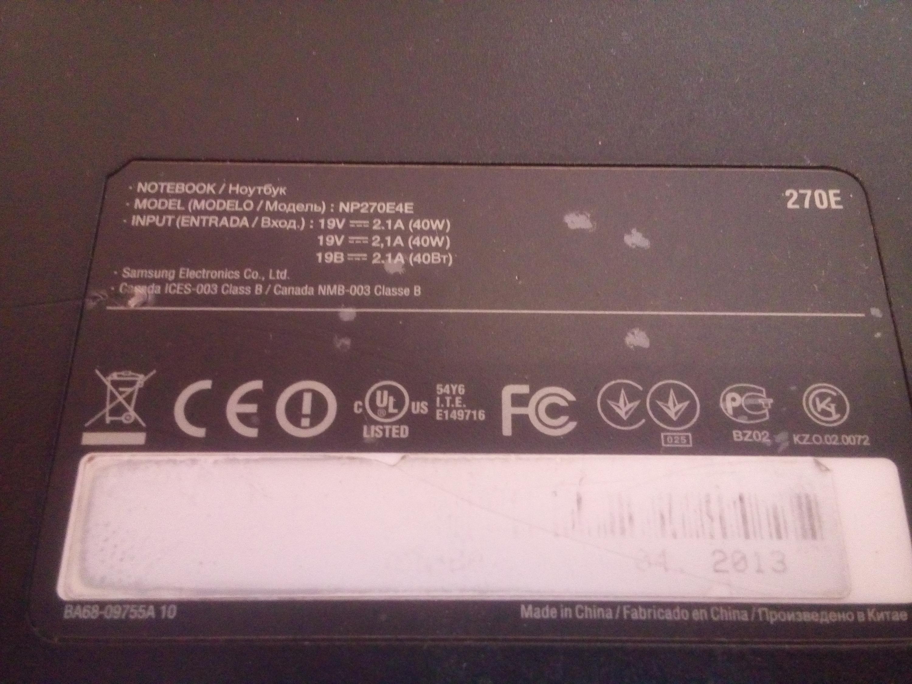

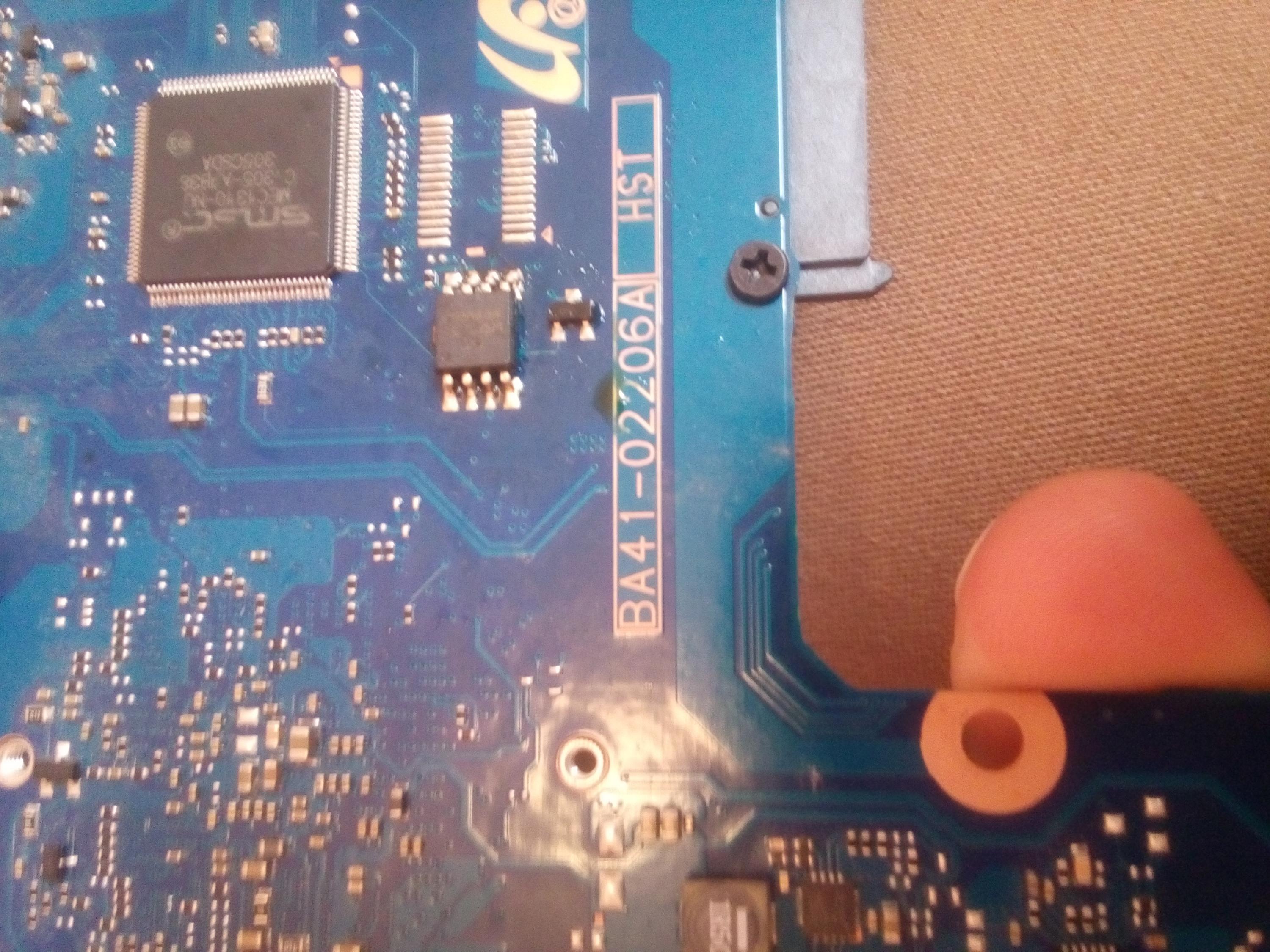

              Sorry I was in mistake..
              It's intel platform, E79453 cpu code (Celeron 847), I was confunded because it has a amd sticker.
              Model: only says NP270E4E, tags with model is borred.
              I attach some pics, thank you for your help
