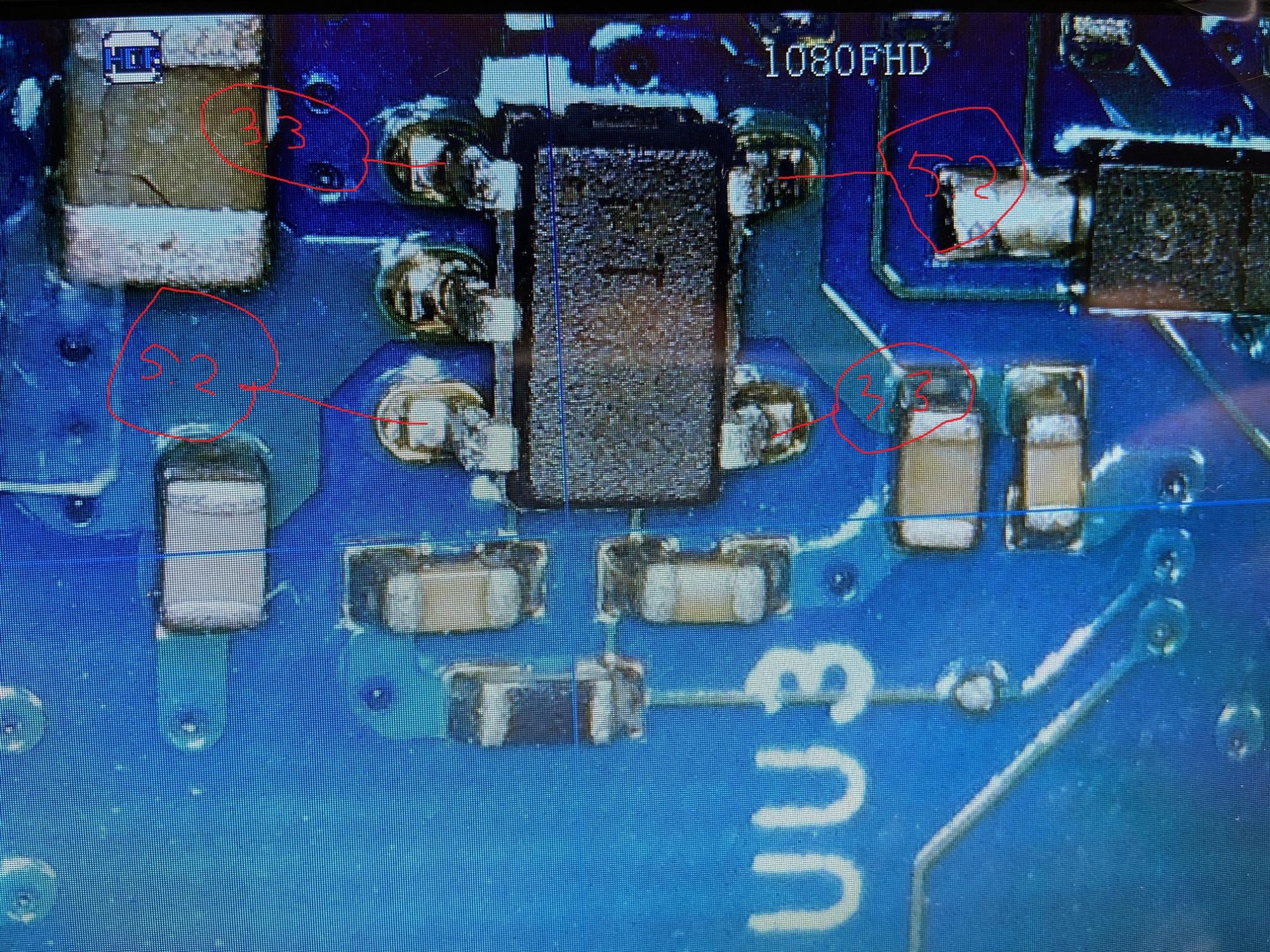

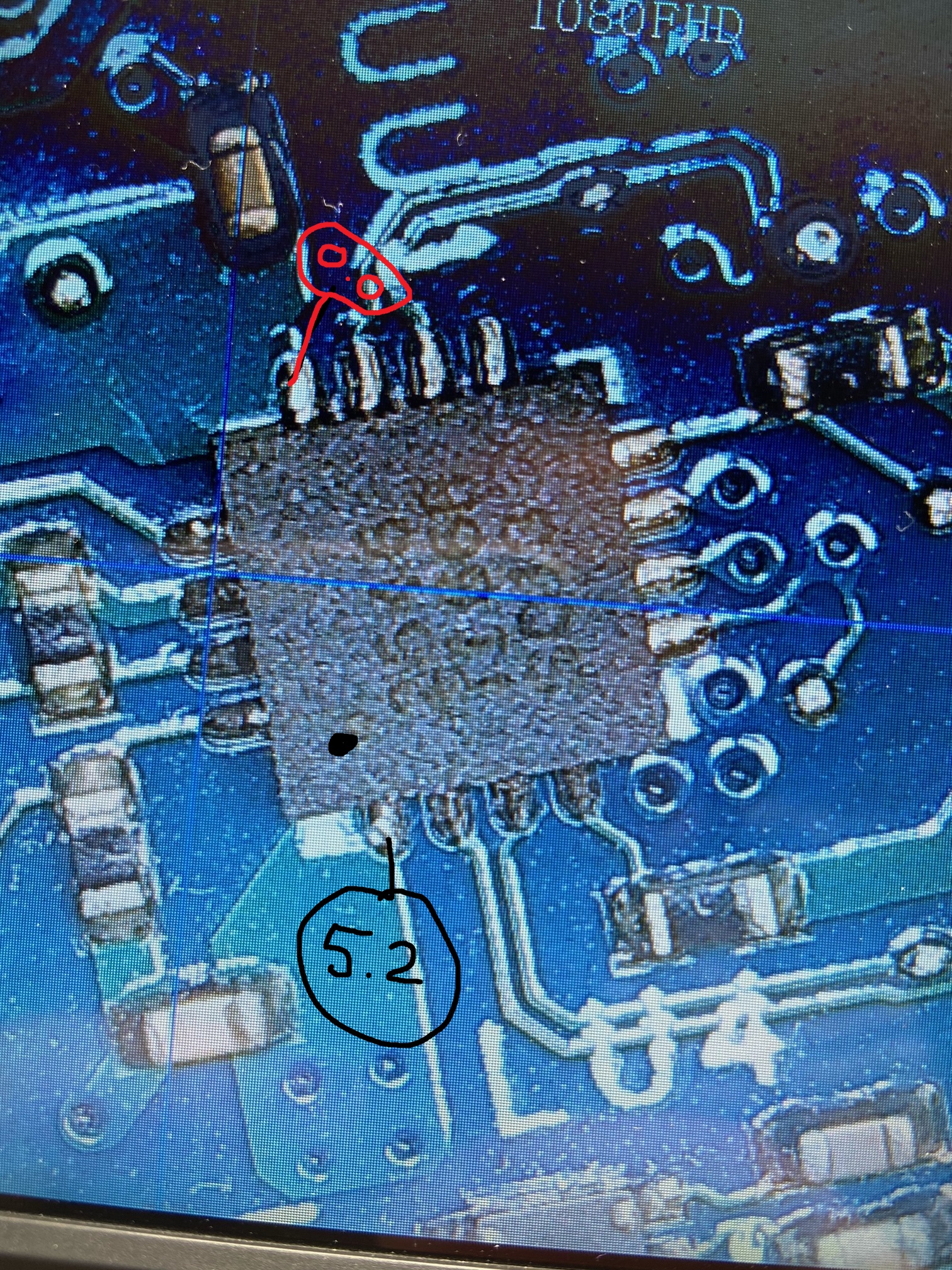

        Originally posted by SMDFlea
        thank u so much for your respond SMDFlea, im gonne check this first thing in the morning !
        Any tips how to exactly measure it ?
        i shoud measure pin 1 and 12 for voltage?
        Greetings Daniel
          • 20643
          Re: alienware 15 r3 (La-D751p)
          Yes check voltage on 1 and 12,also check voltage on UU3 pins 1,3,4,5
          • Pfudaniel
            • Feb 2021
            • 91
            • Netherlands

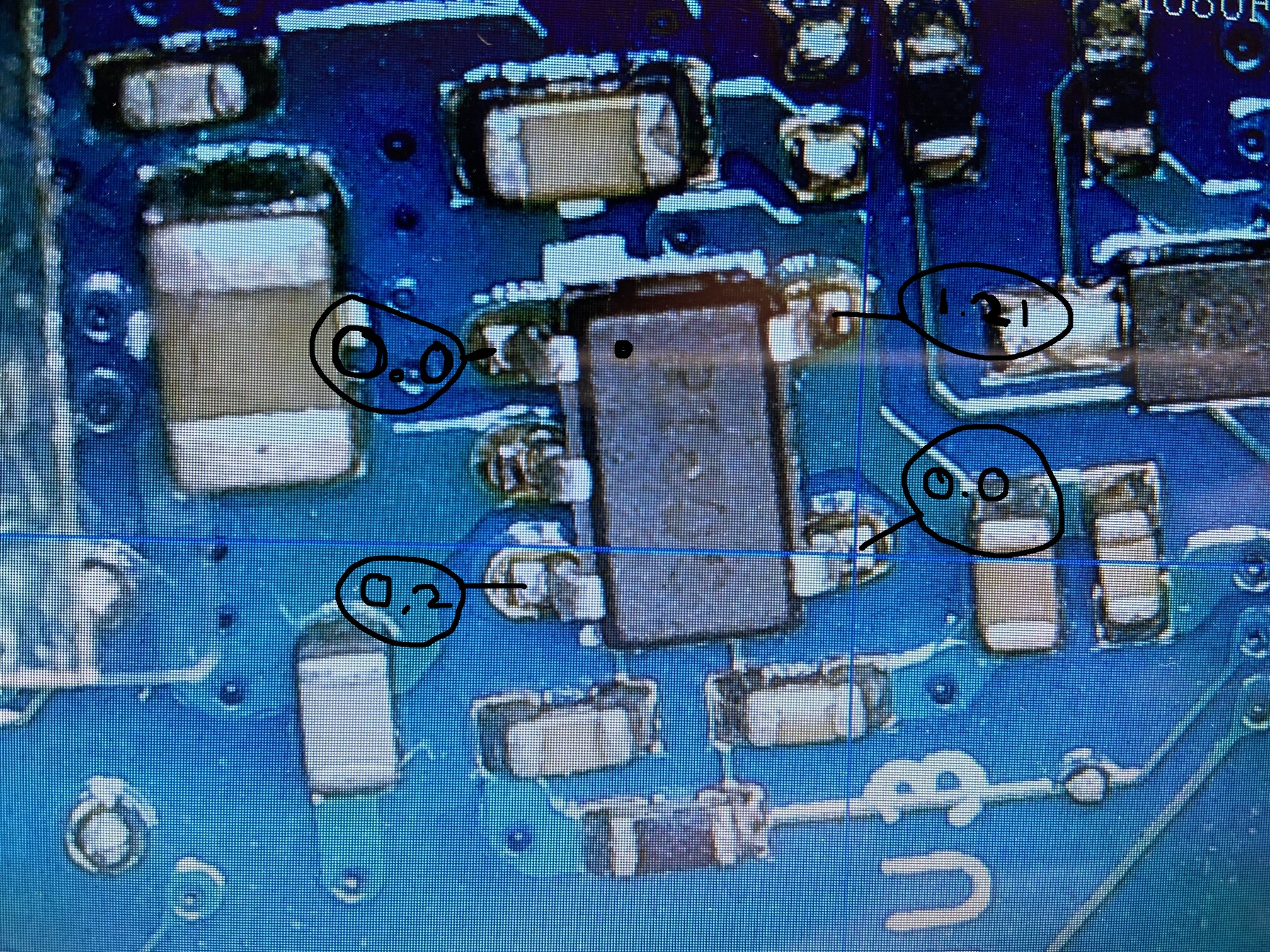

            Alright done that, added pictures with measurement
            Thanks for taking ur time for me !
            measurements are done with just the charger plugged in.
              • 20643
              Take same measurements on UU3 with the board powered up. Also post your bios backup in the bios requests forum for fixing
                done!
                seems al voltage is there, il post bios fix in bios section now

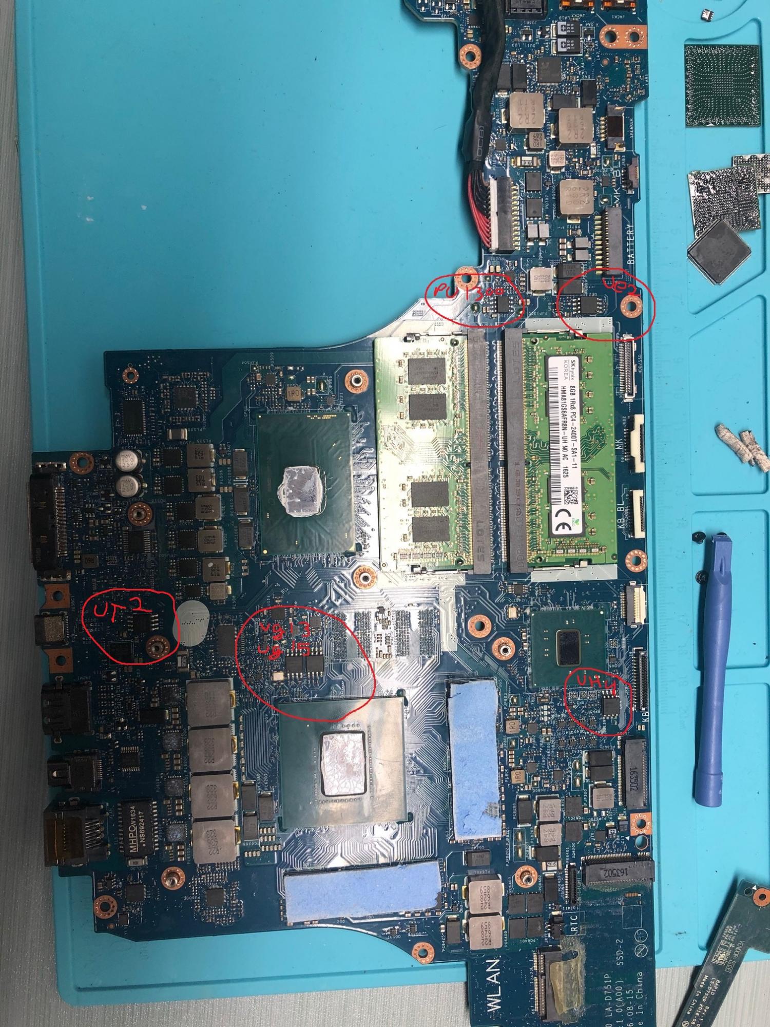

                  There is many bios chips on this board it seems. UE2, UT2, UH4. And 2 more next to the gpu, UG13, UG15 . Im not sure if PU1300 is also one. I believe i shud flash UH4 correct ?
                  foto with al bios chips:
                  i took backup of UH4
                  shud the EC also be updated ? im not sure wich chip is that.
                    • 20643
                    Originally posted by Pfudaniel
                    done!
                    Can you check those voltages again ,i think pin 3 should be 3.3V and pin 1 5V
                        Hi thanks al for respond, i've solved the problem by putting a new embedded controller (ec) on the board usb + lightning + shutdown works as it shud. again thanks !

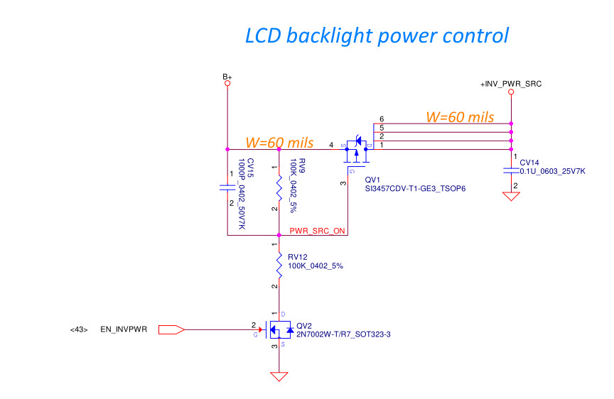

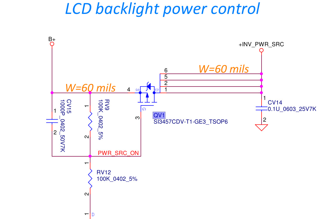

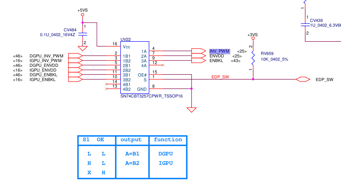

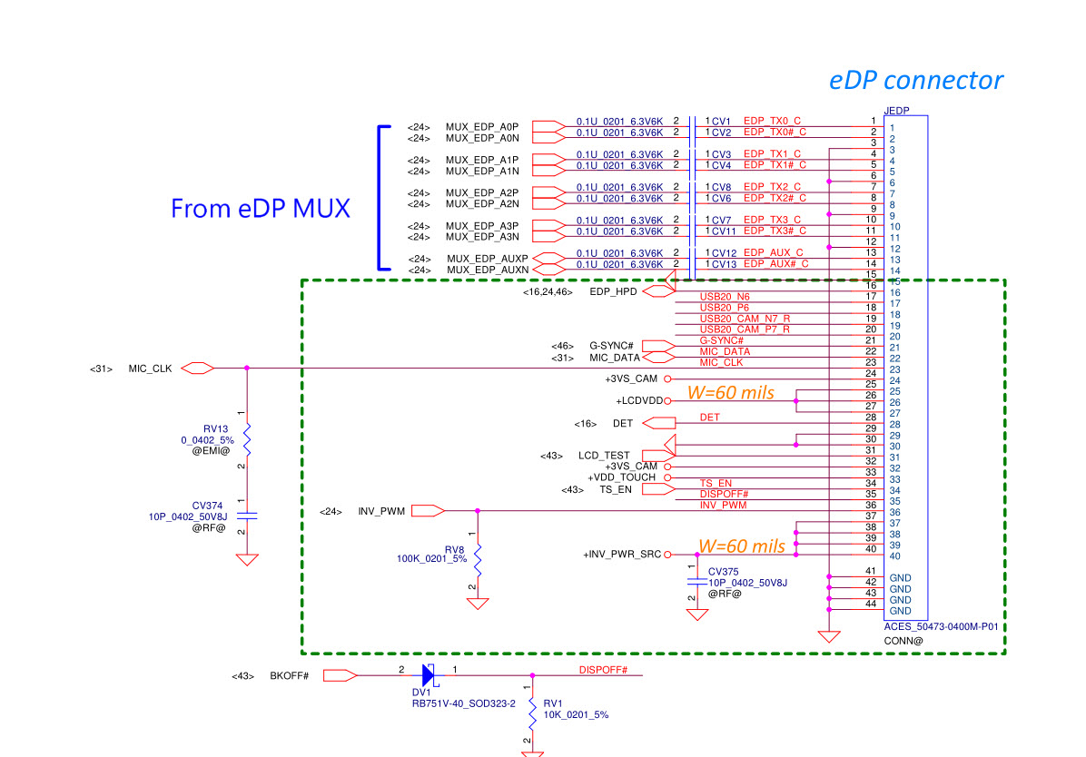

                          Hi Guys, I saw the forum here and I needed your help. My screen is dull (but it emits a very dark image). The part that controls the LCD Blacklight burned out. Could you send a photo or the name of the component. pls <3
                          • mon2
                            • Dec 2019
                            • 13992
                            How did it burn out ? Do you have a picture of the damaged part ?
                            Any silk screen (white text) markings on the circuit board ?
                            Post any pics of the backlight part that may be damaged.
                            • Cuzaov
                              • Jan 2022
                              • 5
                              • Brazil
                              i don't know how to attach the image but i tried
                              • Cuzaov
                                • Jan 2022
                                • 5
                                • Brazil
                                here

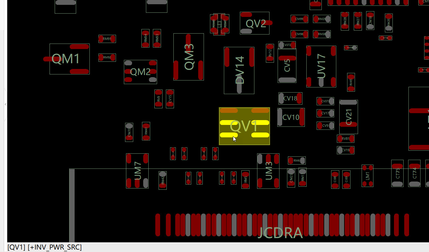

                                • mon2
                                  • Dec 2019
                                  • 13992
                                  See attached. Part is QV1 on the logic board.
                                  This is a mosfet.
                                  Part # SI3457CDV-T1-GE3
                                  https://www.mouser.ca/ProductDetail/...content=Vishay
