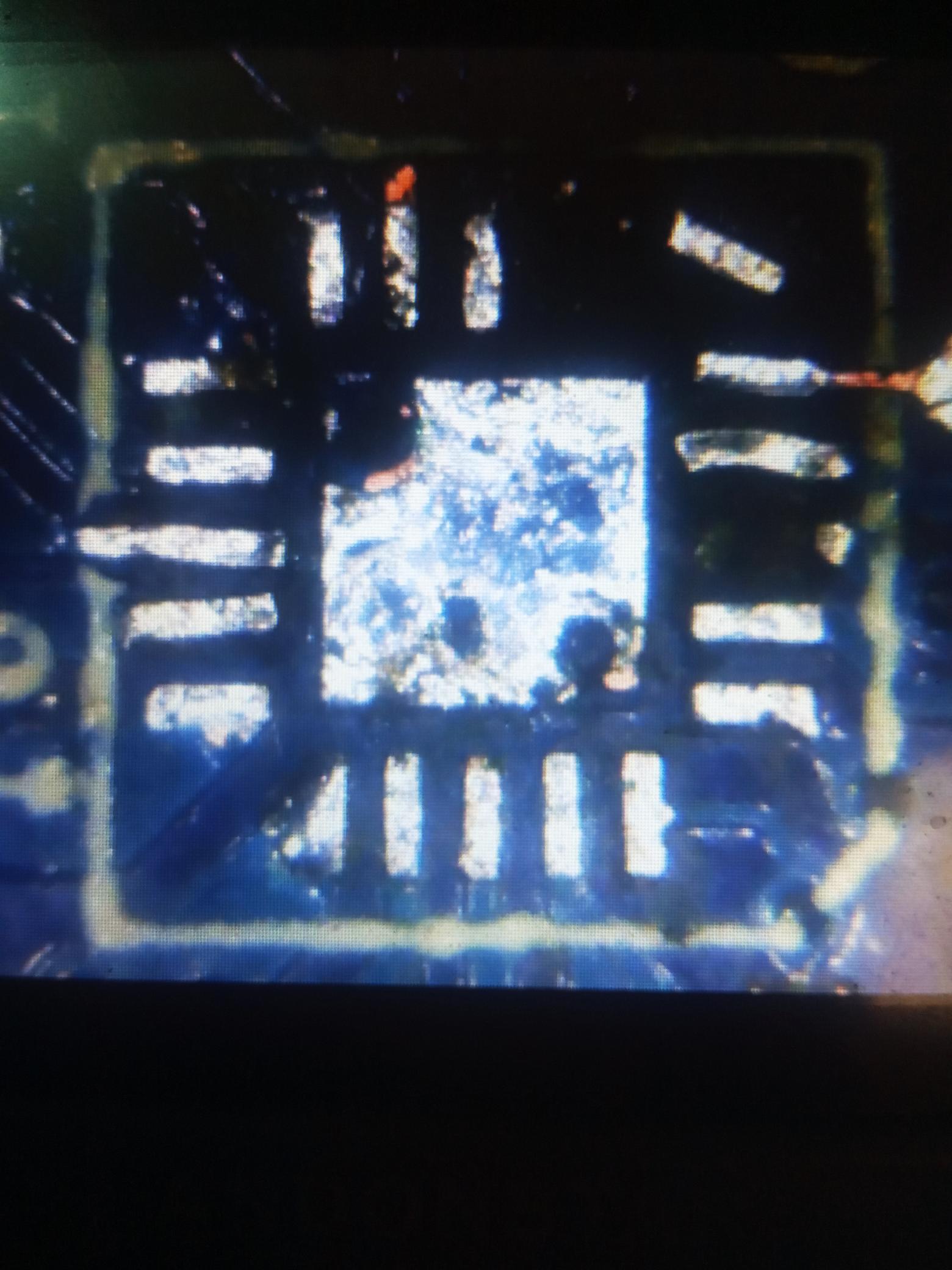

            The 1225C reg was near impossible to desolder. Like it had fused itself with the motherboard. Three pads missing. It´s finished.

              Re: Toshiba C50D-A133 - one problem after another
              It's possible to recover those pads or jump the IC with some patience and skills (and a microscope, OFC)
              What temperature do you use on the rework station? Are you using good flux? Some PCB may require lower temperatures and using good flux is mandatory to avoid such "accidents".
                I got two microscopes, one "Andonstar" type with built-in display and a "dental" stereoscope. Cheap, but they get the job done.
                In addition to the missing pads the vias to ground look busted.

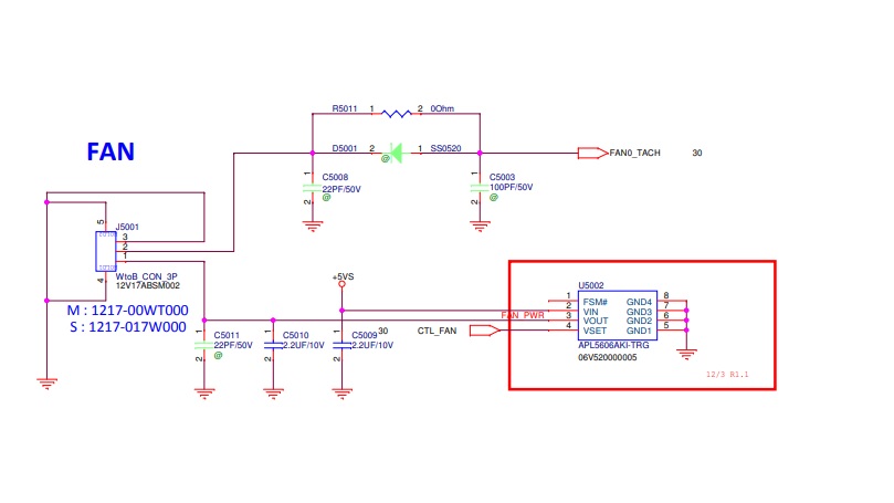

                  Do you have any idea on what could have caused the fan issue?
                    2-pin rev counter of j5001 fan socket. ITE this will be a check-up. U5002 chip fan control. Pin 4 is the control PIN.
                      Thank you.
                      The Vin was there. The fan would spin a quarter turn and stop. Maybe the EC was sending an "are you there" signal and wasn't getting feedback from the Voltage return pin 3.
